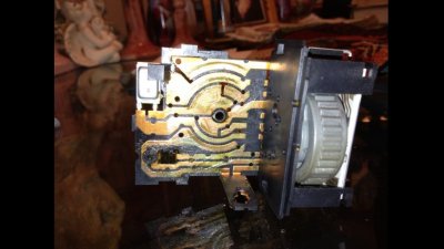

DRL does work. Once I turn the switch all the way up my lights go out I have no lowbeam or Hignbeams, I do how ever have all my marker lights.
I even took the switch apart to make sure it's working as you'll see in the pix I'm attaching

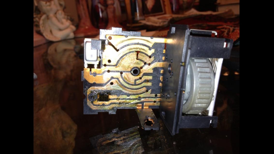

I also swapped out the repay with one I know works, I went as far as to find the DRL box u knw the one under the dash that has the mettle fins on it. That was fun finding btw smh

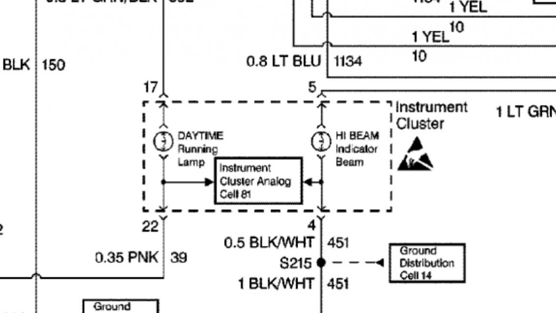

hter is a ****-fuse under the hood. about 50 amp and according to the label underneath the lid it should read "lighting". check for good fuse and no damage to contacts. if all is good check for volts on the biggest red wire on head light switch harness. if good then plug back in and turn on and off heads. see if you hear a clicking noise from that drl relay again. if so follow the wiring from the drl relay to the multiswitch and go from there using the diagrams below.

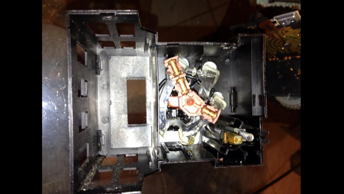

This truck was sitting for a long time by the looks of the interior not to mention the dry rotted tires. Someone went into the cluster and tried to put the miles back by hand lol but I knew that the day I bought it I didn't care. Point is this I do notice at night the lights on the cluster go in and out, the top of the dash is all cracked up from someone beating on it. If u just bump the streering wheel a bit hard it all goes back to normal. I want to guess there's a bad ground somewhere and this attachment is what I'm thinking it could be. Thx btw for the diagrams that's really going to help. But in the end I KNOW it's going a be something so minor and stupid like it always is smh
