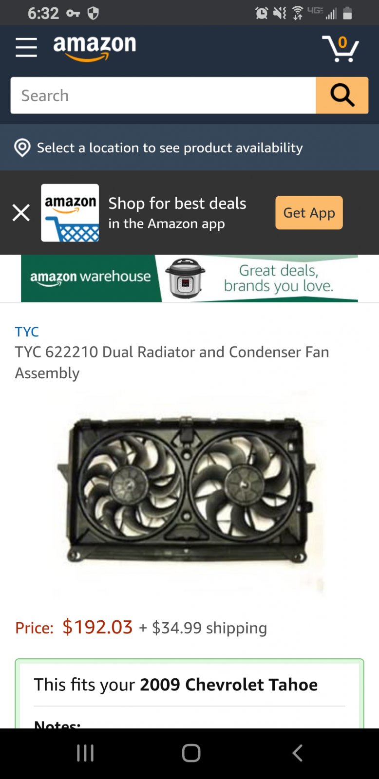

I just received my new fan assembly: TYC 622210 from amazon.. Supposed to be the 7/9 blade set up.. As mine were replaced by PO
with a 7/7 blade aftermarket fan. I DO have the HD cooling/towing. So I really wanted to make sure I had the 7/9 Blade Assembly.
Well, the fan that showed up in the TYC box is a 7/7 set up.. So same as I already have.
Has anyone found a replacement true 7/9 set up ???? I'd really like to have max cooling as supposed to, esp with my mods and towing

Well Crap, I must have a mis boxxed one or something.. Maybe a returned
item that someone put a 7/7 blade in.. I'll return it (if they pay shipping) and
re order from either amazon or RA .. Hopefully I'll get the correct 7/9

It's really weird. In that ebay listing it shows under the apps that
the 7/9 blade is "without enhanced cooling" option for some Yukons and Eskys,
including my 2014
I'm waiting on TYC to contact me back with info regarding Fan 622210 as
to if it's supposed to be a 7/7 blade or a 7/9 blade.. I ordered it from amazon
and what I got is a 7/7 blade.. I don't know how to check to see if it has
the 700 or 500 watt motors
All their pics, etc show it's a 7/9 blade
So still waiting .....

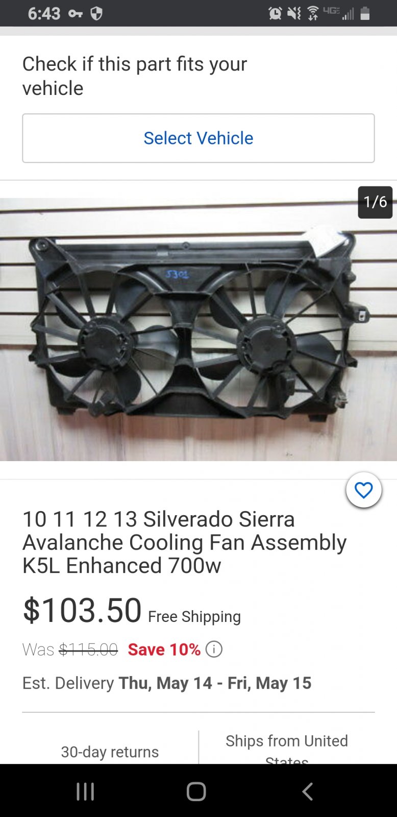

I think they have it listed wrong, at any rate here is one for $72 free ship and they show the vehicle it came out of and the rpo code k5l is present
7/9 blade 700w https://www.ebay.com/itm/2007-2014-...Hummer&hash=item365bb8ef7e:g:3p4AAOSwDudeIJZP

I bought a used one like I linked last and then bought new oem 700w motors for it from rockauto just to be on the safe side, still a bargain, the shroud alone new from the dealer is like $400 with no motors or fans, read about too many failures on the aftermarket fans seems that some start to fail after about a year when the warranty period expires, there are some name brand fans out there that get better reviews but they are pricey like the universal fan kits, it gets hot here in California and I tend to drive like a doberman is about to chew my ass so oem it is.

Well, to update:
I got word back from tyc that my fan is supposed to be a 7/9 blade.. The first email I got said to ship it to them for
inspection.. I agreed to that.. then they responded to just return it to where you bought it from.
Ok , so this sucks. even the sticker w date/serial/ part # is all correct ... but for some reason mine
is f'ing so special that it is 7/7 blade..
So I'll ship it back and reorder another one and "hope" it is built correctly... What a PITA
I'm disappointed with TYC for sure
