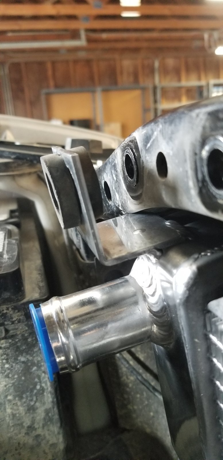

I got the Cold case all aluminum radiator in today and installed it. The stock radiator is only a single tube and the single tube is much narrower than each of the rows in the cold case. The two tubes in the Cold case are equal to three standard tubes. With each tube being 1.25 inches wide.
This Cold Case GMT570A is a very nice looking unit it cost $406 shipped to my house. It has a nice polished tank and the overall workmanship looks good the TIG welds look a lot better than I can do...
It comes with new transmission cooler fittings. You will reuse the original rubber mounting pieces on the top and bottom. All the stock hoses and connections are there and in the right place.
I did run into a fitment issue like Dave mentioned above the top upper bracket came in slight contact with the upper radiator support. It wasn't a real hard contact but, since this will see a lot of off road use I wanted to give it a little more wiggle room so I took a few minutes to cut some extra clearance. It may be possible my stock rubber pieces were old and very hard so they didn't allow the radiator to sit lower.
The stock lower fan housing normally fits into the area where the stock radiator does not have tubes so, the fan housing will have a gap between the radiator and the housing.
For now I just pushed the bottom in enough to hold the bottom of the housing in place and decided not to worry about the gap for now. In the future if it gives me any problems I might do some trimming to fit the housing in closer.
With the additional cooling the gap between fan housing and radiator should not matter. On my first short test drive it took a little longer to heat up and the running temperature was about 15 to 20 degrees less than normal.
