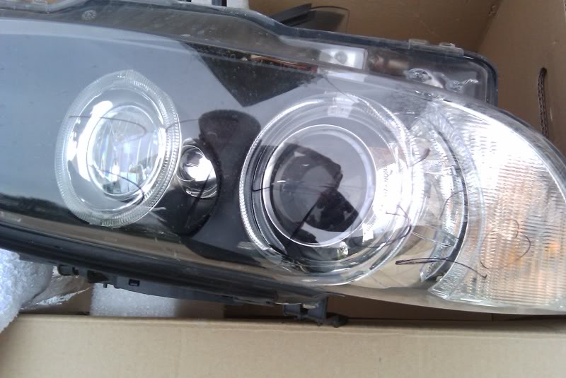

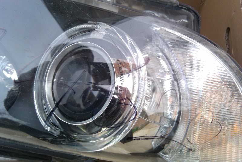

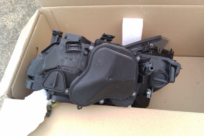

Would the zkw's say xenon on them I wonder?
---------- Post added at 06:25 PM ---------- Previous post was at 04:26 PM ----------
here are some pics of them.
DenaliAK
DenaliAK
Colder than you
Aug 1, 2009
2,178
11
Alaska
Hmm.
Well, they are HID for sure. Hard to say what exact projector, but they are probably Bosch. D1S bulbs. Sorry it took this long for me to look back at this thread. I'll look around a bit and see if I can find some sizes to see what you're working with. Let me know if you've already figured things out so I don't get redundant.
After looking around, I didn't find much out. Are they bi-xenon? D1S projectors are a little more difficult to retrofit, because the bulbs have attached ignitors and you can't swap D2S bulbs in. They may prove to be too bulky on the inside end to fit in your headlights.
