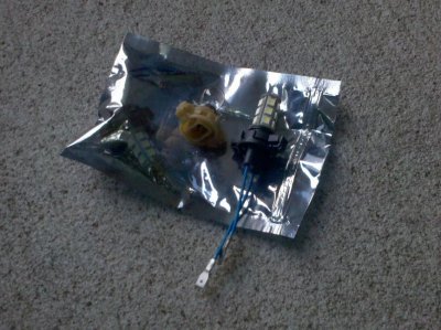

I did buy some LED fogs but am completely clueless as to how these would install in the stock wiring harness
You should be able to snip the OEM harness and put the female ends on the oem harness and plug it in.
Just pop out the factory bulb and insert the metal prongs from the new bulb into the socket. The HID's will be the same, you'll just have to mount the ballast somewhere.
---------- Post added at 12:53 PM ---------- Previous post was at 12:51 PM ----------
Why isn't a relay harness necessary for the HID fogs?
The fogs don't have any of the issues that can damage the low beam HID's... automatic start-up flicker, DRL use, etc.

So in the pic above remove the bulb from the gold socket?
I was looking the wiring harness after disconnecting the light above and saw no way those prongs would go anywhere.
