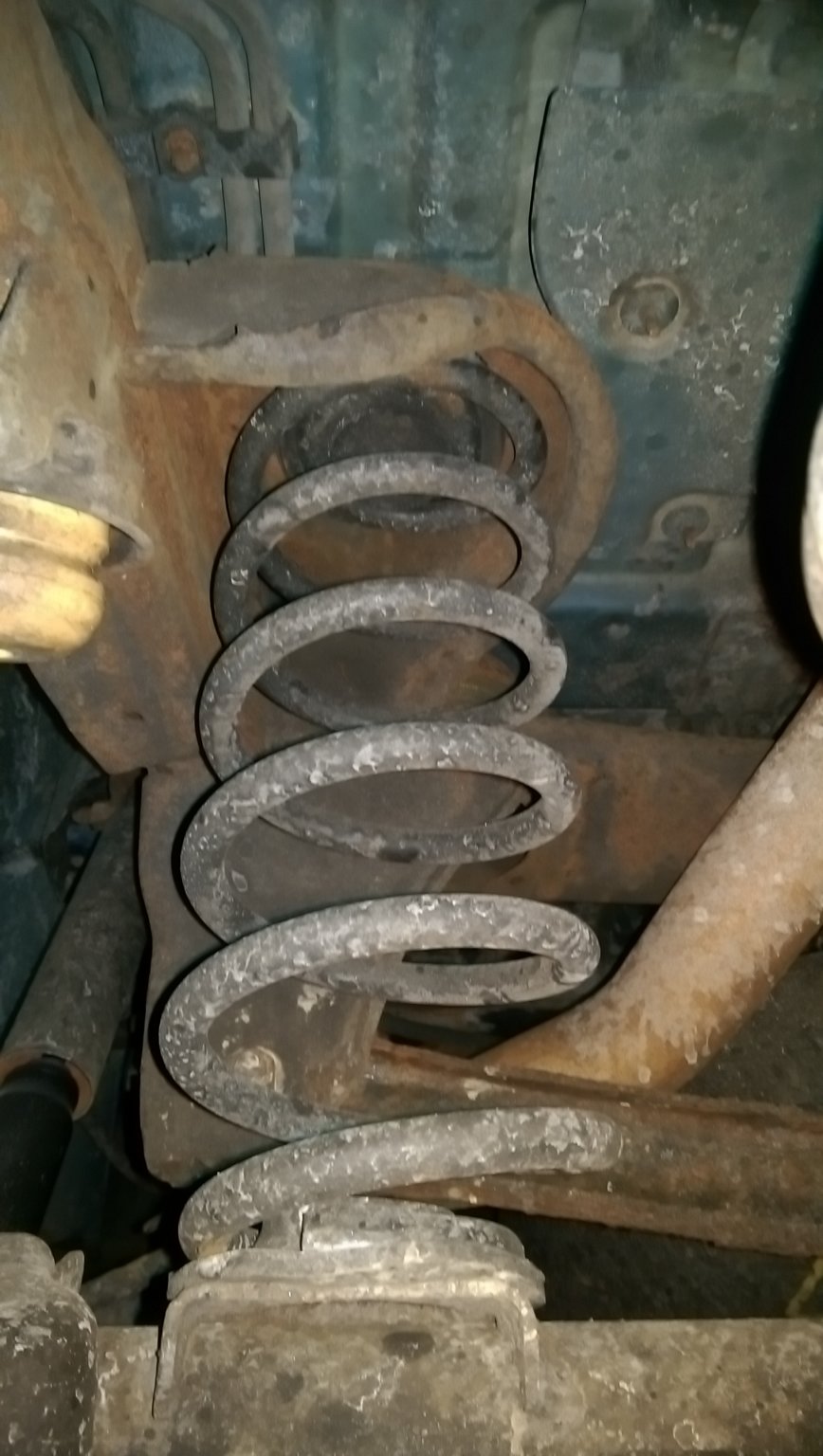

I found the jack stands everything fell apart easily. The underside was very clean and the keys were stock. I have a question though and it may seem stupid but here goes ... the blocks for the springs in the back do they go on top of the coil spring or the bottom? I am sitting here with the rear end of my truck taking apart as we speak ready to put them on the.

What blocks are those?

Fairly certain they go on top of the springs.
I found 30 videos on doing the keys. But only one for the rear. It was in fast foward so I couldn't see where he put them. I found one pic that had them below the spring so that's where they went. Not sure it really matters the more I think about it. Just extending the springs. I think I might order new Springs that will lift it. I feel like it would ride better.

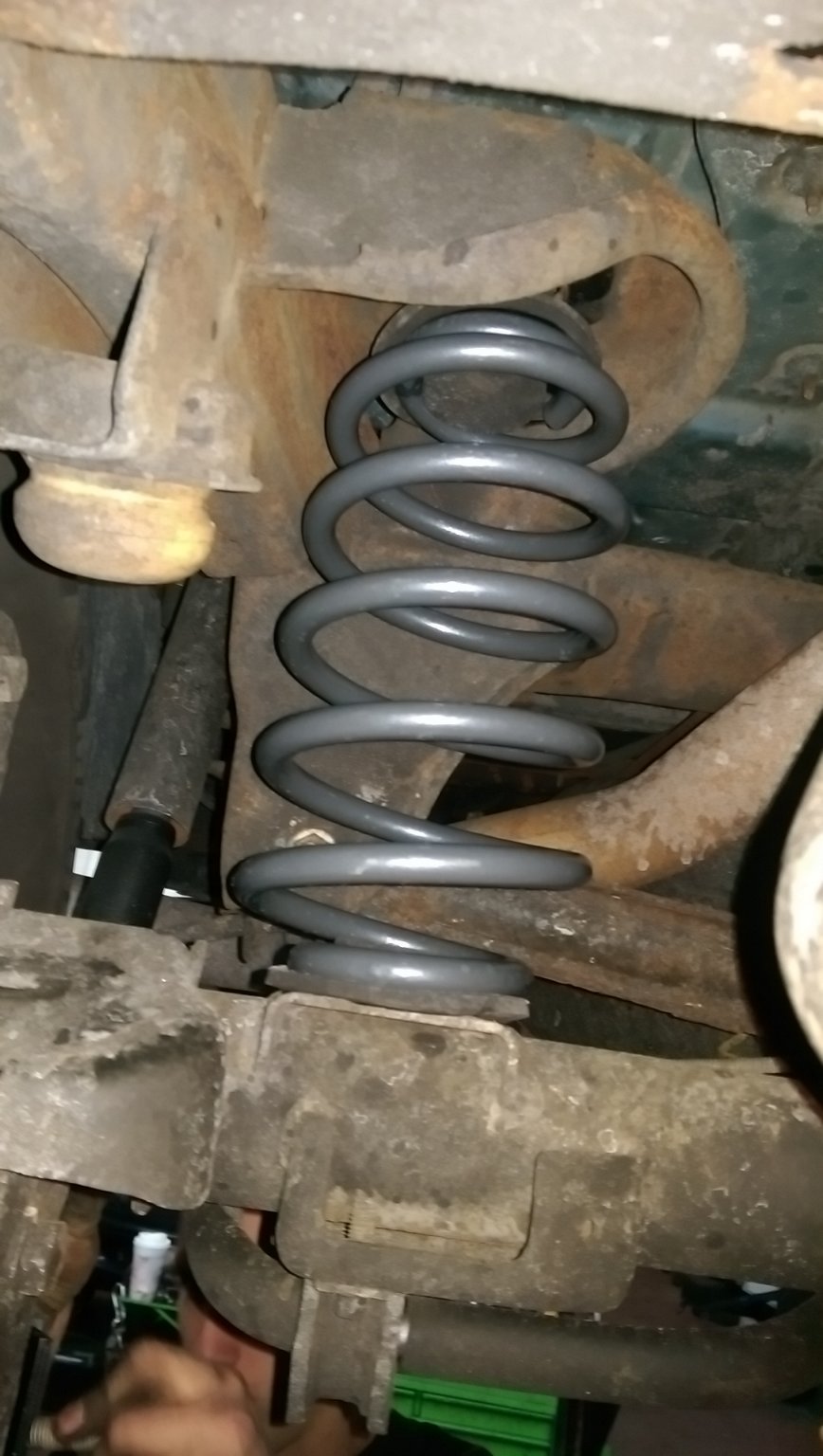

Ok so I found out I need new shocks for the rear. I'll get them tomorrow. Stock won't extend to fit the lift. Both front keys and rear spacers went on fairly easy. You will need rear shocks. Probably a good idea to replace all 4 while your in there. And rent or buy the torsion bar unloading tool. And use air tools if you have them. Made for quick work on those keys. I took my time and many breaks cuz I can lol. Over all time spent with tools in my hands has been around 2 hours. Now that I've done them I could do it in half the time next time. I'll post pics tomorrow. GTA is calling my name.

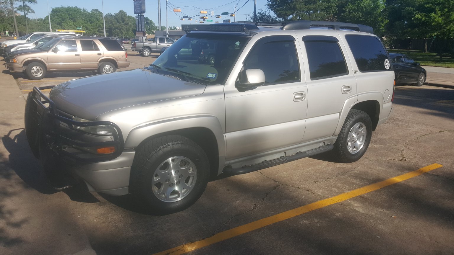

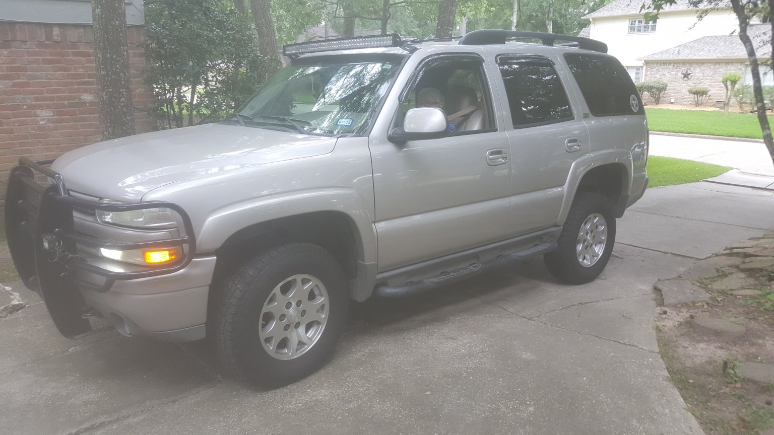

Looks good. IMO I think it would look better if you cranked the keys just a little more. Maybe another inch in the front
I plan on going higher in the front but that was all we could do for now and keep a decent reading for camber. Upper control arms and shocks should do the trick.
