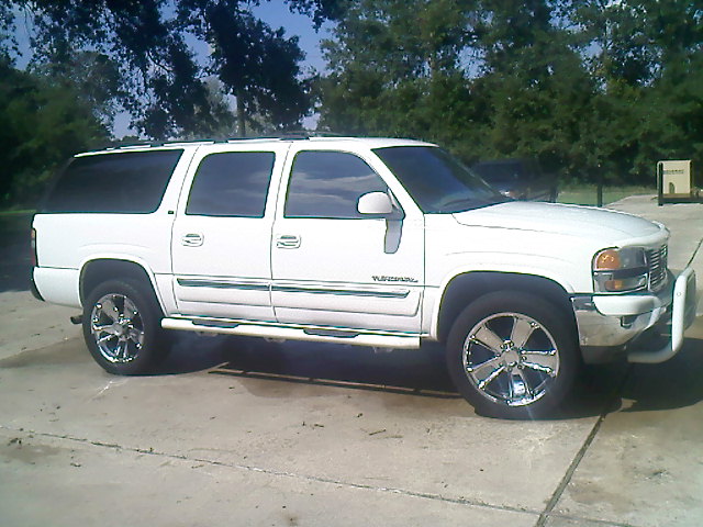

Here's a bigger pic of the vehicle. And its not 4 wd.

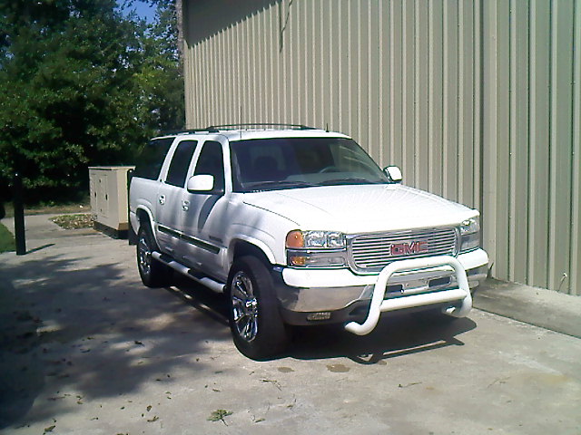

Another pic of the "big ***" bull bar.
