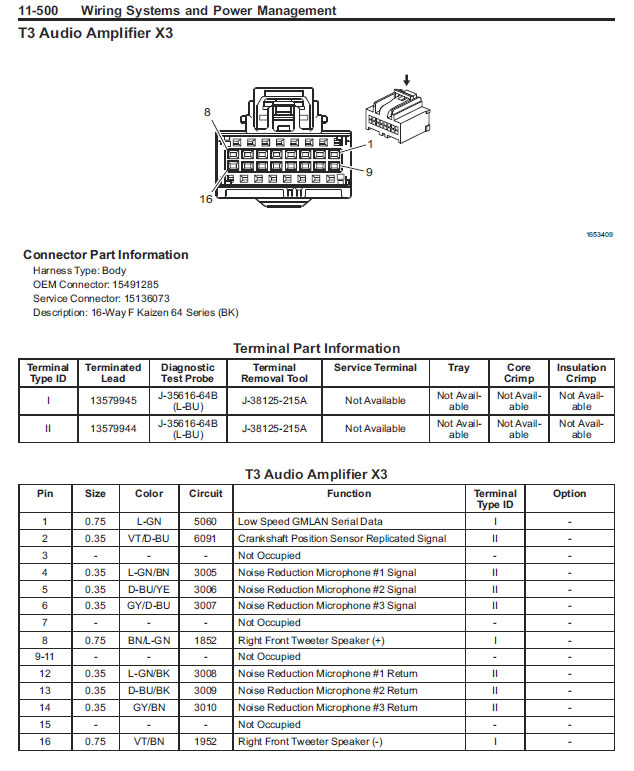

I meant cutting from the bose connector. It’s part of the ANC system. If you look at the schematic you will see all the mics and other things associated with the active noise cancellation. Anyhow I’m not cutting anything lol

Cutting that purple wire does the same thing. And basically the dealer did not disable ANC if that harness fixed it. Hope you didn't pay them anything or else I would be asking for my money back.

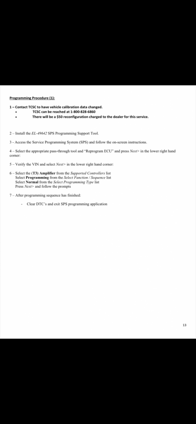

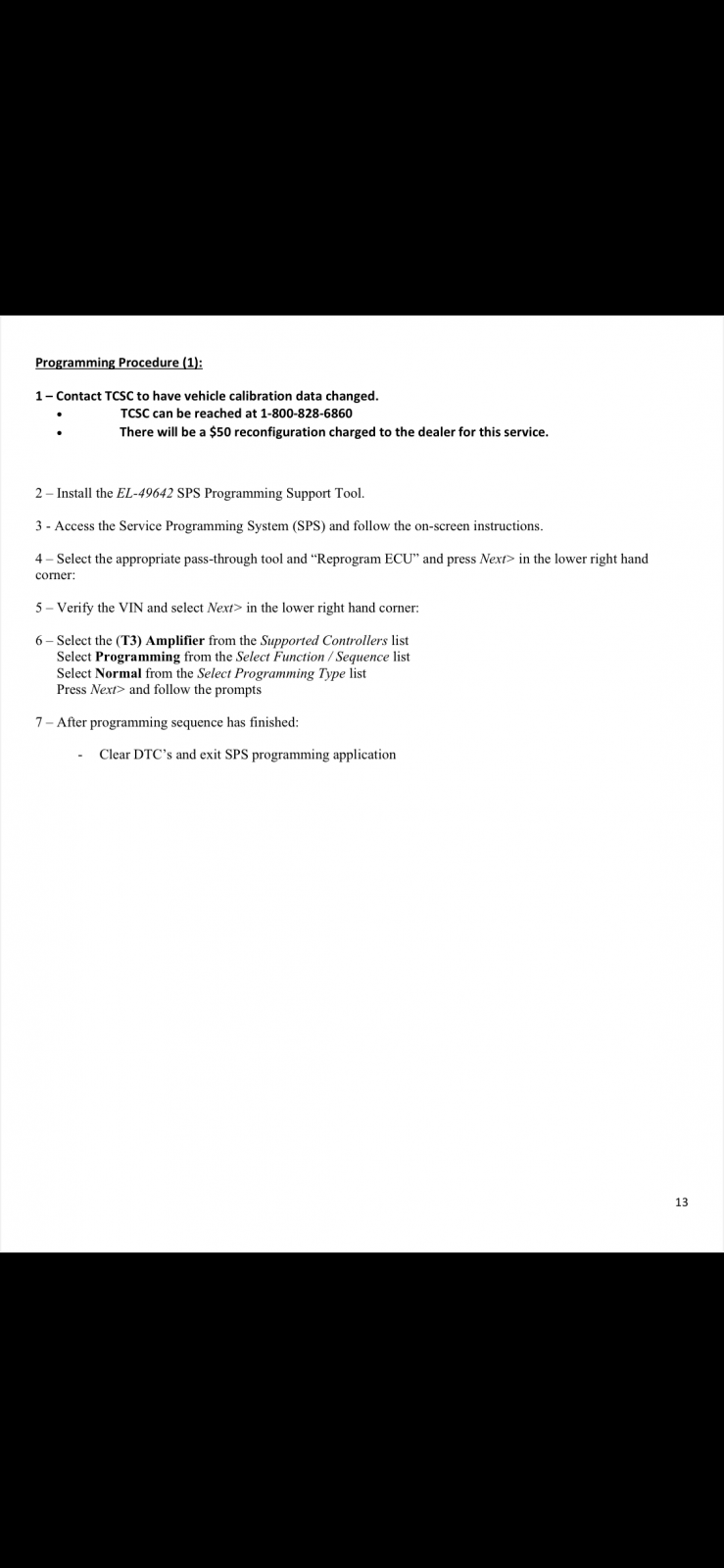

Yeah, I figured they didn’t do it correctly because they said they did. To actually disable the ANC, the dealer has to call TCSC to have the calibration changed. Then they have to install it using their scan tool. I’m sure something went wrong during the process. But they did install the subwoofer so no use in asking for a refund. Just going remind them the tech who did it didn’t do it right.
