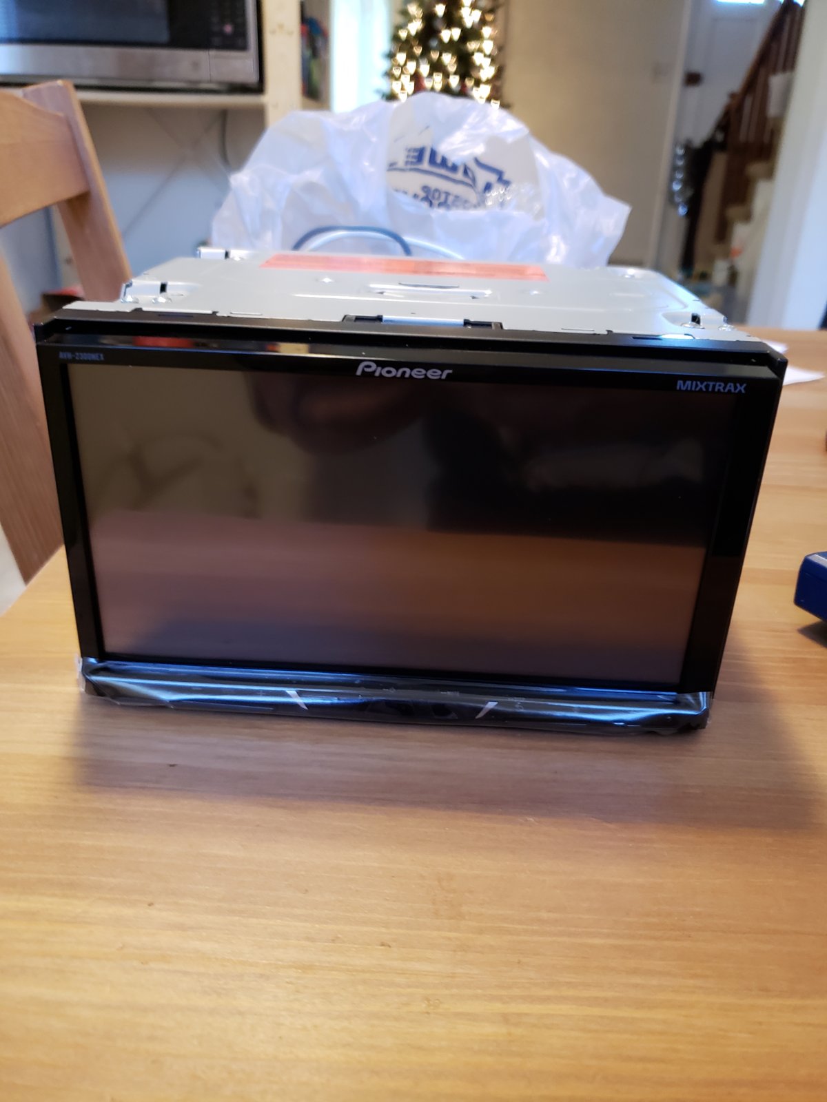

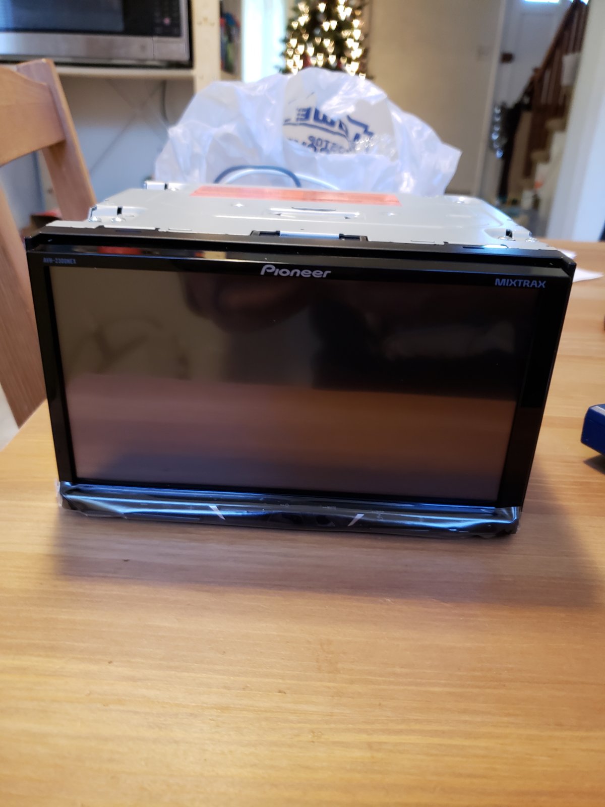

So my wife just got me a new pioneer avh2300 nex headunit.
I'm trying to figure out what harnesses I need to get to get it working. She got me a steering wheel control harness and module but I also have Bose and want to retain factory features. I dont use onstar and plan on one day shaving the antenna on the roof. But I want to get everything working asap.

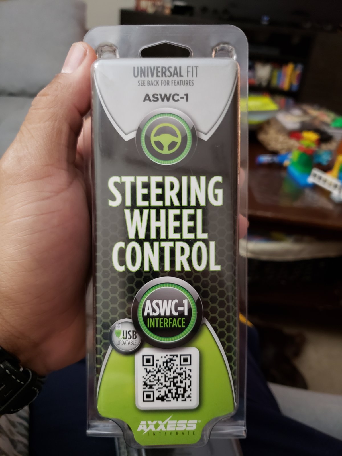

This is the steering wheel control module.

you can visit the axxess, pac or maestro website's and select your vehicle year/make/model and features and it will tell you what adapters you need, some adapters do not retain all of the Bose features such as front/rear fade or dsp. best to stick with all the same brand for best compatibility.

I went to axxess's website, however, I did not see anything that would retain Bose. Nor did it have pricing.
Also is 1 better than the other and is the steering wheel harness I have the correct one
And if I dont want to keep onstar do I have to or can I skip it?

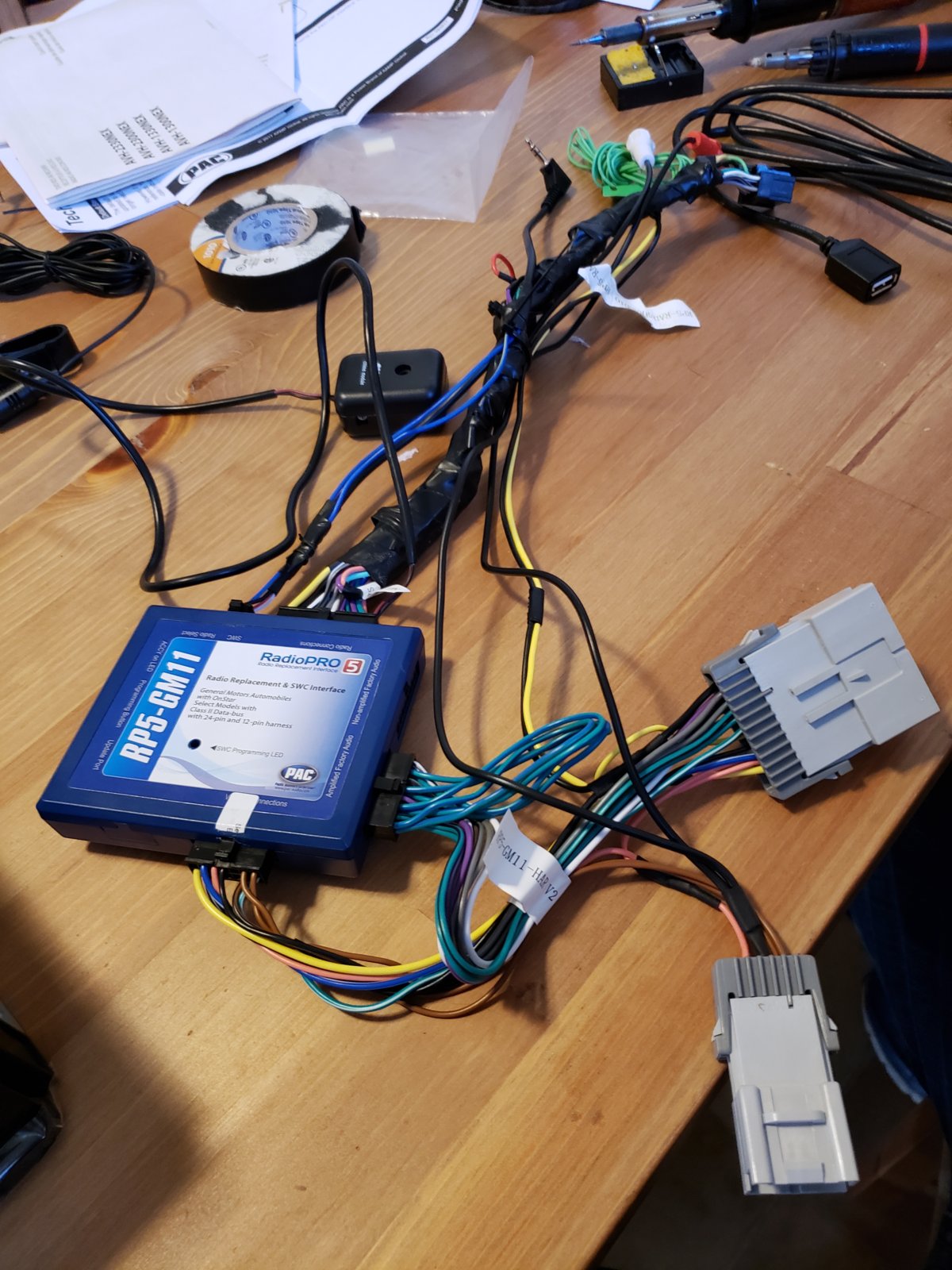

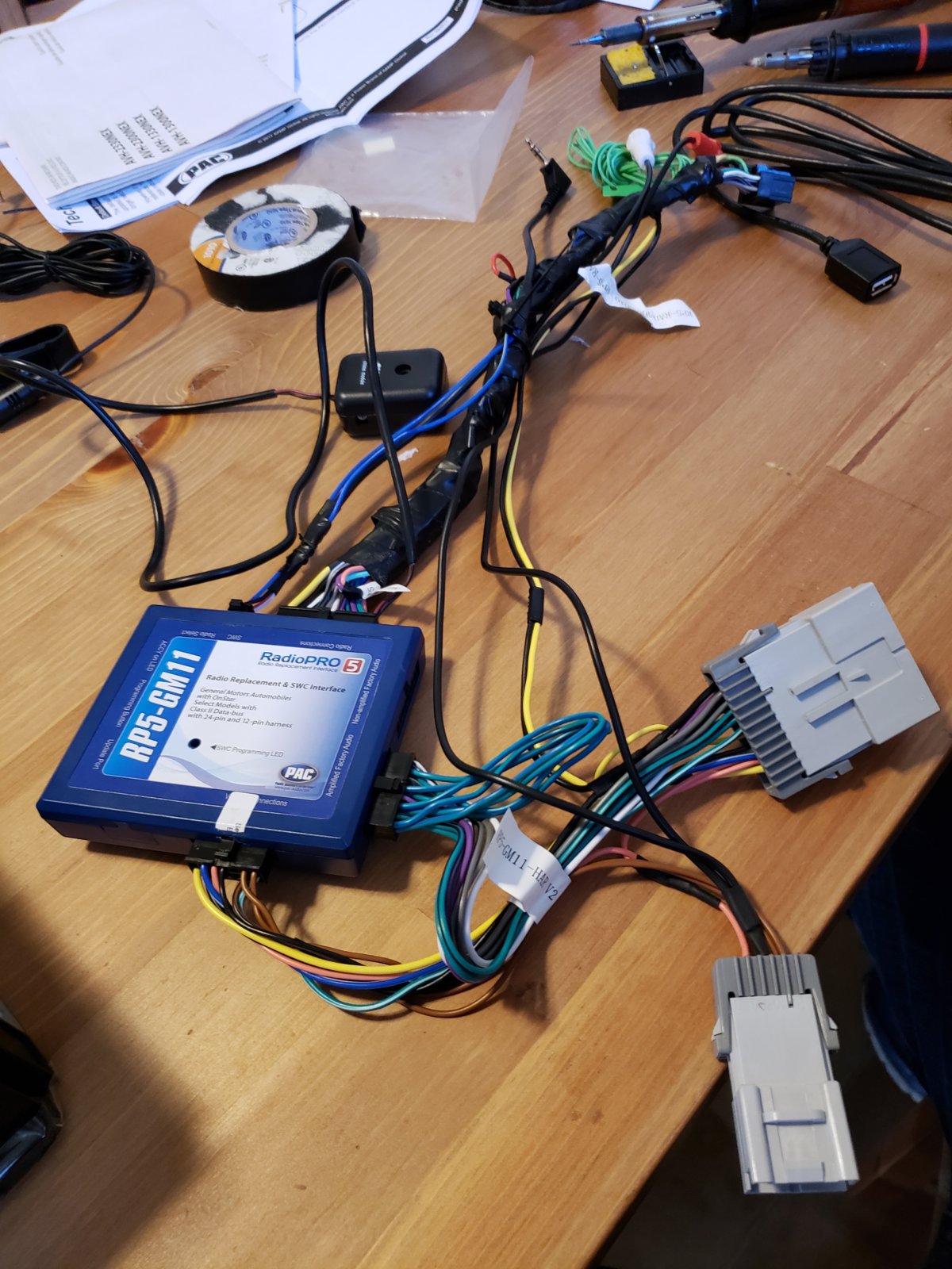

Ok final harness I went by best buy to get the above harness. The guy said that would work work but recommended that I use this one.
https://www.crutchfield.com/p_541RP...search=pac_rp5-gm11_wiring_interface&skipvs=T
He said it's easier to use and install and does everything. He also price matched it which took a lot $40 off! So after returning the other 2 harnesses I have this cost me $10!!
I'm gonna wire everything up today and install this weekend when the dash kit and radio adapter comes in

ya the pac modules work just fine, good luck
45,011
I recently switched from an Axxess interface to a PAC. It's an older one, but I used it because it's what I had on hand. It operates much more smoothly than the Axxess. My only real complaint is that the blinker sound is very quiet and the warning and door open/key in ignition tones are a bit on the loud side. It looks like that GM11 has some improvements with an external (and adjustable?) chime box. I think you did good.

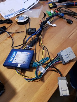

I have the chimes set to the 3rd (2nd most quiet) setting and it's still pretty loud. I'm gonna bury it in the dash.
Over all the wiring was intimidating but in the end it was pretty easy and straight forward

you could try covering part of the chime speaker with tape, or cloth
