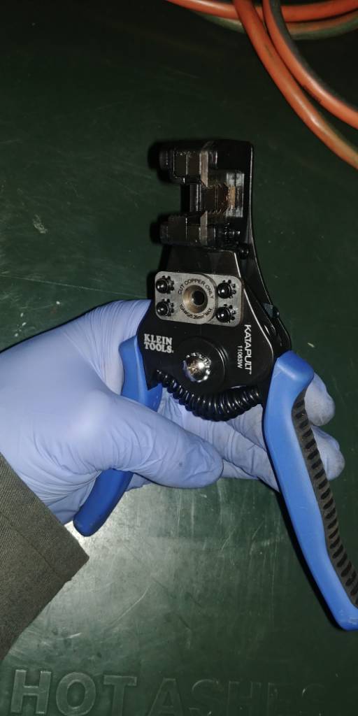

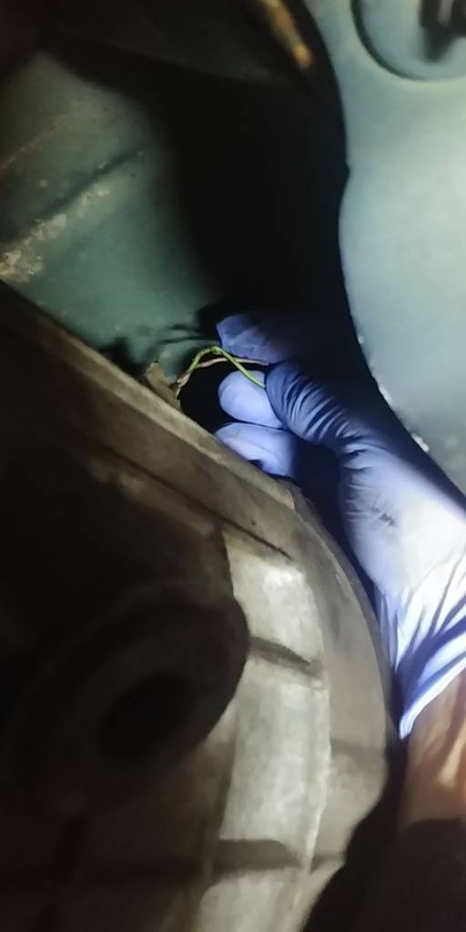

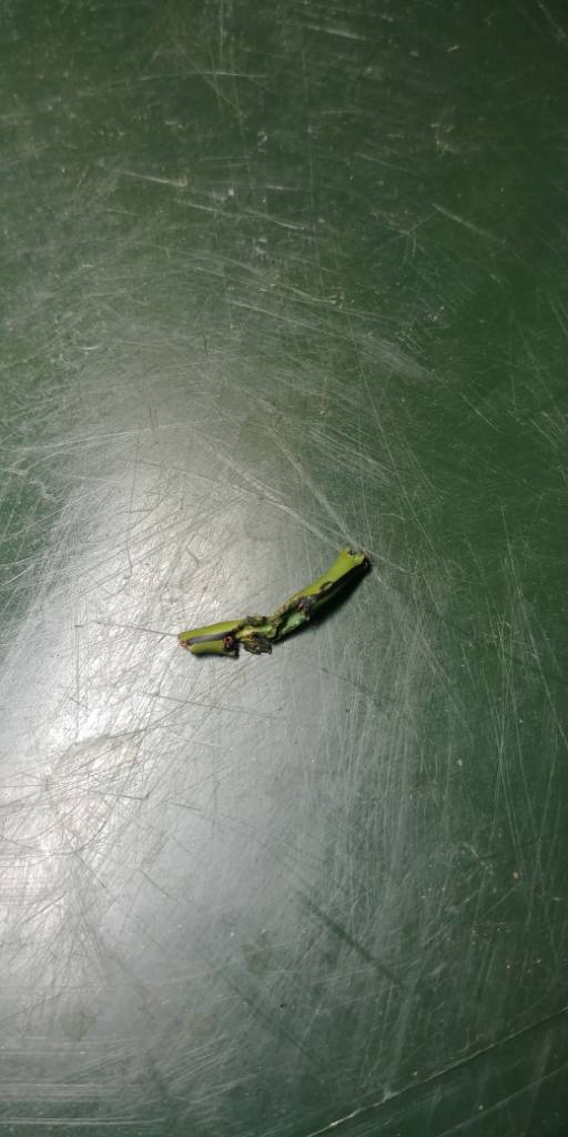

Cleared codes, took it for a drive around the neighborhood and Autozone for a new can of quick dry electrical cleaner spray and dielectric grease It acted up again after about 45 mins of driving. It coded Erractic VSS signal with ABS lights lit and beeping, but I was in my neighborhood at that point and got it home, it did shift fine though. Afterwards, I cleaned and greased the TB, PCM, multiple ABS and Trans/TC harness connectors, and battery terminals. The negative terminal was actually pretty crusty. While looking for connectors to clean I think I found the culprit. On top of the trans, a purple and green wire, the green one was mangled and hanging by a thread (literally). It doesn't look like rodent damage but probably from removal and installation of the reman transmission. I do not see the Purple/Green wires on the ABS schematic above... Its pretty tight up there, I will have to get more slack to solder it back together or get on of those nice Klein wire strippers from HomeDepot. I hope to fix it tonight after work. Wife is getting pissed she is car-less and borrowing neighbors minivan.

That broken green wire is an extension to the Left Rear VSS, same color combo (green/purple). This has to the be issue, right? no problems with a 40 min test drive last night. I bought the one handed Klein wire strippers and they worked great. Soldered and heat shrink wrapped, not fun having beads of molten solder roll down your arm into your sleave, but it wasn't too hot. Lol. Took a 70 mile drive today, good to go...
