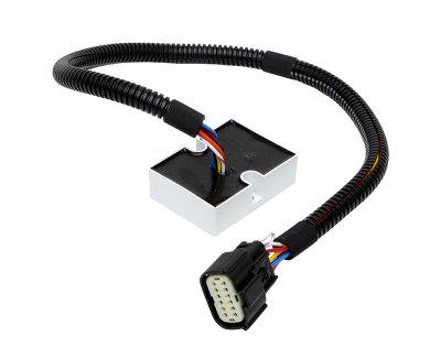

Check the wiring around the rear taillights for something that looks like this... it's a whelen strobe module... if you find it just remove it... when they decommissioned your truck they probably cut the signal wire to it and its shorting out and triggering the module to strobe...

Sorry for the delay. I work full time and go to school full time. Not much time to play around with projects. I just drove around with the strobes on for 2 weeks. Didn't get pulled over! Lol. It was loose wires inside the rear wheel well on the drivers side. When I hit a bump the bare wires would hit metal and trigger the strobes. Slamming the rear door would turn them off after I arrived at my destination. I didn't find the strobe module, although it looks like it might be up above the BCM in the dash. I would've had to take the bottom half of the dash off to access it to be sure. Thanks for the help though!
