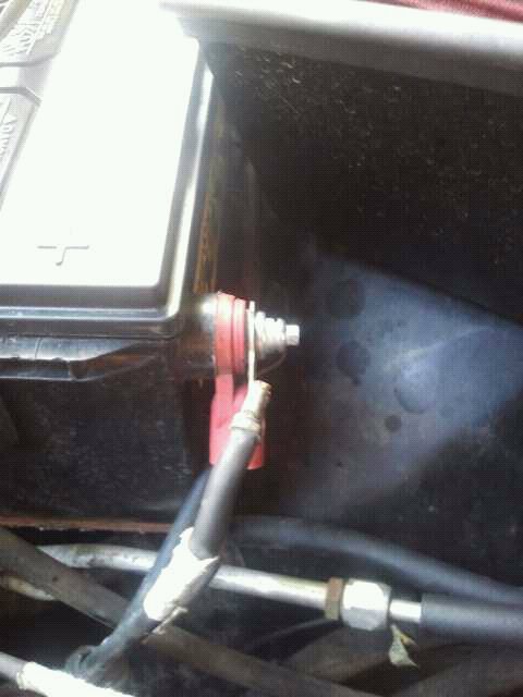

I had this problem on my 99 Yukon and it kept giving codes for the o2 sensors. I figured it out yesterday the battery cable on the positive side was not getting a good connection so all I had to do was take off the rubber sleeve and it fixed my problem of the last two years... and no more ses codes. Also I always had enough power to start and run but it was causing just a small enough problem.
Sent from my SGH-T959V using Tapatalk 2

took the bosch O2 out and it was scorched all around the base. after driving maybe a half hour total with it. and i prefer acdelco parts but we didnt have one in stock. although my battery cable is definitely corroded where they spliced it to put a system in it...
