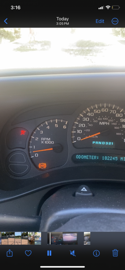

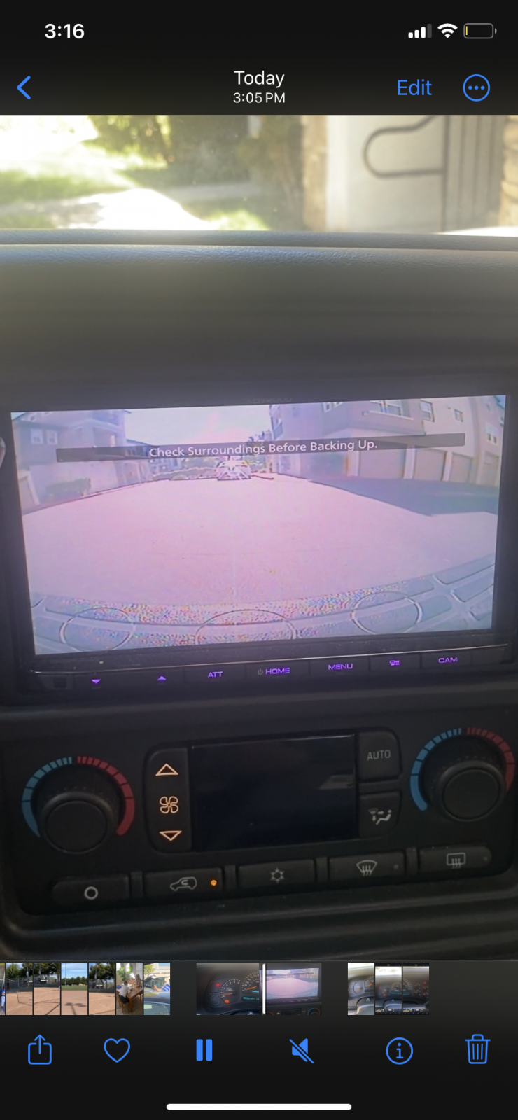

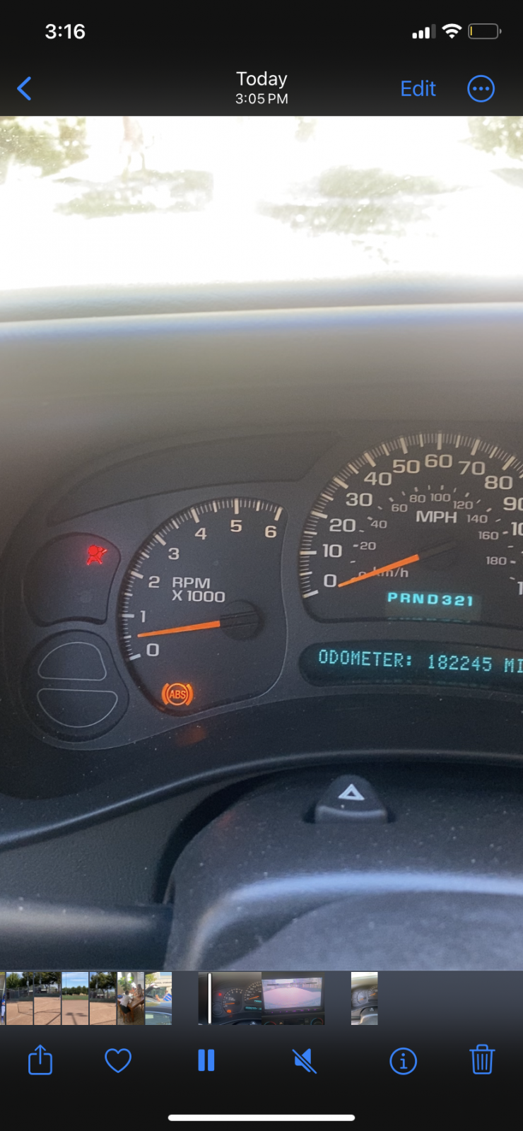

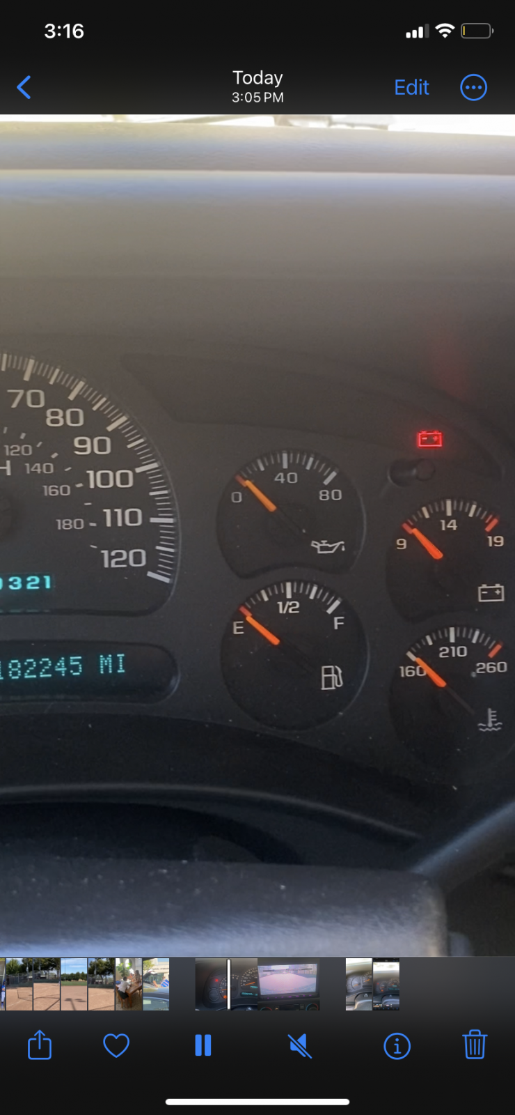

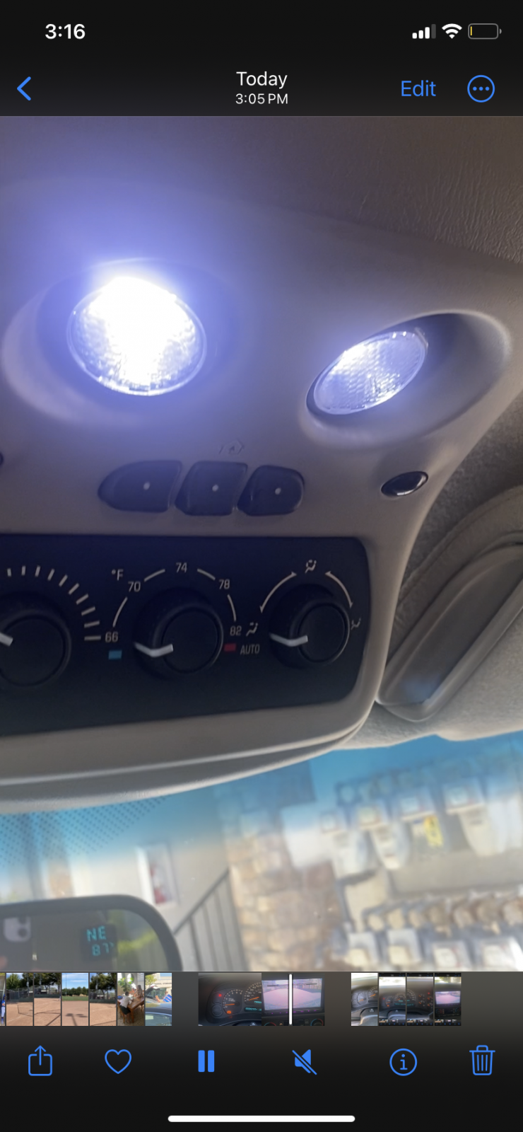

Hi everyone!!
My Tahoe completely shut off on me while driving the other day. I disconnected the battery and reconnected it and it started right back up. Now from time to time it will start up slow and then when it starts the right side of the dash board doesn’t work. The AC and power windows don’t work and my back up camera stays on. The dome lights also stay on during this time.I have to disconnect the battery multiple times and then it will work for a few days and then happen again. Do I need a new battery? Ground wire? Any suggestions would be appreciated. Thanks.
