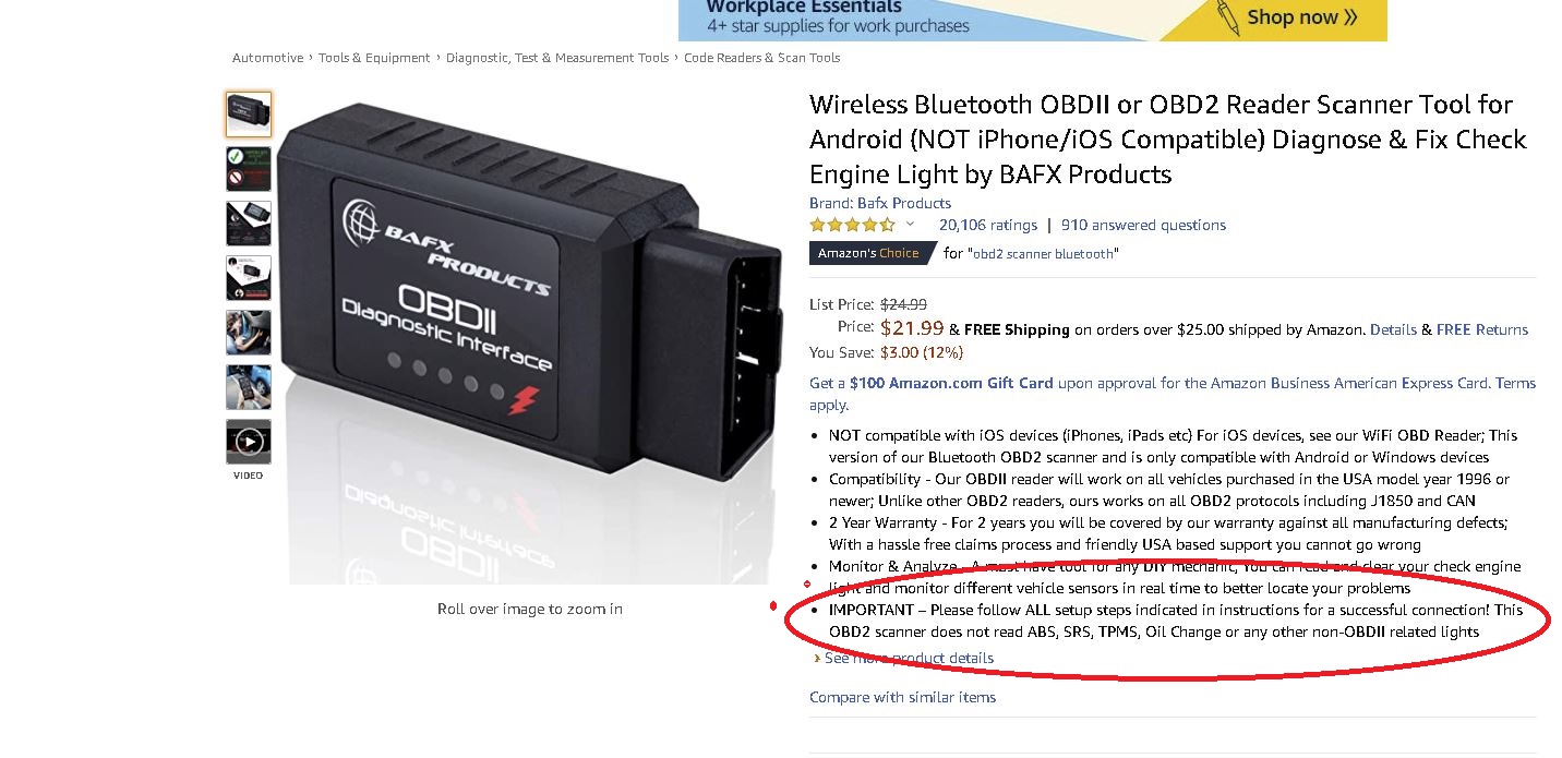

I haven't seen one do it yet nor anyone else on here, there is a even a new fancy pants one on the market and I asked the seller if it would read it on our trucks and they said no,
I have 4 or 5 different bt ones and I tried all the apps out there and none will do it, they either hang, timeout or just simply won't read it.
on top of that abs and srs codes are not typical obd code's, they self check each time the key is cycled and if everything is good they wont light up or save a historical code, sometimes a abs or srs code will store but it depends on what the problem is, like when the abs modules get broken solder inside and when you hit a bump in the road it sets the abs light off and then when you park and take key out and then start it again the solder is connected and the code is gone because it passed self test.
most of the bt readers or any others for that matter will have a little disclaimer saying it may not read/work on all platforms yada yada.

most of them have a little disclaimer such as this one, and oddly enough almost all the bt readers out there are based on the same chipset, they just slap there own name on it.
