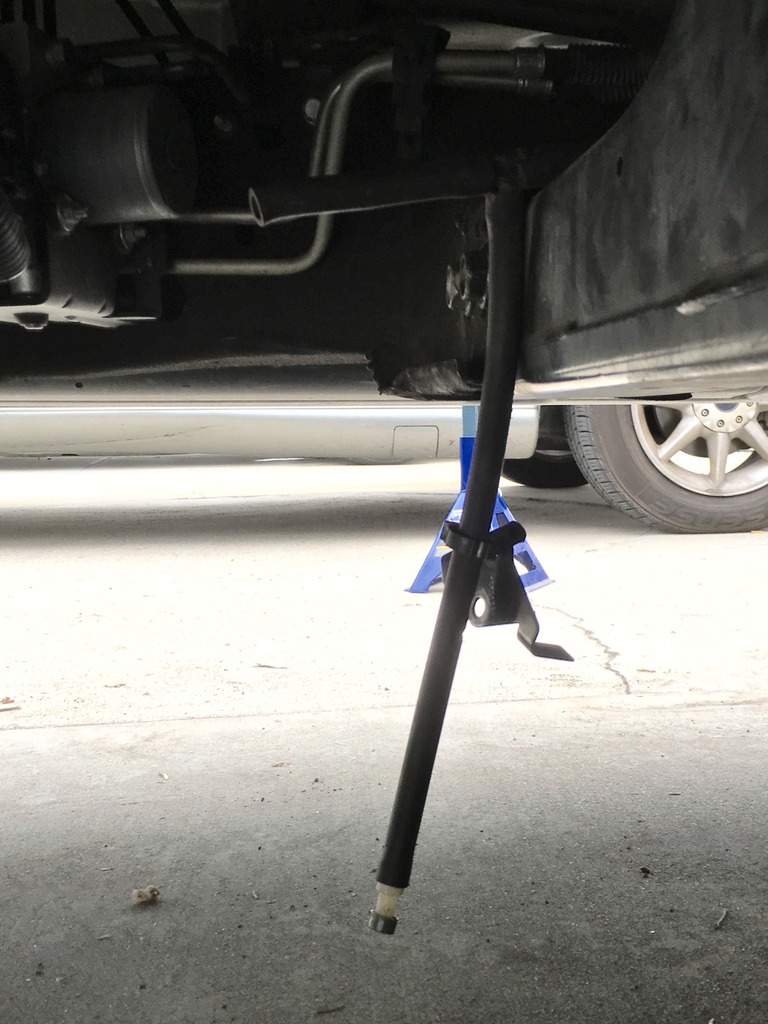

Whats up everyone I have a problem identifying this hose that's located underneath the block right next to the transmission, this hose goes from the passenger side of the motor down below and and over the transmission case towards the drivers side and sits in top of the crossover bar then it has a T With one hose closed off and the other open I'm not sure where it came from it doesn't look like it can unhooked from anywhere but it's hanging now where it's visible because it lost. A bolt I have no clue what this is maybe u guys can help me with ur expertise and experience here is a pic of what I'm talking about metal to rubber hose connection

I'll try posting a pic I tried earlier but said file was too large I'm doing it off my phone too

Here's another pic

If it is that I don't know where it hooks up too I can't seem to figure it out ?

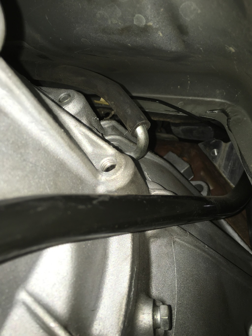

Ah ok thanks I will post a pic of the hose that sits above the crossmember and maybe u can tell me if that's the way the hoses are suppose to be at the T one hose is just open and the other hose on the T has some kind of plug on the hose

Here is the other side of the hose from the last pic I took u can see both hoses that T off that main rubber hose .... Is that how it's suppose to sit above the crossmember just like the pic shows?

yes the plug has a bal valve in it to help regulate air flow. im not close to one right now but i will try to look at one in the AM and let you know for sure. i think the bracket should just connect to the cross member and hold it up. but sometimes they are mounted on up in the engine bay

just went in my buddy's trans shop and he just happened to have on in the parking lot. that l shaped bracket was bolted to a stud ont the front side of the transfer case on the one i just looked at.

thanks for taking the time to do that I appreciate it ..... So the hose with the bal plug and the other hose that's just open is the way it should b when the bracket is mounted right ? I'll have to see if I can get it to mount in front of the transfer case U didn't happen to take. A pic by chance did u?

lol sorry no pic... it was getting dark and i was using my phone as a flash light. the bracket is just to help position it and hold the other 2 pieces up. i bet you will be able to find the stud as soon as u start putting the bracket close to the transfer case.
