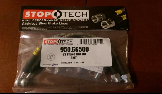

I used these for front and rear, and have had 0 issues. Probably going on 5 years now.

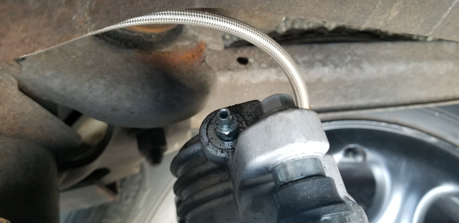

The goodridge center line fittings are still too deep to seal with factory fittings. How were you able to get a proper line from them?
gotpierced
Aug 3, 2023
I finally got in touch with goodridge and after talking to three people they confirmed that the center line fittings don't seal. They did send me tiny copper inserts to fix the issue. I haven't put them in yet but will update.
Goodrich has known about this problem for awhile. I'm surprised they're not including them in their kits--unless you bought an older setup.
