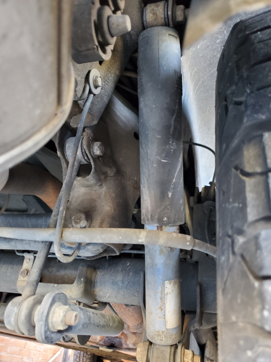

Trying to make sense of what shocks I have and my replacement options on my 2011 Yukon XL SLT. I've been reading through threads here and from what I understand I have the ZW7 premium suspension that supposedly includes Nivomat self leveling shocks in the rear. I do not have the Z55 option and my other option codes are 6XU and 7XU whatever those mean. I'd like to get a more heavy duty shock, my Yukon has the tow package and when I load it up with a roof rack, full back area and a rear cargo holder it rides low in back and tends to bottom out when going over big bumps.
What are my options for rear shocks? I don't really want to add any lift just something that will handle the load better, When I go to rockauto most of the heavy duty options from Gabriel, Monroe and Rancho all say except Z55 or ZW7 suspension. Also is there anything else worth replacing back there like the stabilizer bar links?

As far as I can tell, the ZW7 Premium Smooth Ride on the NNBS trucks does NOT use Nivomat shocks. That AC Delco replacement @PNW VietVet posted is clearly not Nivomat technology -- not at $55 -- and, from the pics, your shocks are also not Nivomat, but do look like OE to me. Doesn't look like you have many options, as I see that KYB doesn't make a compatible shock if my search was accurate.
You may need to upgrade the rear springs for a better load leveling experience. Others with NNBS suspension experience will chime in.

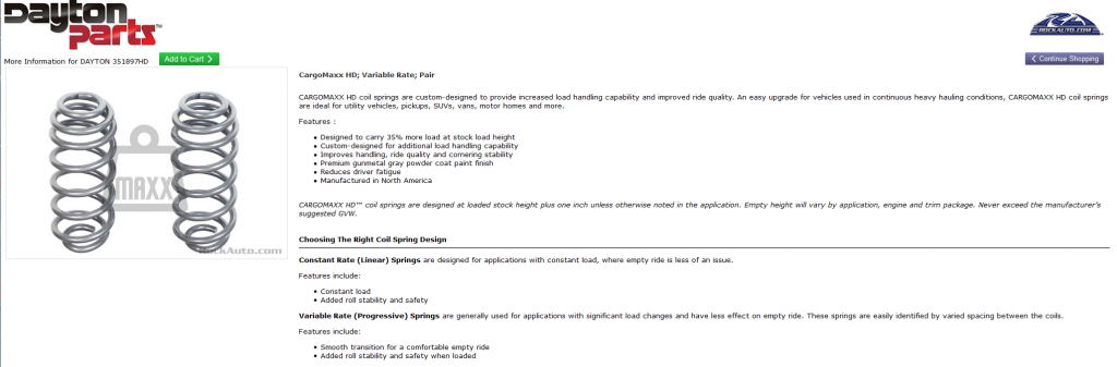

I guess what I'm most wondering are these Dayton CargoMaxx HD springs worth the $100 more than the AC Delco springs or presuming the rear springs are just worn will the AC Delco springs help handle the load better. This CargoMaxx line seems brand new and was the result of an acquisition they made, they are pretty much zero reviews on them on the internet. The description sounds good carrying 35% more load at stock height but is it worth the extra $100 over the AC Delco's.

ha, yeah think I mentioned I might tow at some point, right now just trying to handle the load without towing. I guess I'll bite the bullet and get the CargoMaxx springs and see how it goes.

I'd rather not go the Air Lift route and just try and stiffen up the coils. If I bought new 45H2164 for the rear would that help over the current worn coils? The other option I was looking at was the Moog 81071 coils, I was going to try the 81069 HD coils but don't want the 2" lift that comes with those.
