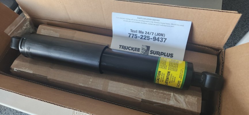

This guy knows his stuff…..

Thks. Yeah..spoke to him. My yukon has 145k on it and nivomats have failed. He sells used shocks so dont really want to spend $$$ on something that may fail quickly. I assume some of his shocks may have even more miles on them than mine do. They were good while they lasted, but now i think a conventional approach might be best...but just looking to see what others have to say.

I don’t need to say anything about your conversation with him…. It’s up to you to decide…..
The Nivomats he sent me were used but were nearly brand new.
I returned them due to my mistake, not knowing ( at the time ).. that a ZW7 code was just a part of my option.
Good hunting !

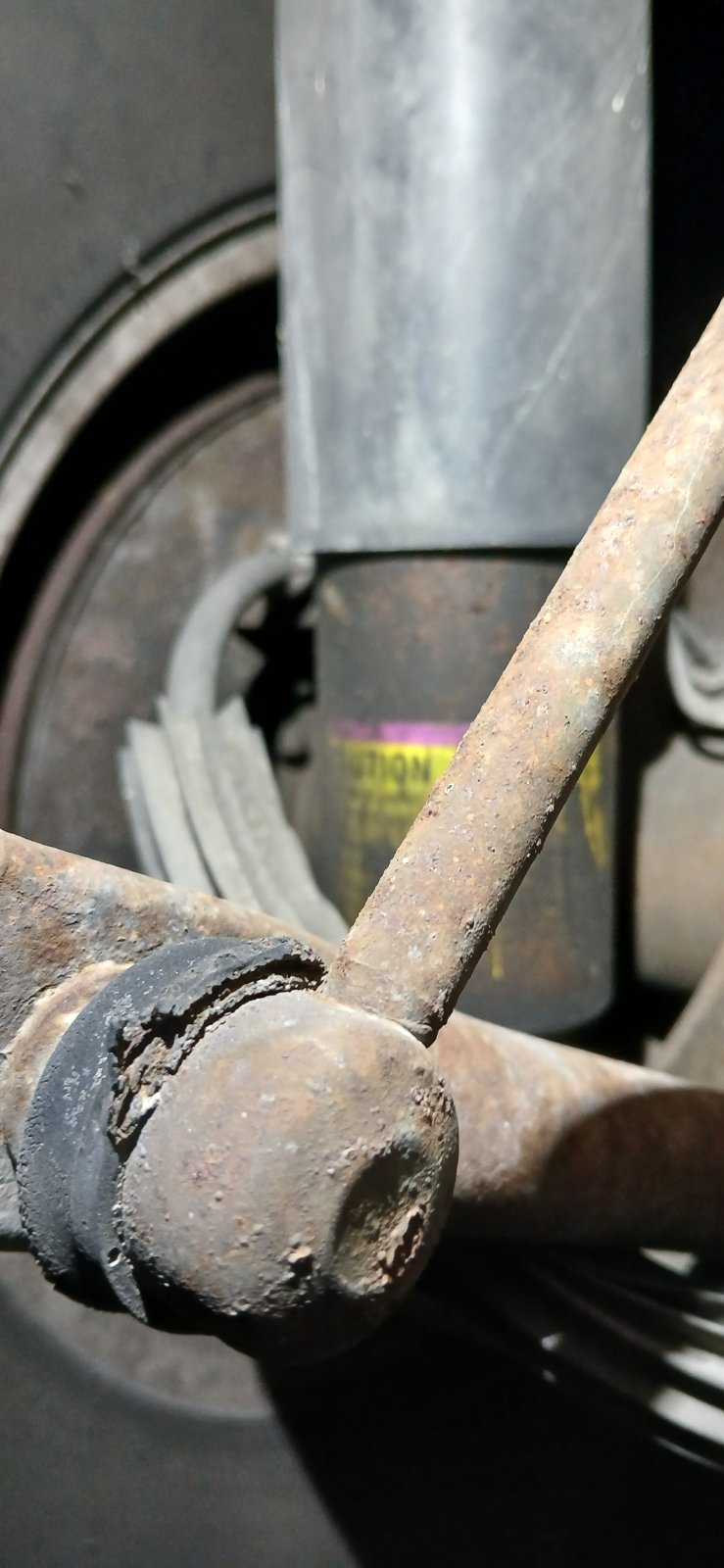

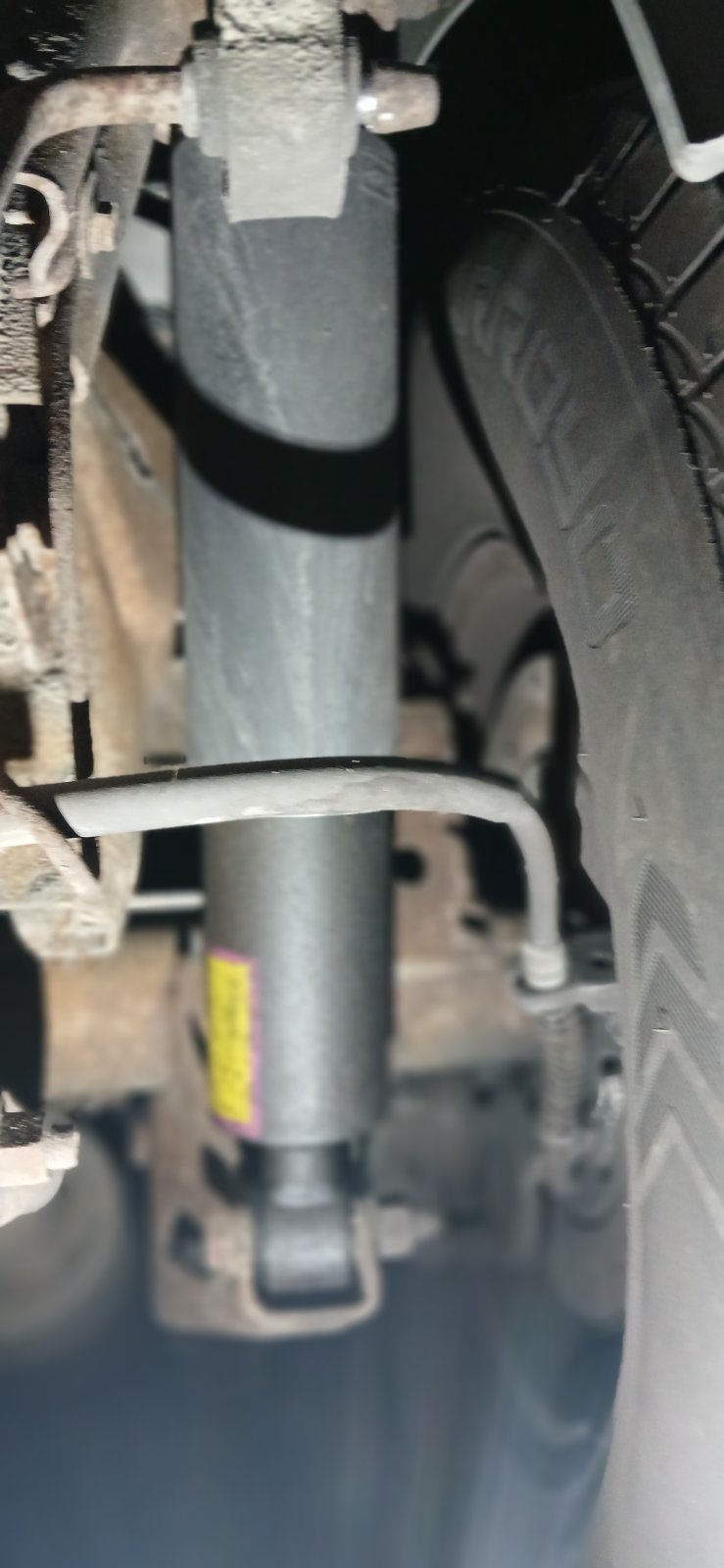

Ok...had to go take photos. Dont know if thats oil leaking or just road dirt.
Looks like a seepage for a long time……. Nivomats do not have a “pump”……. They are self-leveling / self contained inside the shock.
After a few short miles they are supposed to return to a proper height.

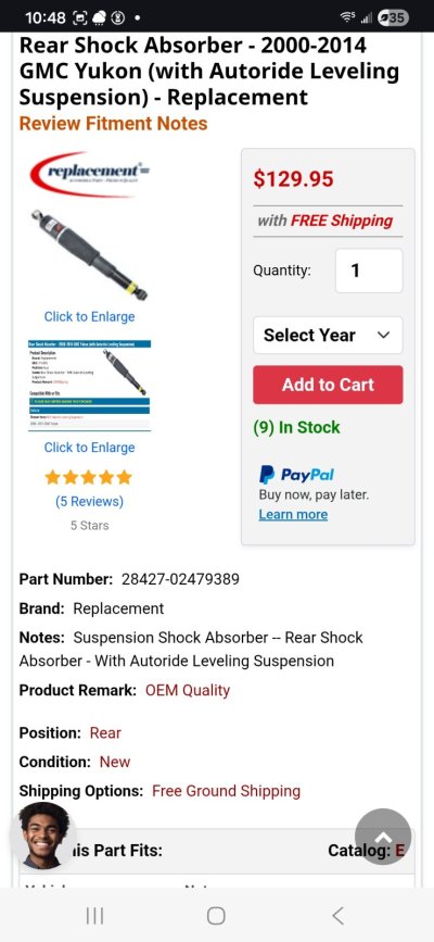

Found these on partsgeek.com. anyone tried them? I dont even know if theyre nivomat replacements so ill have to call them.
I question the price for quality…….
Also, technically, “Nivomat” is the old name for these shocks. They are a SACHS manufacturer that will describe them as Nivomat due to the original description.

Youre right...i contacted partsgeek. They have a replacement for the magnaride too. Oh well...it was worth a look
