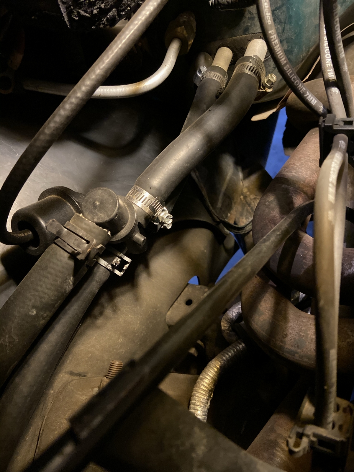

X2 on bleeding it again. With engine cool and cap off, start the engine and let it get to temperature. Top off the coolant as it drops when the thermostat opens. Repeat until no bubbles come up.
Are the hoses at the water valve routed correctly? Are they too hot to hold for more than a few seconds?
Does the water valve open and close? Push up and down on the metal rod at the bottom to cycle the valve. It should return to the down position if the a/c panel temp dial is not set to the “max” cold detent.
Top hose is from the intake, bottom one from pump.
