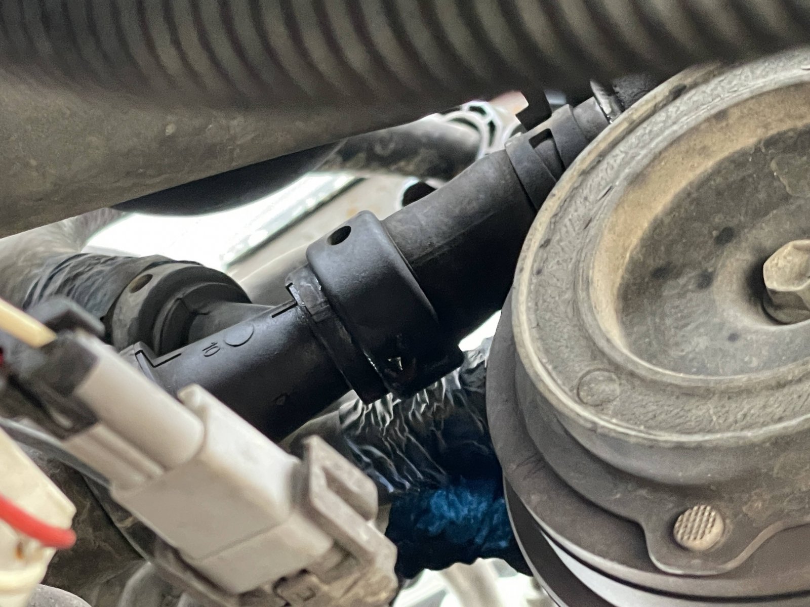

@Foggy I ended up getting a 111mm metal dorman and a 113mm metal dorman for the firewall and then another metal dorman Y one with hoses for the water pump are. Thanks guys, sorry to come back to an old thread but it had the right people in it I needed
heres my leak

You can carefully cut that plastic collar off the hose, and replace the hoses themselves... . But with the reasonable price of the Dorman metal y-pipe, it's sort of a no-brainer. As for the plastic tee fittings to the heater core, if you stay with the plastic stay with OEM genuine GM.

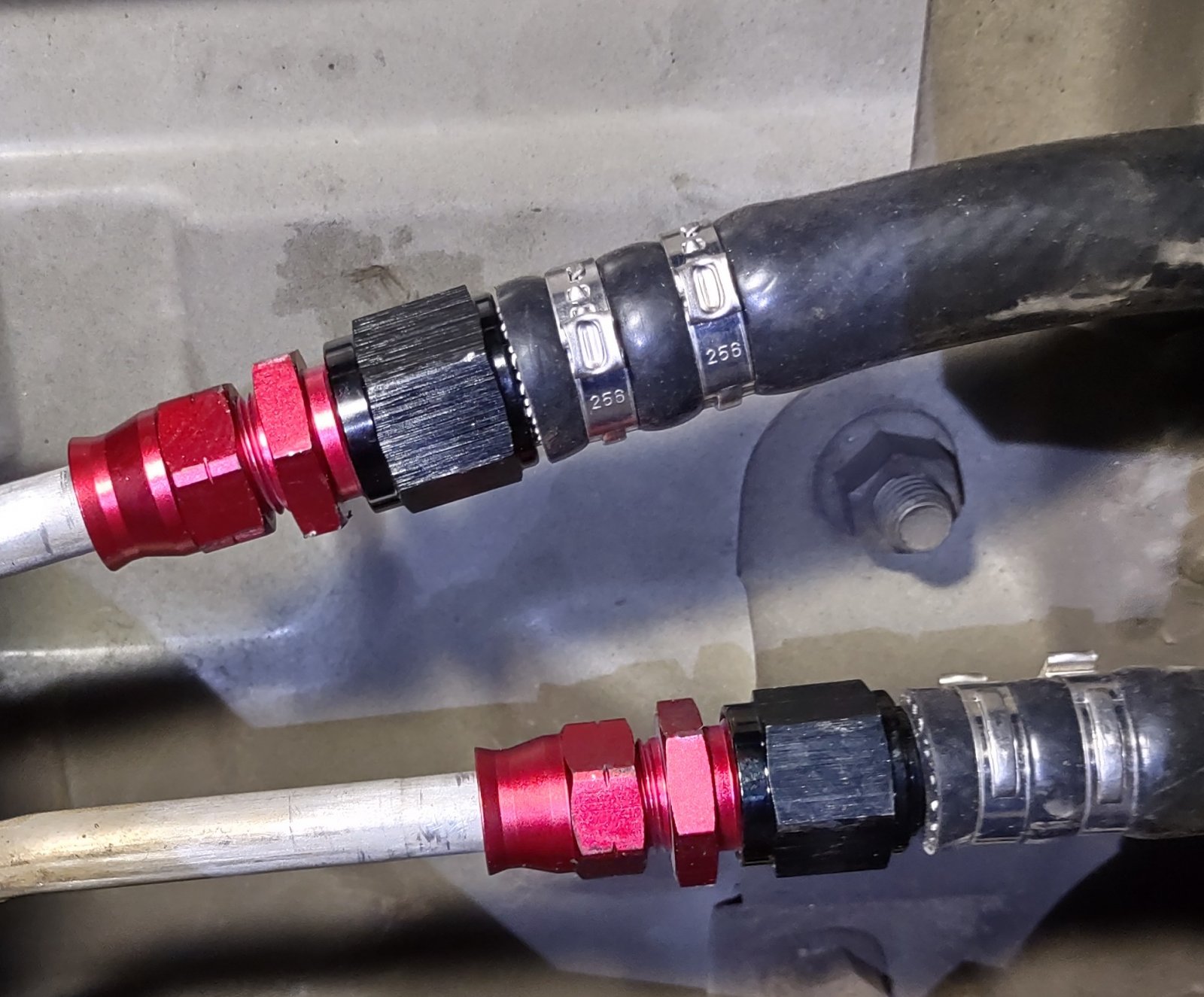

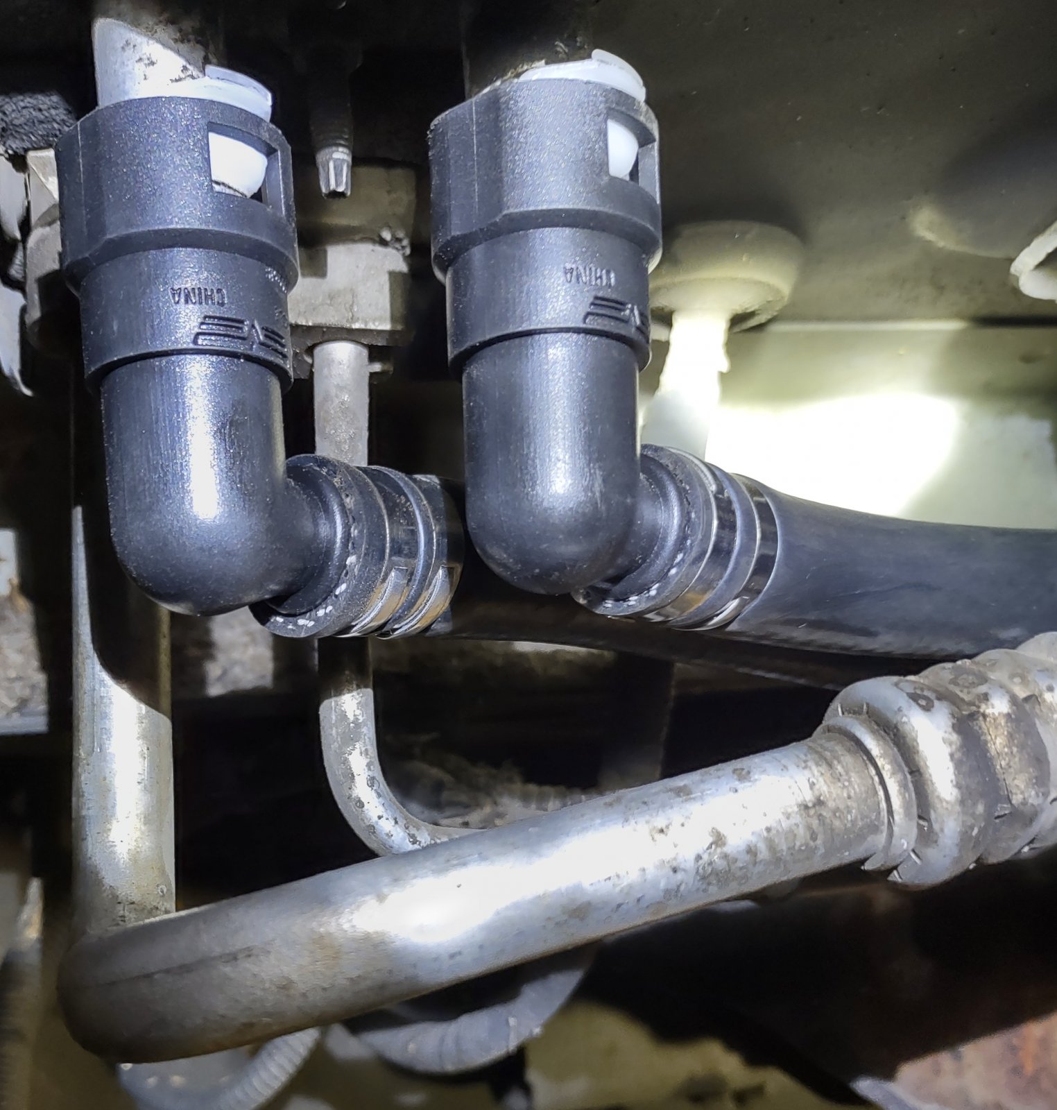

The hoses nobody seems to look at until it's a problem are the ones behind the right rear wheel that go to the heater core in the back. The hoses are available with a complete line set.... Rather prohibitive in cost. For that I used a dorman 90° 3/4 in by 5/8 in hose barb..... Dropped the spare tire, cut the metal lines and use a compression fitting and convert to n AN fitting. Makes the flexible section easily replaceable in the future.
