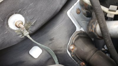

Thanks @Big Mama , the ground connections and strap in the engine bay look good and clean. I just disconnected the engine bay ground strap again and cleaned it well (see pic), no change in symptoms. Things like power windows, seats, mirrors, radio, locks, etc work consistently, the seats just blink and click and the issue seems isolated there.
