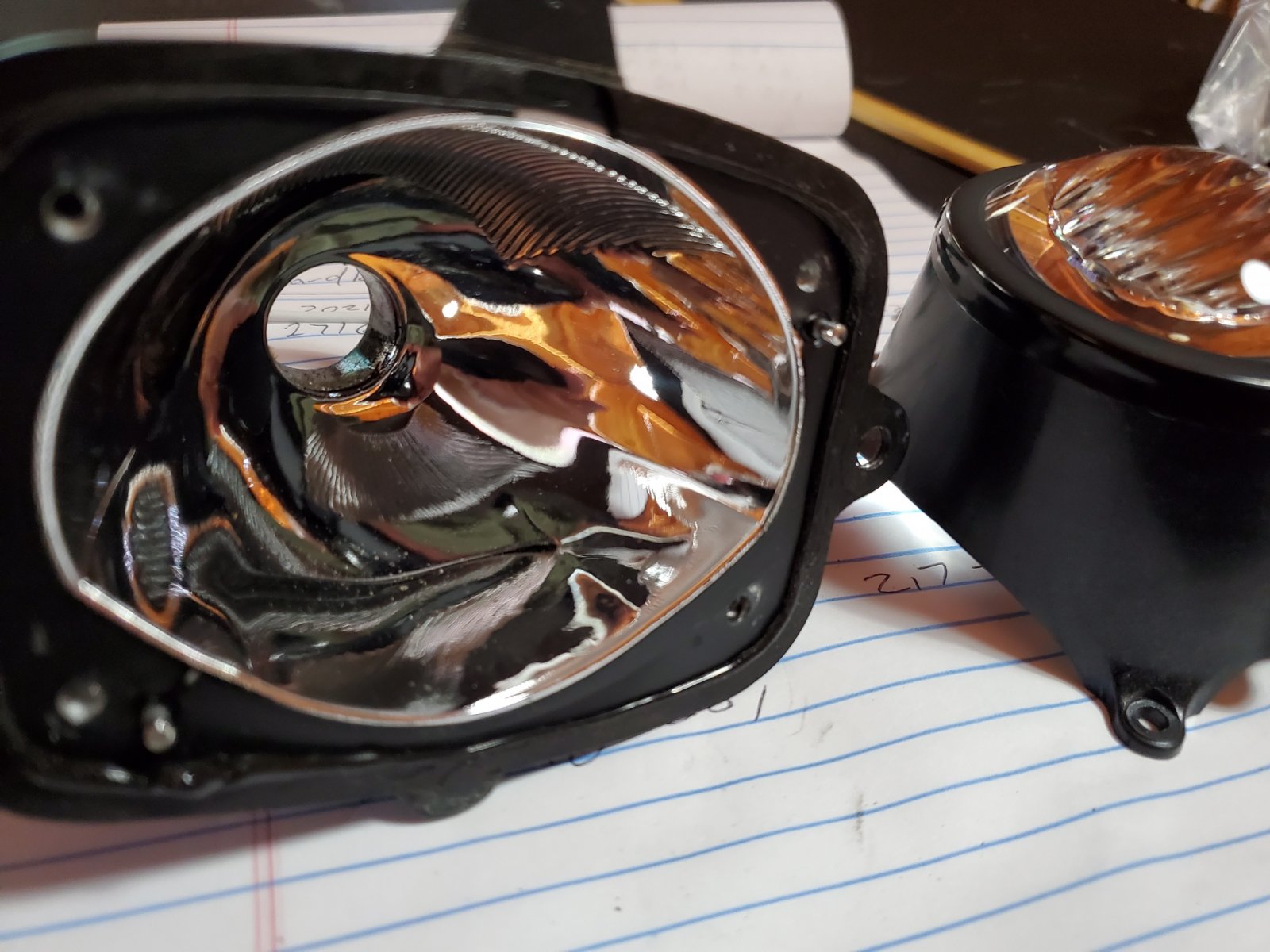

If your reflector is flaking, I have a the set that I took out of my Denali when I retrofitted them. See pictures, let me know if you are interested in them.
