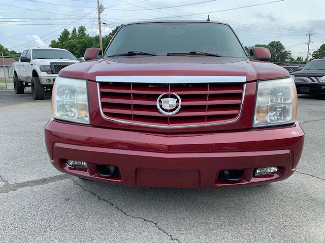

Well, we wheeled the headlamp lenses on my 06 and it appears they are too far gone to look new again. So I guess I'll be replacing them. My first choice is HID/ LED combo that DOES NOT include halos. Second choice is stock HID. Anyone know where to find non-HALO LEDs; or where I can get the best deal on stock replacement?

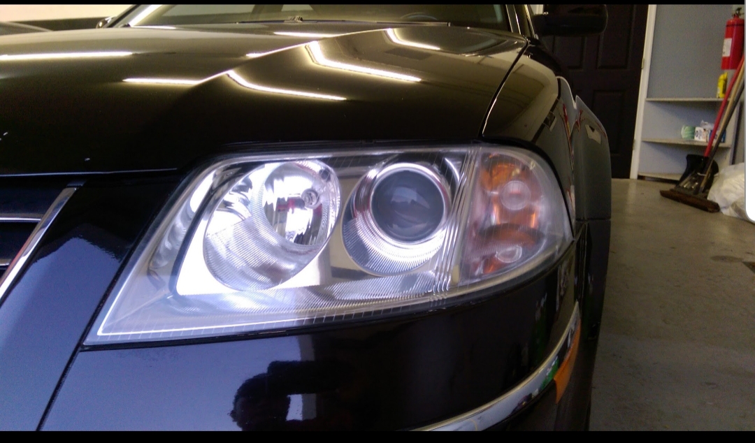

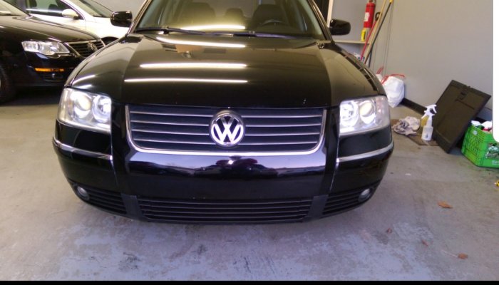

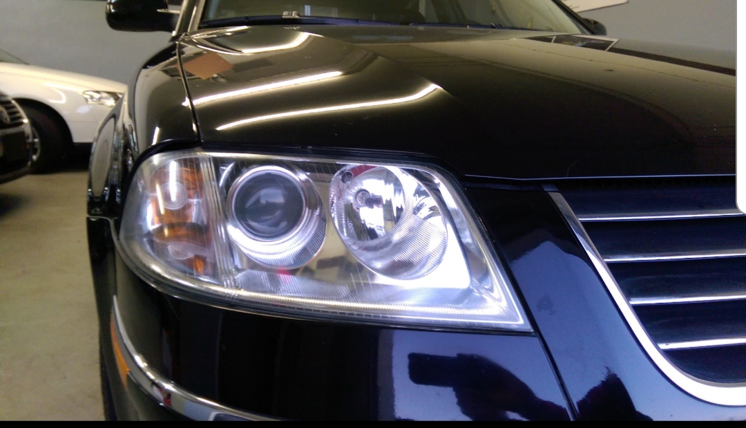

I can't answer your question, but when I used to restore headlights, I used to use a palm sander with a special rubber cushion/pad that the school I learned from, sells. Depending how bad the headlight was, I'd start out dry sanding, then work my way up to the finest grit paper, then use some 3M plastic polish on an orbital buffer. At this point they came out pretty good. The last step would be to use a special 2 part clear with UV protector. I'd put it on with a lintless cloth. They'd always looked amazing afterwards. I did headlights for years in my business, and I offered a 1 year guarantee on yellowing. Never had a come back.
Hard to tell in the before pic, but they were yellow too.
This was using the process I described.
