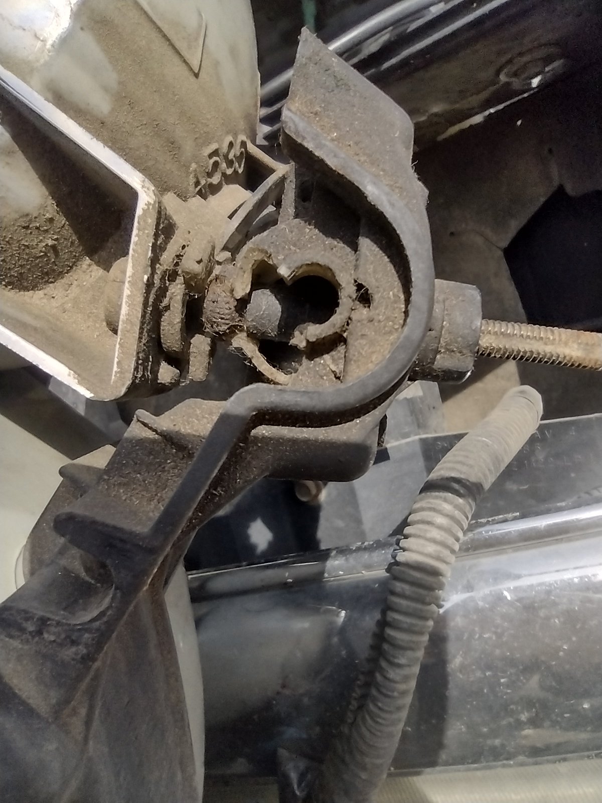

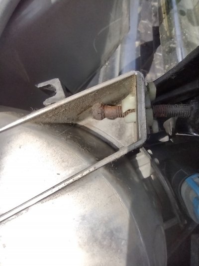

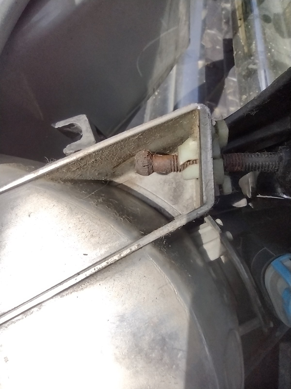

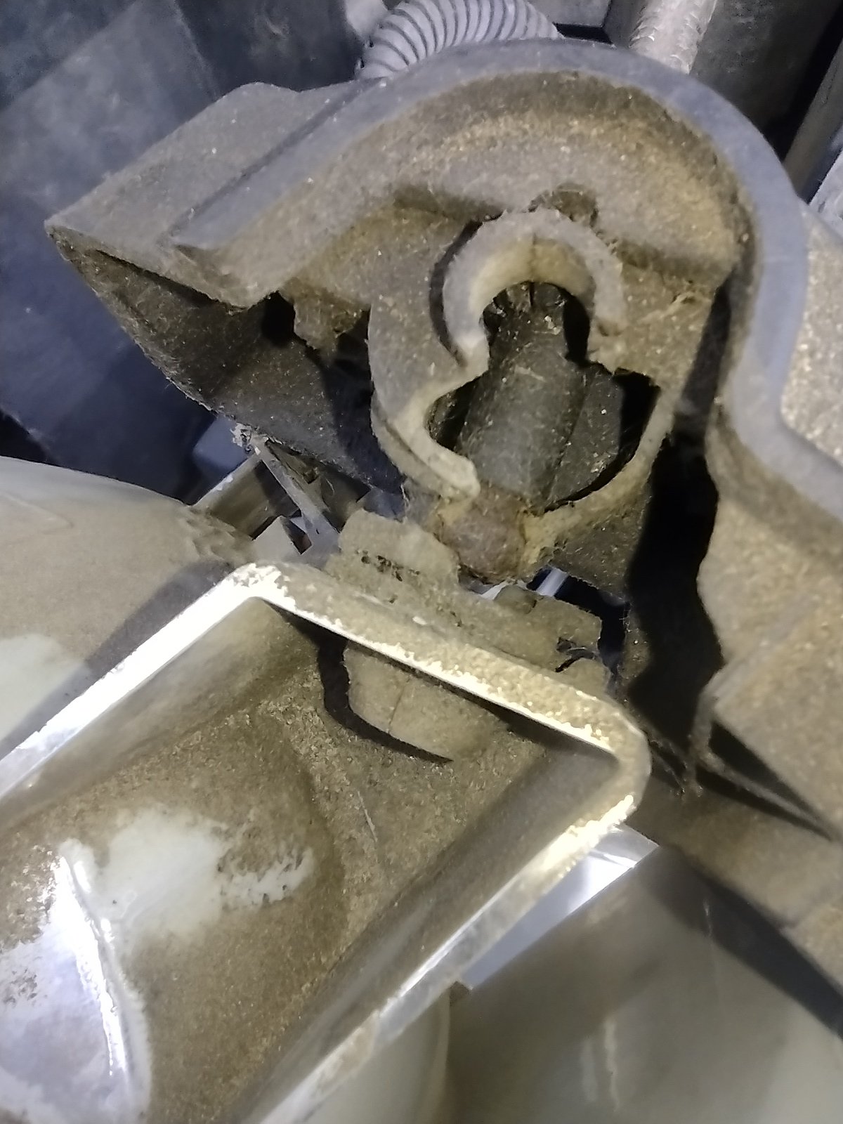

I'm in need of the headlight adjusting mechanisms for my 03 Tahoe (looks to be the same as my 06 as well).
The plastic inserts have split and the threads stripped. Some worse than others.

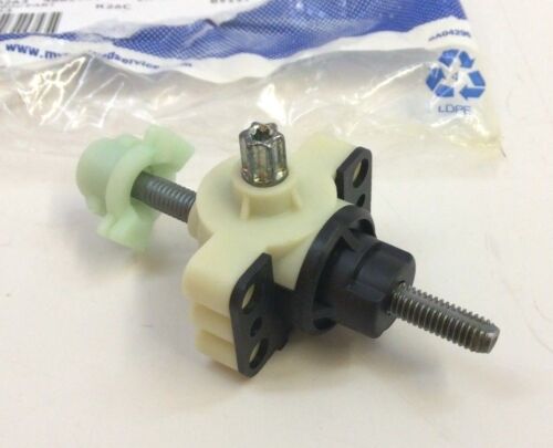

Seems you need to be looking for part number 16524772. Take those "fitment guides" on various sites like Amazon and Autozone with a grain of salt. They're often wrong.

I can buy a single headlight adjusting mechanism as posted above for about 80 bucks each. Two required per side.

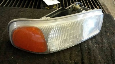

That very well could be. And interestingly, the places that sell the assemblies don't appear to sell the adjusters.
The part in the picture is 90 bucks CAD. Can't tell if it's complete with adjusters though. But I suspect it is.
