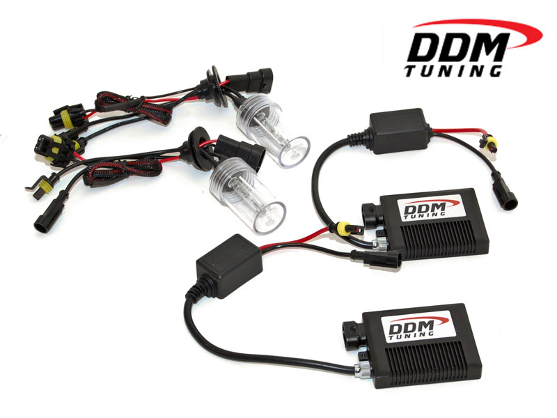

If they are at Advance Auto, they most likely aren't actually HID's, they are simply halogen bulbs colored to look like xenons. Don't get them. They suck.
Unless they come with a seperate box-like thing in the wiring (the ballast), they ARE NOT HID. If it's simply a bulb you pop in your headlight with no other wires or anything, it's just a halogen bulb and marketing you're buying.
Here, I'll make it easy. If it doesn't look like this, it isn't HID:

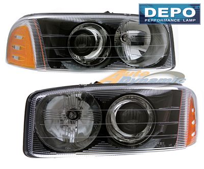

Don't put the above kit in standard Yukon headlights. That IS the annoying and dangerous kind of light that we are talking about. At the very least, replace your headlights with Denali-style projector headlights like these and get the HID kit:
