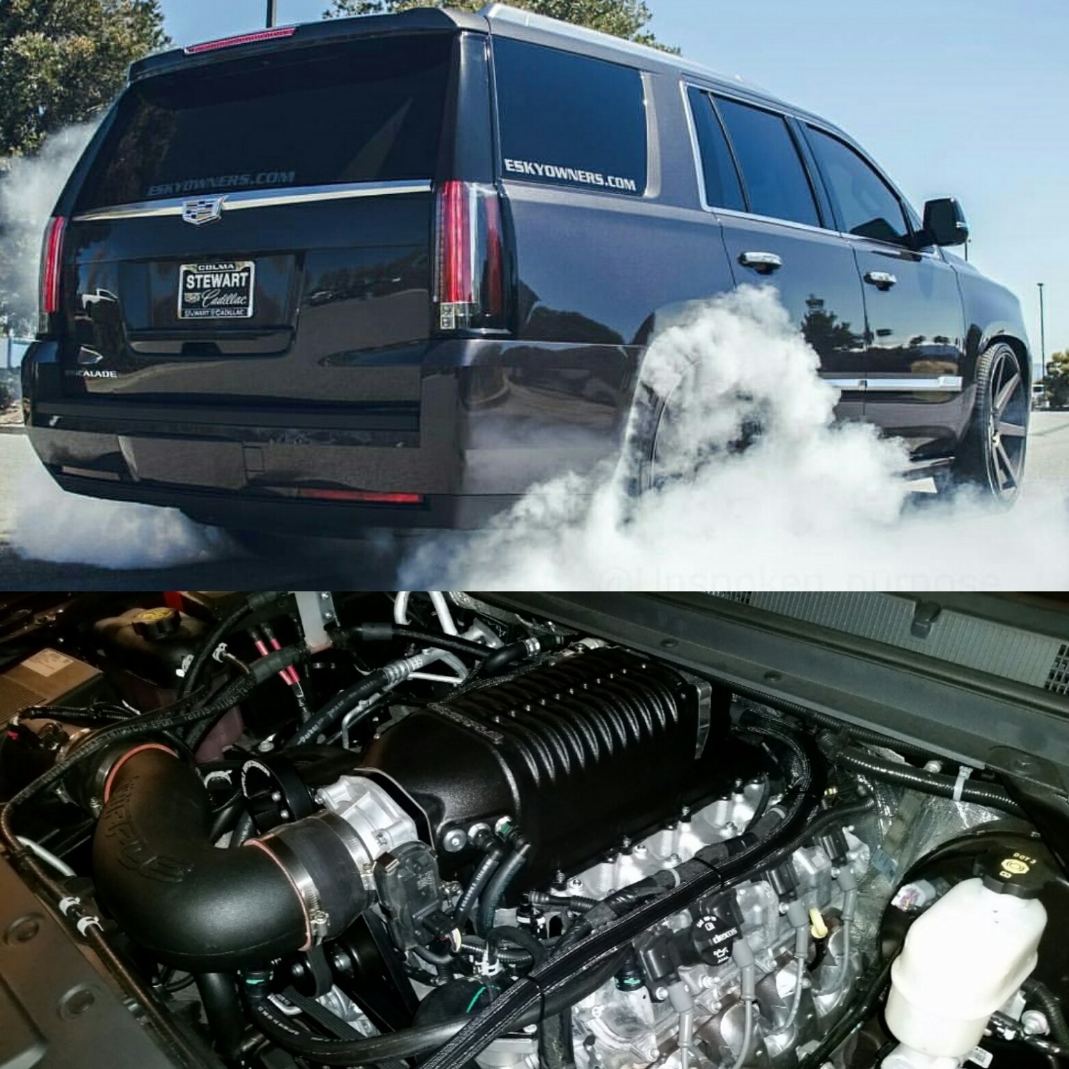

i have 1 7/8 arh headers and non catted y pipe and installed and sold many. I dont use kooks anymore the arh has better clearances. PM me My truck makes 565/573 on pump 91 gas and 7.5 psi on whippple 2.9

i gained a solid 25-30 rwhp on my escalade with the headers. no cats.
i have the full magnaflow 3.5 cat back also
