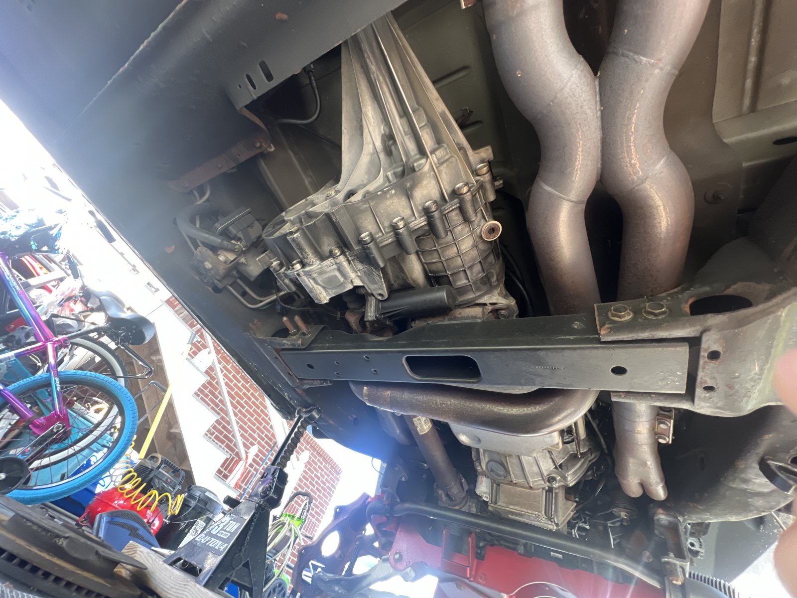

I’ve had 4 sets of their Longtubes now I recommend all my friends to speed engineering. My tuner also get them for a deal at like 280$ from one of his buddy’s…
Always fit like a glove I’d opt for Longtubes and the off-road x pipe and a good tune if you really want to make a difference
I have the 1 7/8” with 3” exhaust from them paired with corsa pro resonators it sounds fantastic
