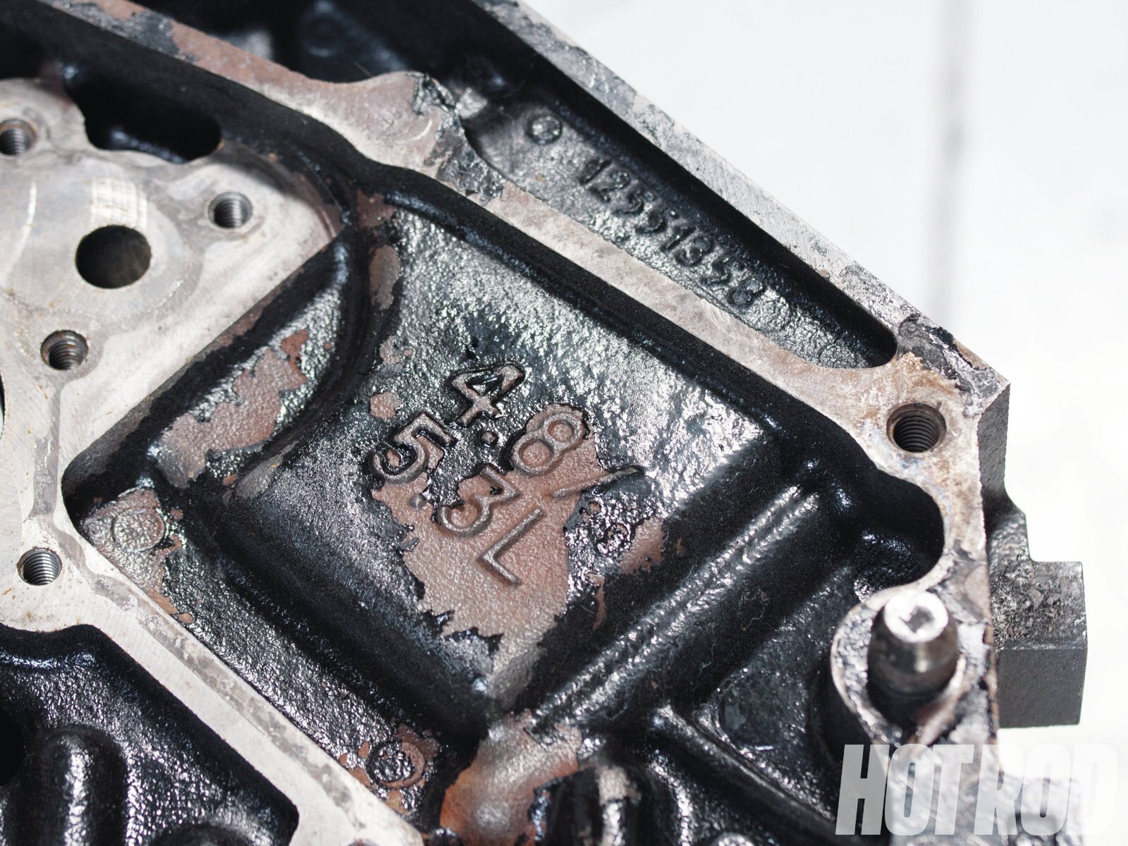

Anybody? I just want to know if headers for a 4.8L will fit a 5.3L as well
45,012
I don't see how they wouldn't work. The heads are interchangeable between all the engines and the engine blocks are even stamped with "4.8/5.3".
