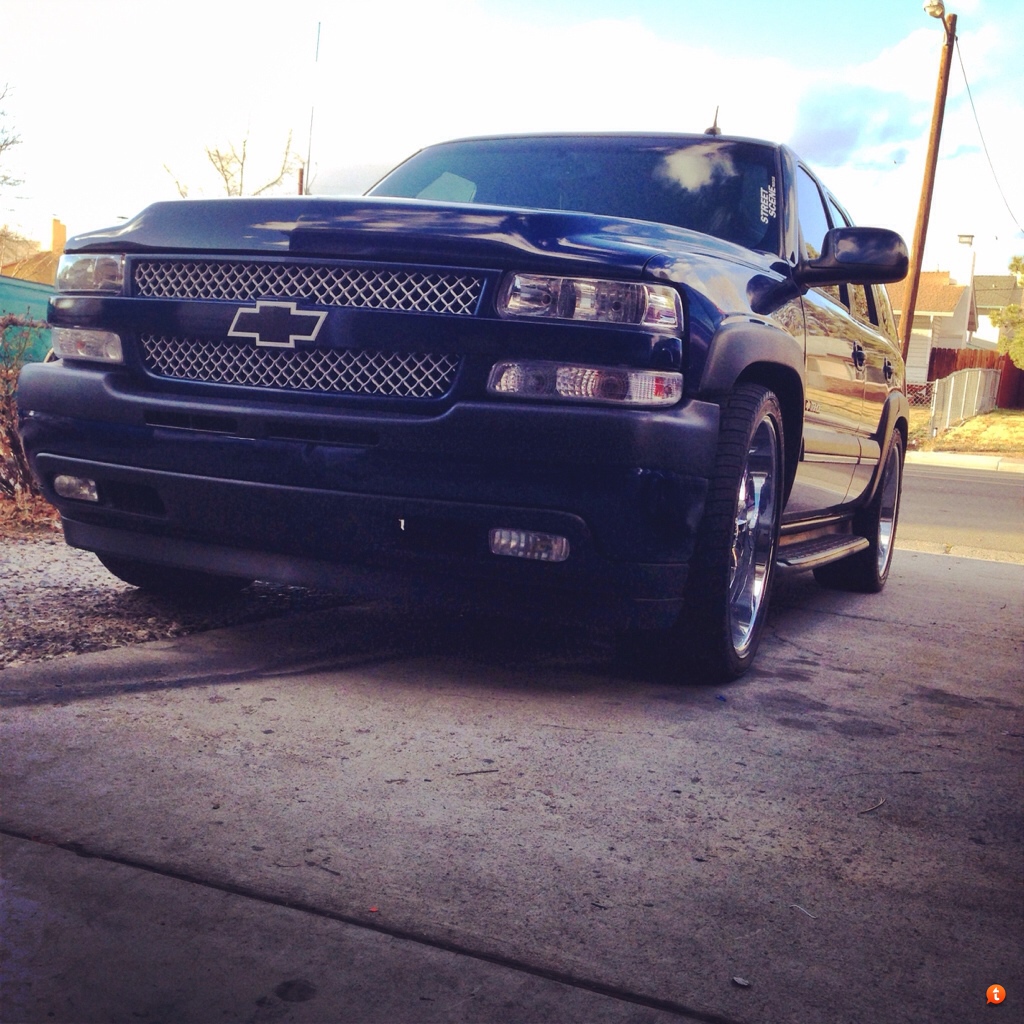

Hd conversion on my tahoe is complete

I have a question for anyone who no can i put a 03 silverado 2500 hd on a 01 tahoe
Yes you can I have seen it done you need the whole front end of a 2003-2006 Silverado HD
•both fenders
•radiator support
•light brackets
•Grill
•bumper/valances
•All front lights(same bulbs are used)
•hood
Modifications
•bumper brackets on frame I believe need to be cut and brought down and re-weld 1.75 inches moved down. You need to double check on this
Everything should just be a bolt on other than that.
---------- Post added at 04:36 PM ---------- Previous post was at 04:24 PM ----------
Some pics
