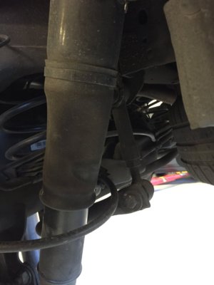

Which front and rear sway bar end links are everyone using for their lowered trucks? I know Energy Suspension has a couple that are adjustable, some sway bar kits from the various manufacturers come with end links, some don't. However, the ones that do are not always suitable for lowered trucks, but are rather suited for stock height trucks.
I will be lowering my '15 Yukon Denali XL 2"/3.5" and picking up some sway bars. Want to make sure I get shorter sway bar end links to keep the sway bars parallel after lowering.

I used a set of Hellwig adjustable for the rear. Very good quality, many different lengths, and great support! Highly recommended.

7690. 6-8” adjustable with 2” rear drop. Check your required length based on where you want the sway bar—your results may vary.
I think this is a typo, should be Hellwig 7960.
How did those links fit, did not have to drill out/enlarge any holes or such?
Kpwweb
Dec 11, 2015
771
357
I jave written down 7690 in my maintenance book, but it could be my lexdysia!
They fit fine. No drilling. I did have to get some more SAE thick washers as the end links were originally at an angle. Used the washers as spacers and they are more vertical now. Hellwig’s customer service was great! Top notch.
