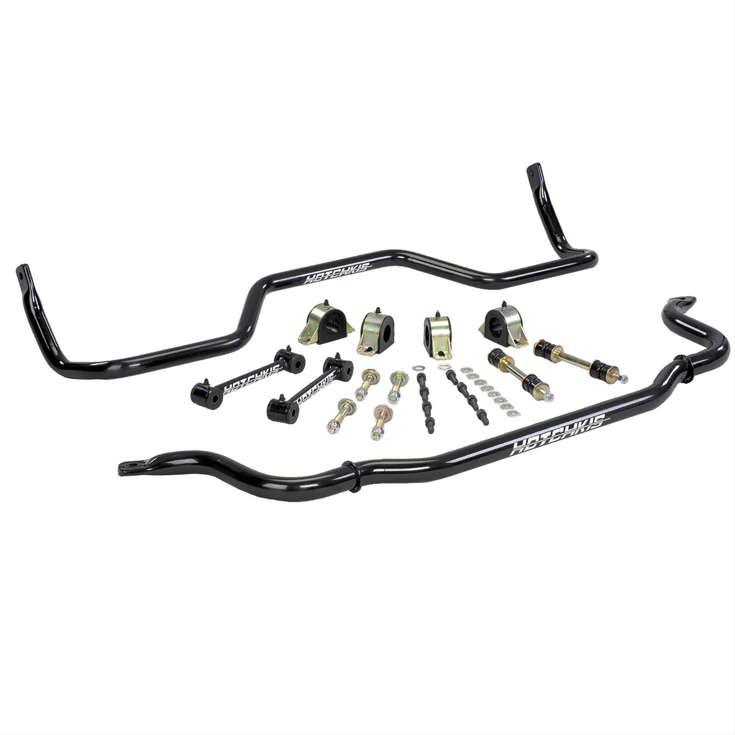

Hotchkis Sport Suspension Anti-Sway Bar Kits 2291
same is Eibach rear:32mm front:38mm

Hard to tell from the pic but it doesn't look solid like the hellwigs.
Yep, just read that they are hollow.
Mine (hellwigs) will be here Friday, install on Saturday. I'll report back...
+1. Hotchkis are nice sway bars, they are known for their hollow design that saves some weight compared to solid sway bars. I’d guess on average 25% +/- lighter than the equivalent solid bar depending on vehicle model etc. That being said, there are some reported cases of people snapping hollow sway bars. These are mostly guys in HDPE, Autocross, SCCA, etc type drivers pushing the limits of their cars in the corners. But with much lighter vehicles than ours; Think S2000’s, WRX/STI’s, M3’s, etc. Hell I had them on my own STI years back with zero issues, performed great, but in college it was just my DD/weekend warrior car not much track use...
With as much as our rigs weigh and for a daily driver application; Personally I’d rather have the extra security/stiffness of a solid sway bar over saving a couple lb’s with a Hotchkis hollow sway bar design.
I do however really like that the Hotchkis bar kit for our platform has built-in zerk fittings on the sway bar mounts for easy maintenance.
