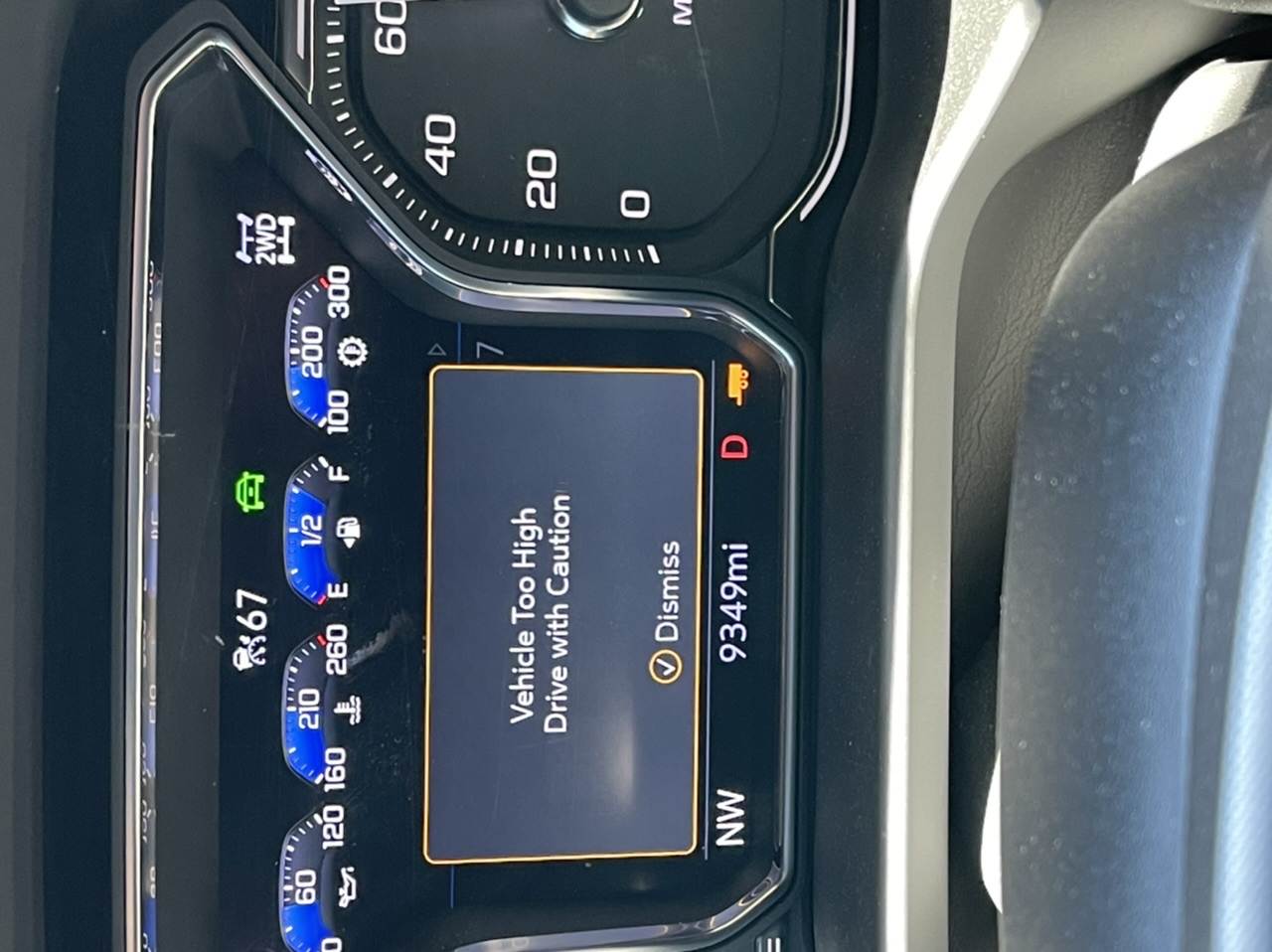

So before I tell you the conditions, I’m curious if anyone has seen this message before and knows what it is? I searched the owners manual and couldn’t find it.EADB60AD-D847-4B95-86DE-452662C526D1.jpeg

Wonder if it is speed related? Can’t see speedo needle.

Looks like a tad over 60mph to me... and the cruise seems to be holding.

It’s a message that relates to the air ride being fully extended and driving too fast

Lol so yes I was driving through CO. I was pulling my travel trailer with a WDH through the mountains. Went from the Denver burbs to Ouray.
I thought it was the air ride suspension being fully extended but when I checked it it said normal ride height. So I’m not sure why it would have been fully extended. I received the message twice. Both times I was going over a mountain pass. My speed was not fast at all. So not sure why I got it twice when I drove about 12-14 hours. With multiple shutoff and starts.

Air expands with altitude. Internal pressures in tires can go up by 2-3 psi at 5000'. Maybe the increased pressure in the suspension caused the suspension to increase height with altitude. After 30 years on P-3 Orions, Seaking and S92 Helicopters I've experienced first hand all the weird stuff that happens to contained gases at altitude.
