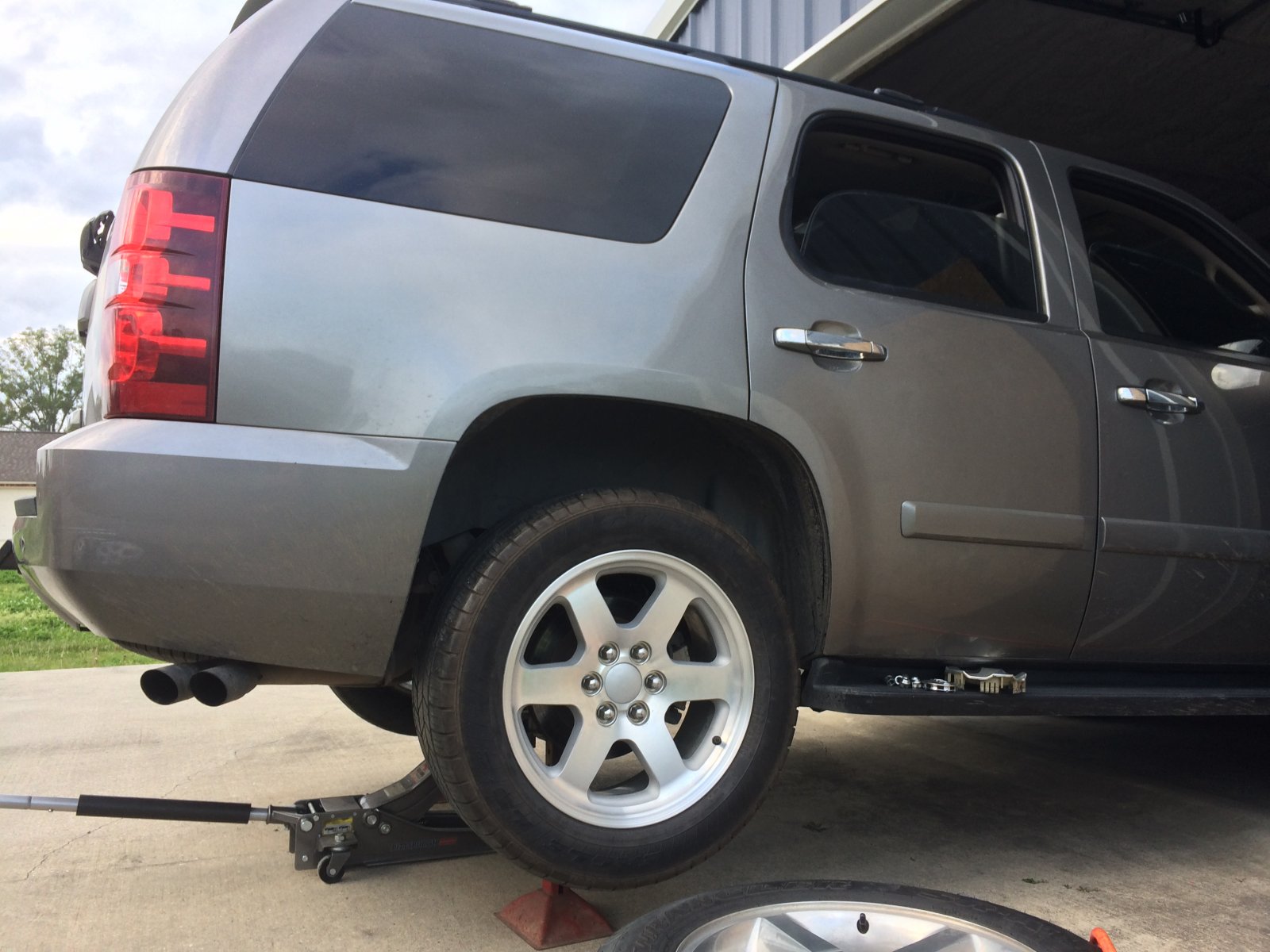

Used it as a "lathe" to turn the de-clads while I ground down some gruddiness on the lips and improved some curb rash. Idling in gear wasn't fast enough to keep the LSD from locking and unlocking so frequently, so I unplugged the speed sensor and set some bricks on the pedal.

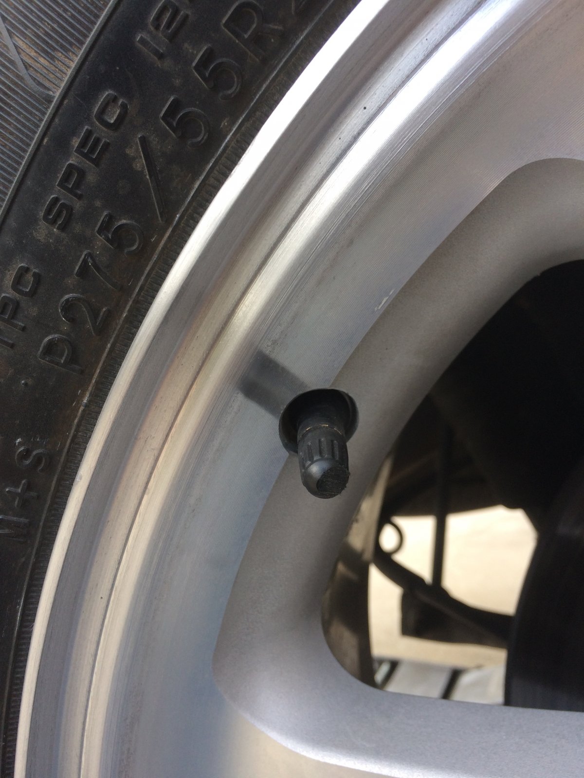

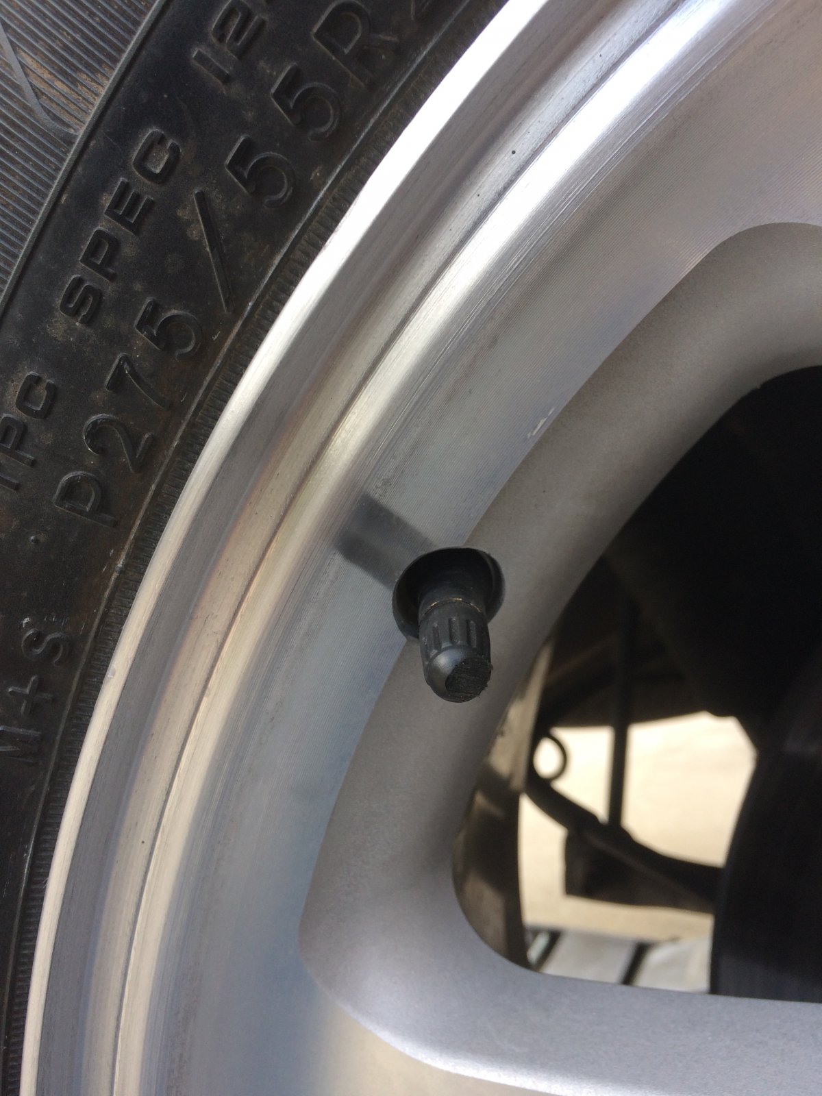

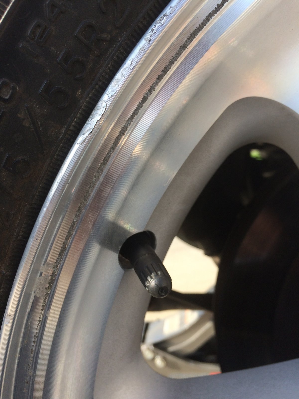

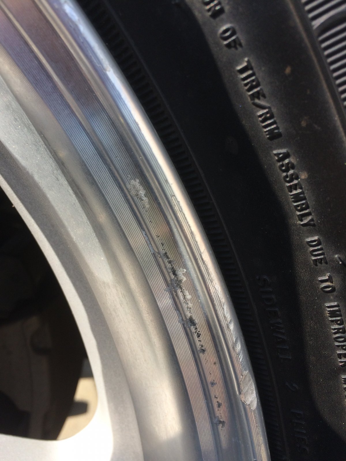

This roughness/pitting/whatever is something left behind from the manufacturing. The PO of the wheels had a few light curb rashes I wanted to minimize as well:

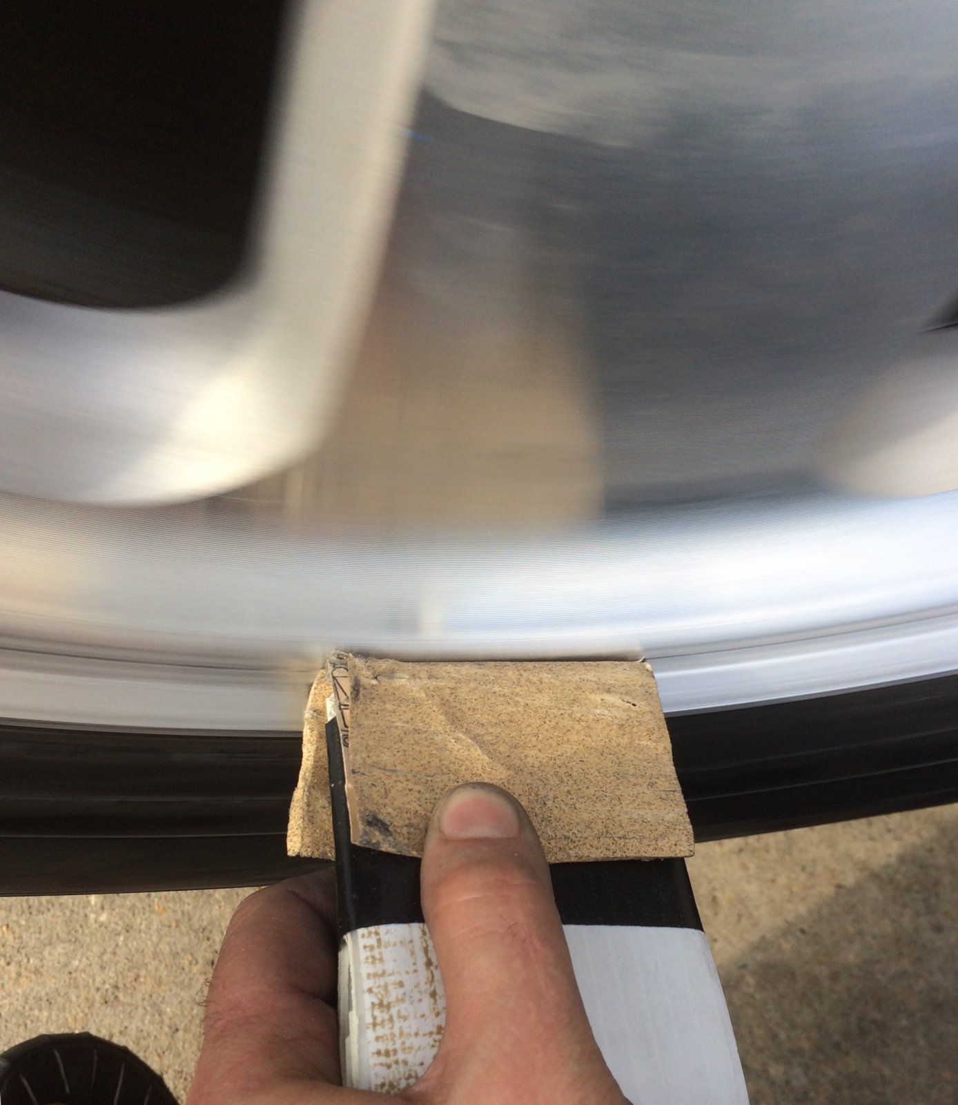

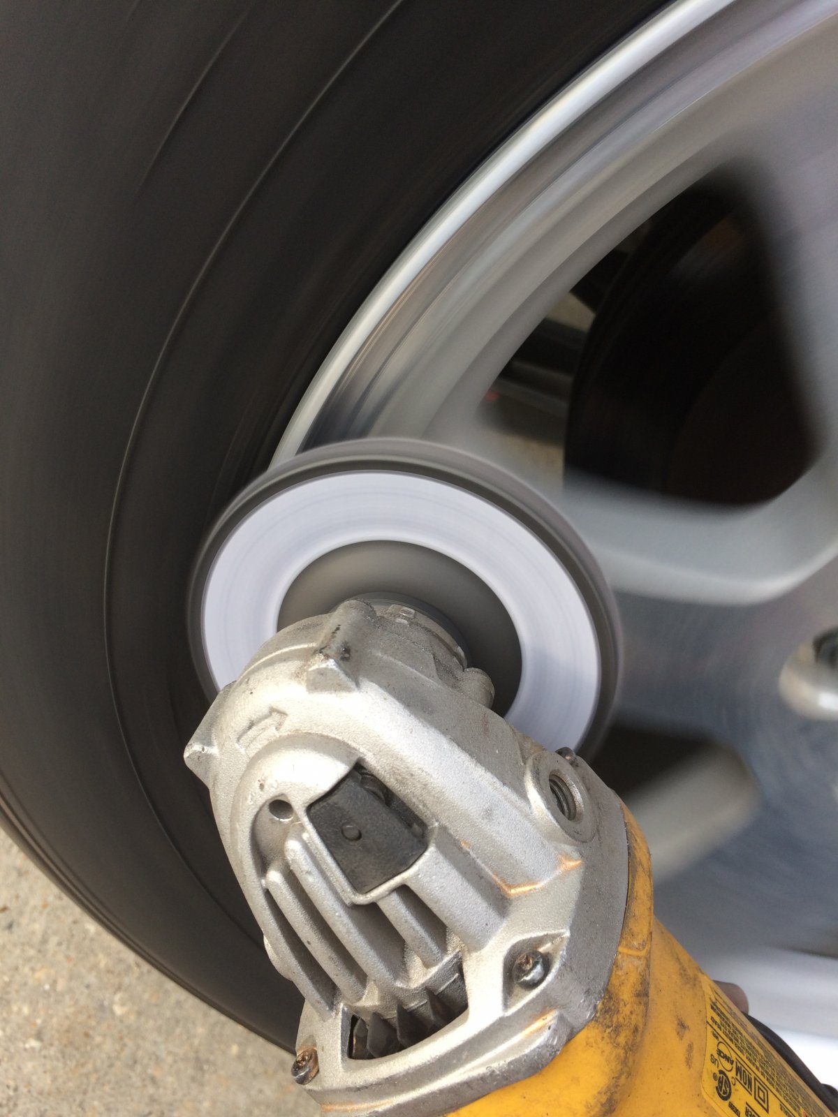

With the wheel spinning, I used a fresh flap disc on the grinder to smooth out the pitting and rash:

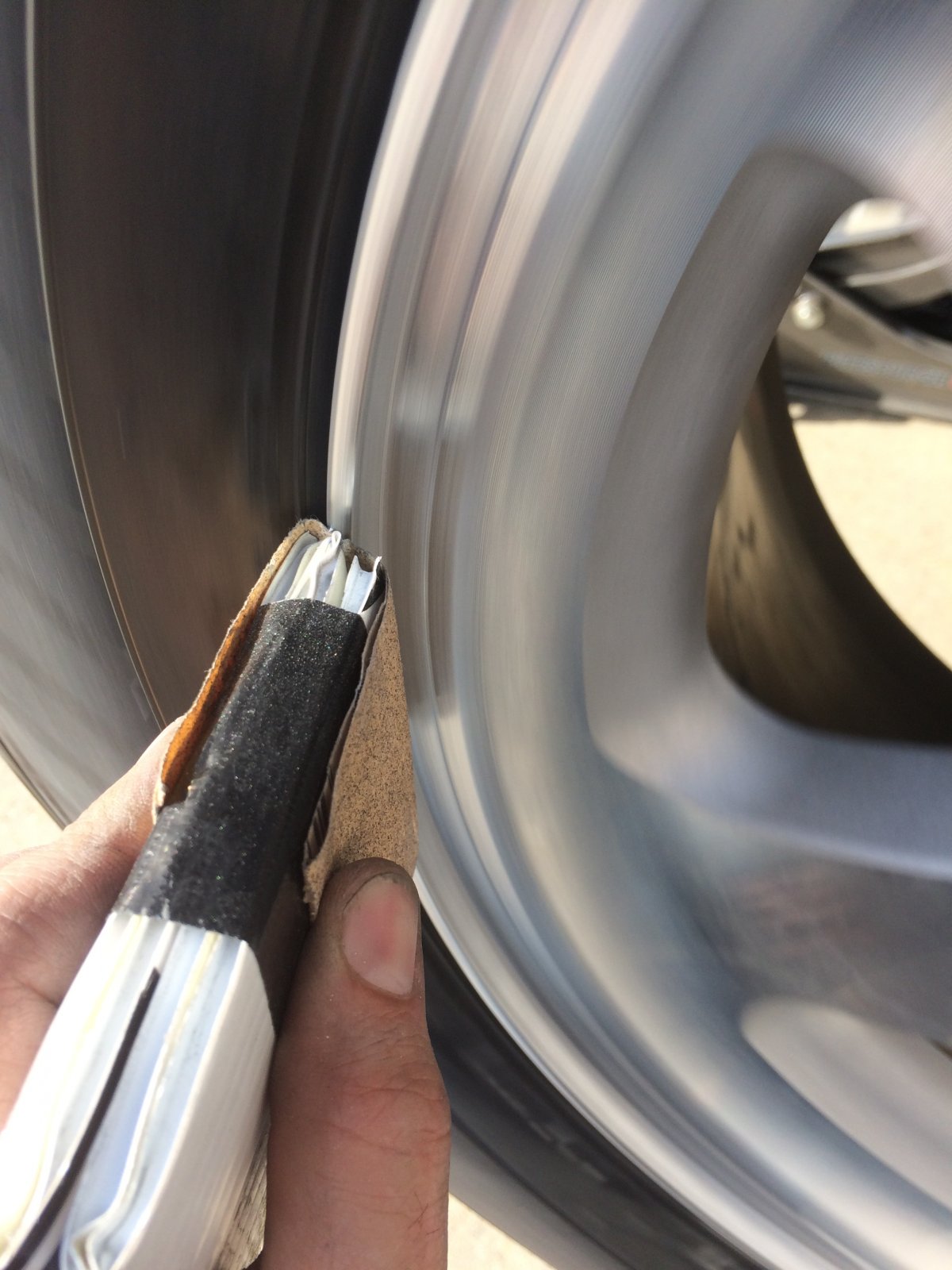

Then I wrapped 100-grit sandpaper around a folded piece of corrugated plastic yard sign to have a semi-firm sanding block that would provide a sharp edge as well as give enough to conform to the inside and outside corners of the lip:
45,014

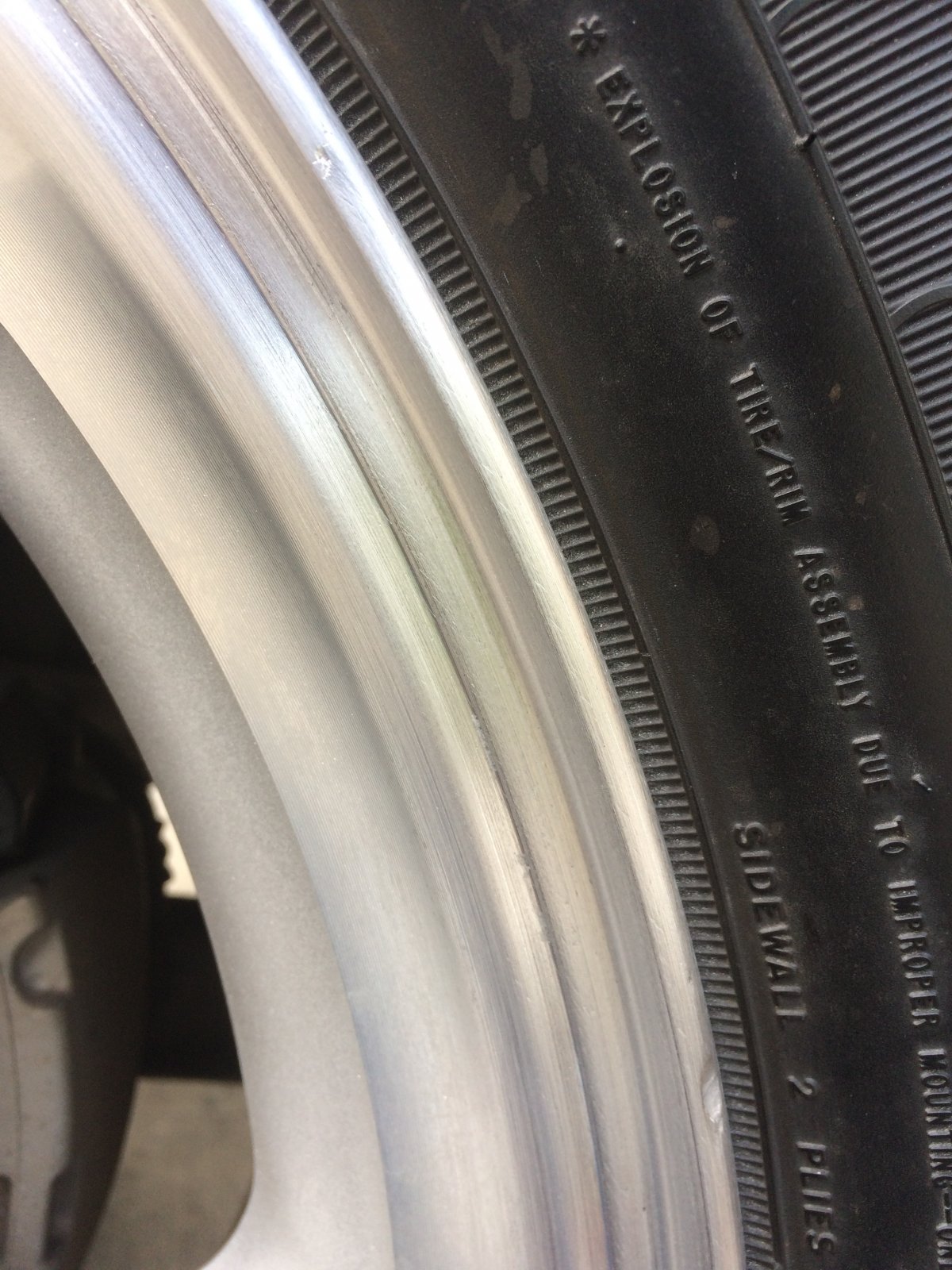

Results:
I could've sanded it a little more and even polished it. But, I was focusing on the pitting and rash since I was pressed for time and still had the other three to do. I may work on 'em a little more before I paint 'em.

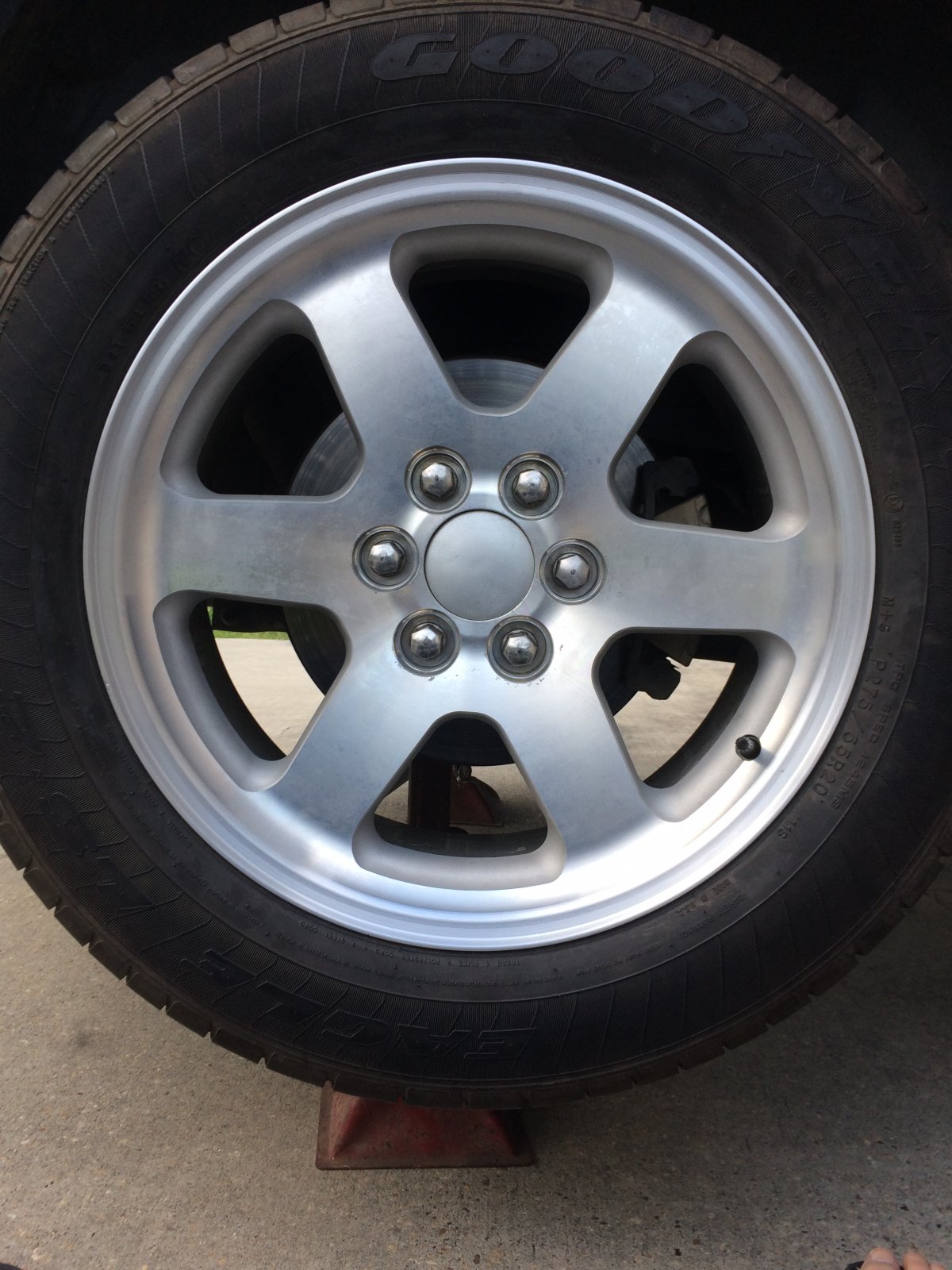

I sprayed the center cap I shaved and smoothed last weekend with some silver paint I had on the shelf and set it in place to get a better visual. It doesn't snap in place so I took it out before going for a test drive.
I'm gonna sand the lug nuts to give 'em a brushed look to better match the wheels.

Used it as a "lathe" to turn the de-clads while I ground down some gruddiness on the lips and a improved some curb rash. Idling in gear wasn't fast enough to keep the LSD from locking and unlocking so frequently, so I unplugged the speed sensor and set some bricks on the pedal.
***** awesome man! :):cheers:

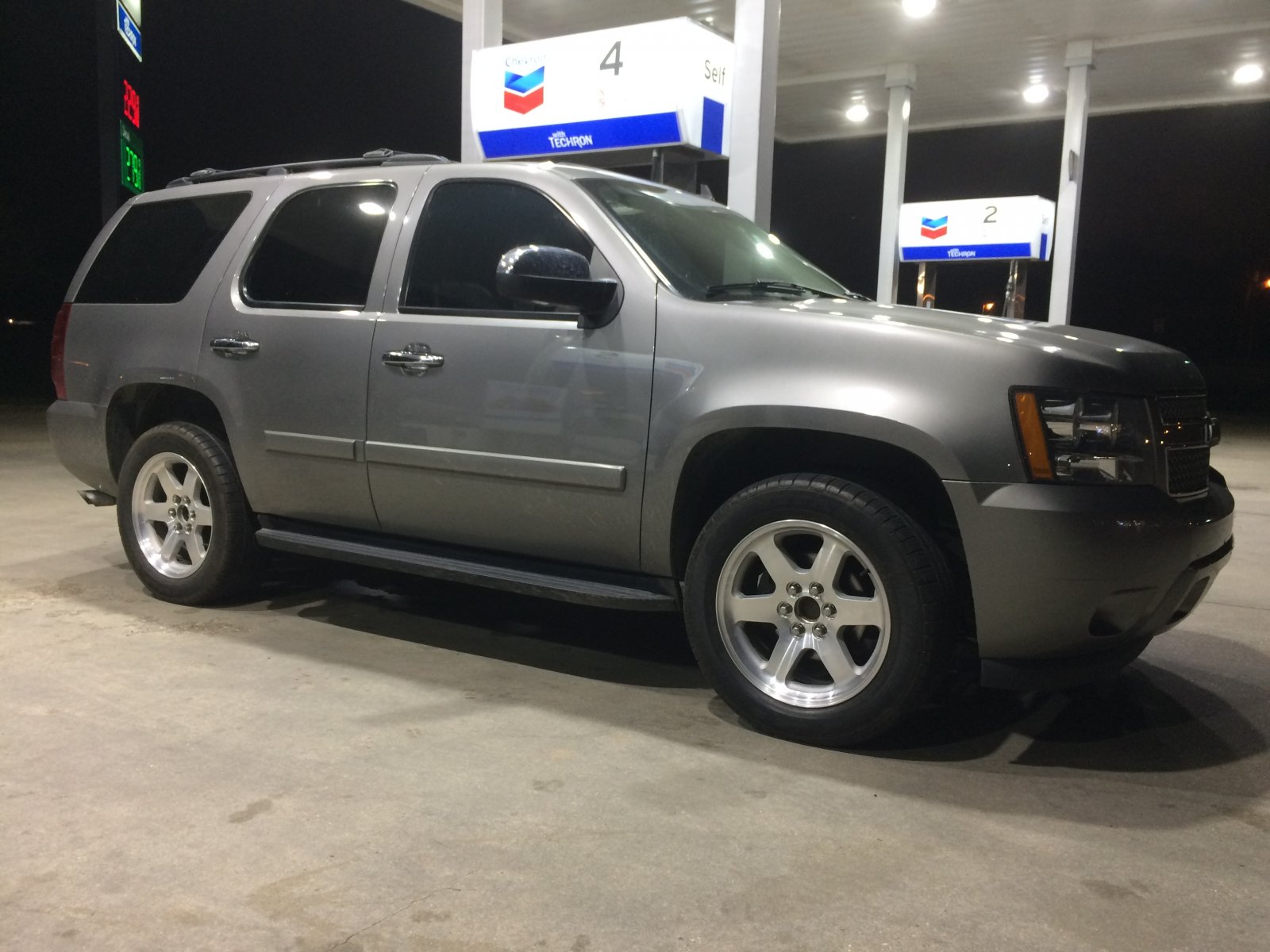

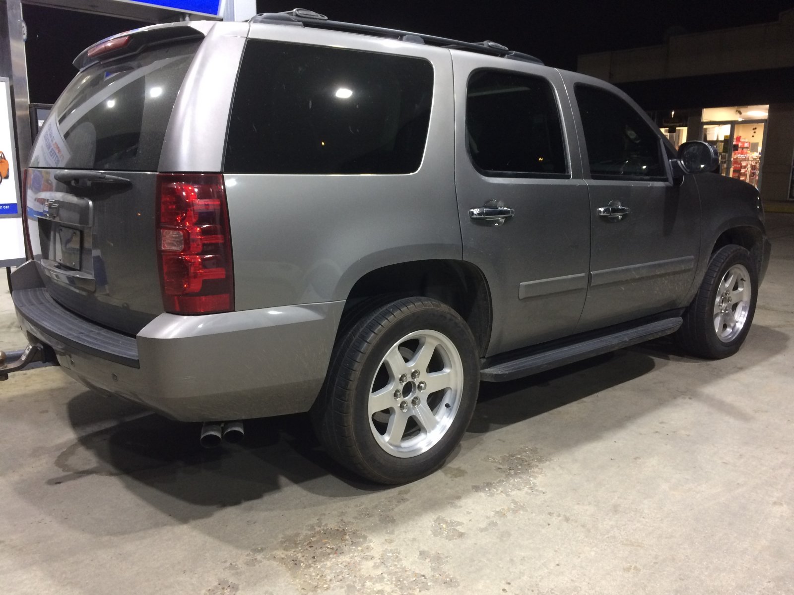

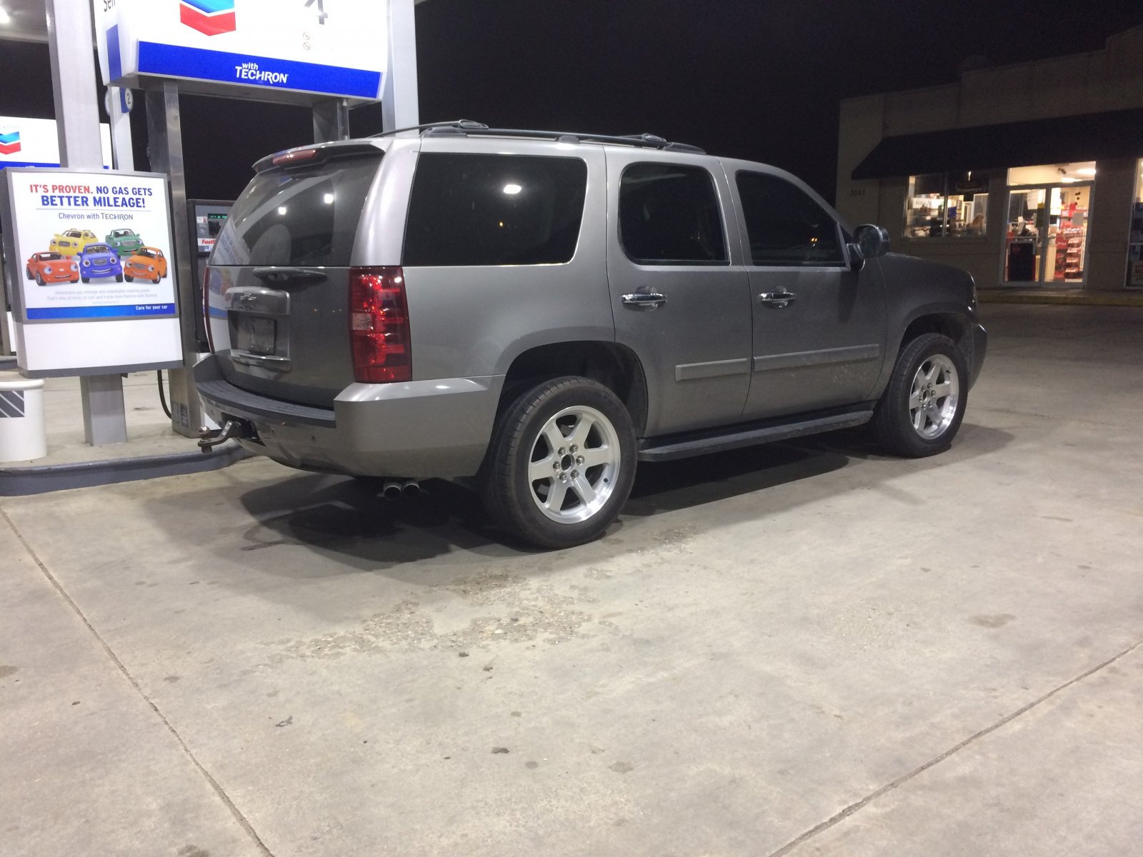

Went for a test drive to see how they felt and to fill up the tank. I snapped these as the $75 of 93 octane poured in.:( The lack of center caps really roughs up the appearance. I'm hoping to have the caps in by this weekend and I hope I can figure out an easy way to make them snap in place. A sizeable drop and de-chroming the body (all planned and coming) would make this style of wheel look more befitting cuz it's currently like wearing running shoes with a tuxedo. But, here's how it sits for now:

Looking good :)

Results:
They came out amazing. Great job, especially with the rolling lathe idea!
You could always use a dab of silicone to hold the caps on. I used it on mine and they held great.
45,014
They look better than I thought they would. Nice job buddy. I honestly didn't notice the caps missing until I reread the post
Thanks, man! I try to look at them and not see the hub holes, but they just demand attention. They look like racing wheels you'd see on a sport compact. I just thought of a simple step I wish I would've thought of yesterday: Use that silver paint I had for the center cap to paint the hubs while I had the wheels off. :doh2:
Thank ya! I'm lazy so I try to let anything with a motor do my motion work. You know I thought of your silicone idea at least a dozen times as I kept dropping the center cap in the hole! On that note, I just had another idea that may be a winner: Trim out the center part of the chrome cladding so it's like a hubcentric ring and epoxy it in the hub bore of the wheel so any stock center cap will snap in just like stock. I may just have to recess it a few millimeters so the cap sits flush against the wheel since the thickness of the cladding is no longer there. Now I'm kinda pissed that I threw away the one I melted during experimenting. Again- :doh2:
