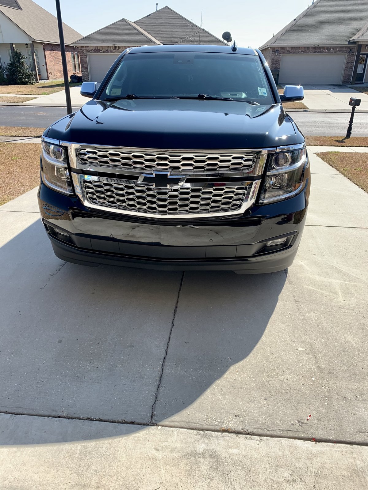

I found a grill on Amazon for my 2016 LT. It just snaps on over the stock grill. Literally took 2 minutes to install and it looks awesome.
