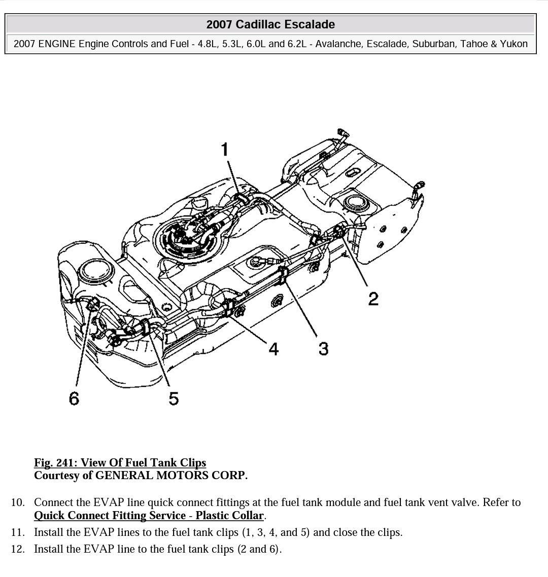

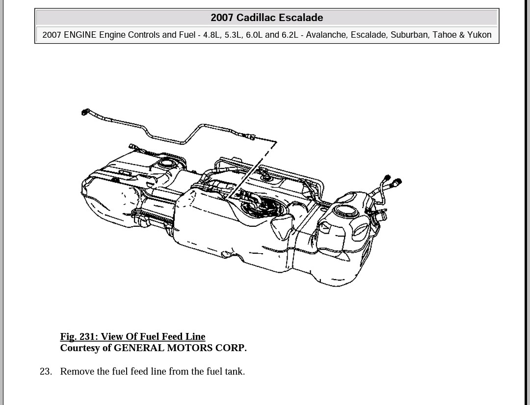

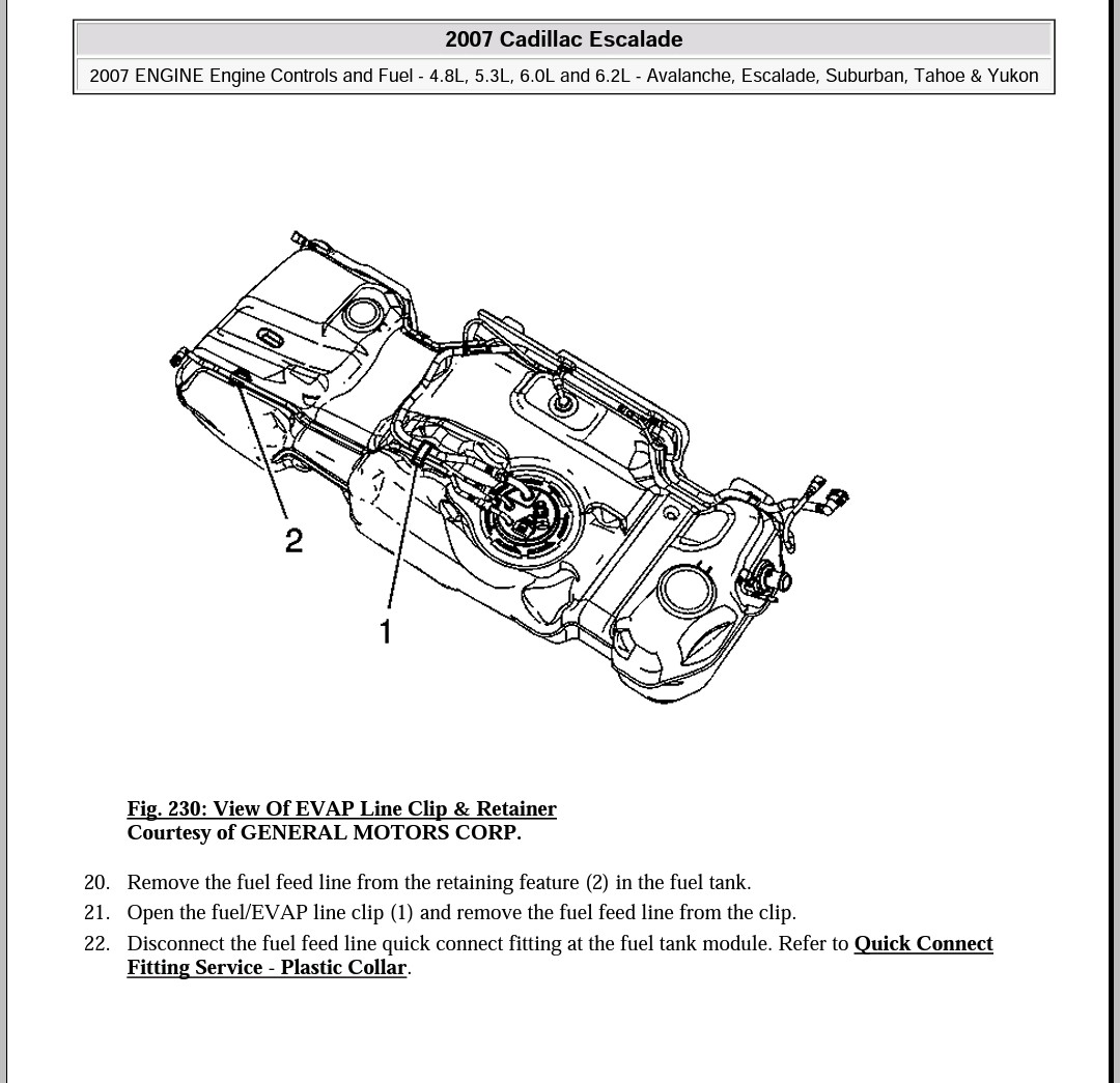

This is all I could find...
I didn't see a check valve mentioned.
