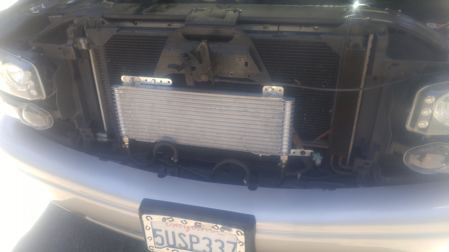

I wasn't aware the rams had a stock trans cooler that year. I just know what excessive heat does to transmissions, especially gms. I just dealt with a trans rebuild in the spring and it was hell. Towing is ******* your transmission. An upgraded cooler is defintely a good idea. Anyways just my :2cents:
Here's apicof the cooler just had put in last week.

I appreciate it... but like I was saying time is not on the table.

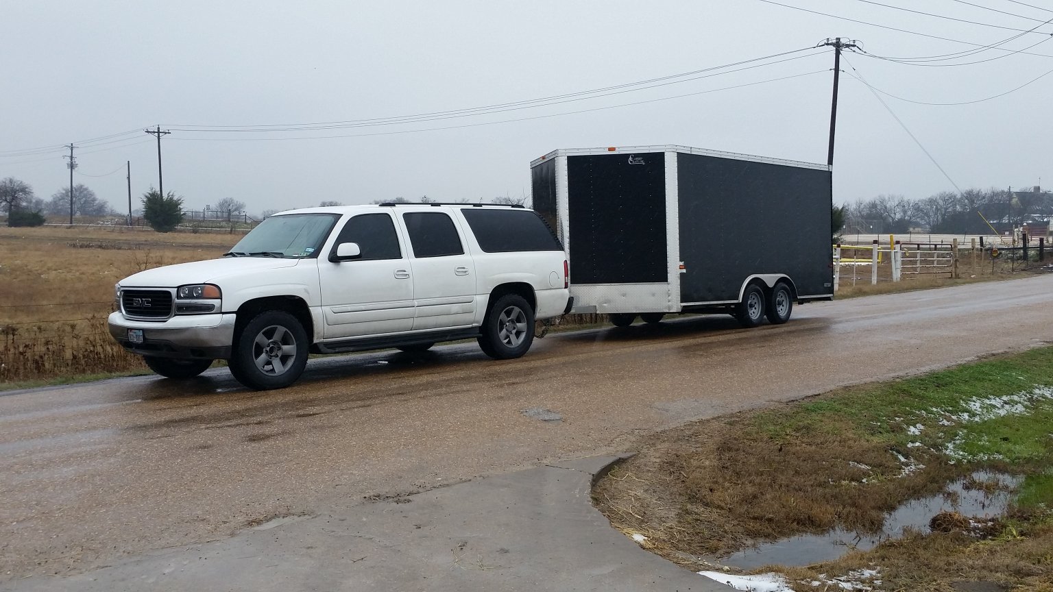

Can it tow it? Yes absolutely... is it gonna be fun? Hell no. Your going to be down shifting left and right and struggling up every hill.
I towed a 20 ft enclosed with mine and it sucked on the highway. Just a big wind drag.

Maybe the one I towed was built better or something. All I know was it was heavy... the weight wasn't the problem though. Around town and city driving had no problem towing the trailer. But on the highway at 75 mph I might as well just left it in 3rd gear. Or slow down to 50 or so going up hills.
Yes I understand your have a 6.0 and I have a 5.3... but I used to have a sierra with the 6.0 and while it towed better, it wasn't that much better...
