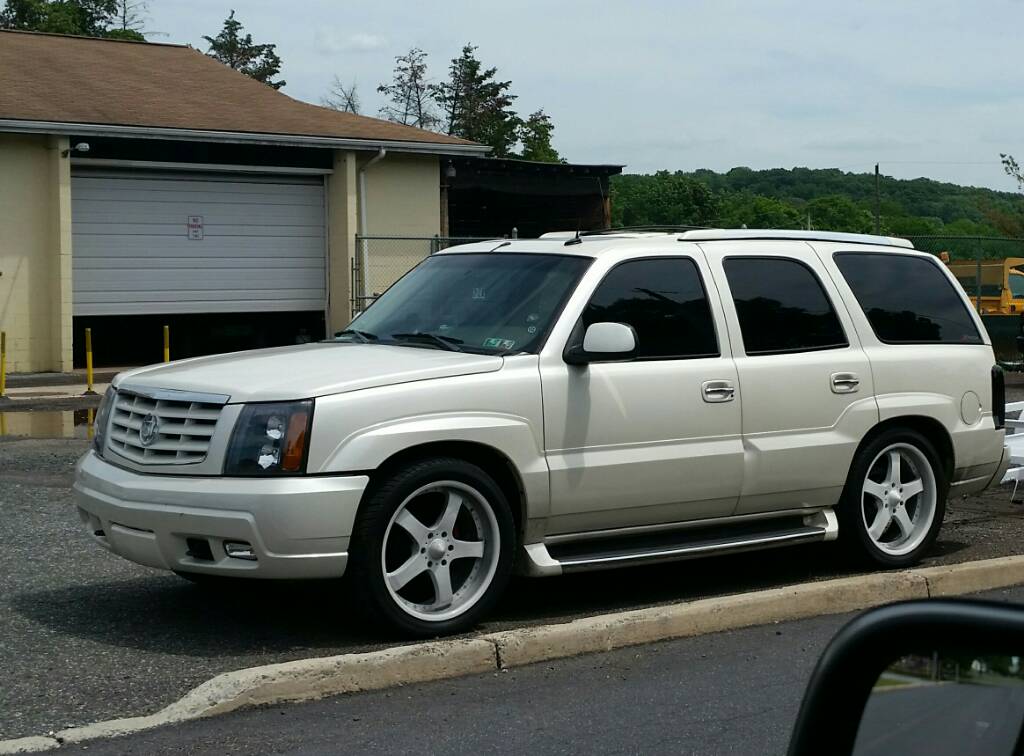

In 13 days I will be taking a road trip to the LTX SHOOTOUT. I will be borrowing a friends 26' trailer to haul my TA down...
Im no stranger to towinf, however I have not done it with my 2002 AWD 6.0 esky yet .
The truck has been lowered, however still has the air ride functioning in the rear. Im assuming when I hook up to the trailer that will sense the extra weight and lift the caddys ass back up as if it were normal height.
Am I missing anything? Is there anything I should know about towing with a lowered esky on 22s.

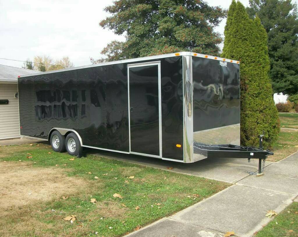

This is the trailer.

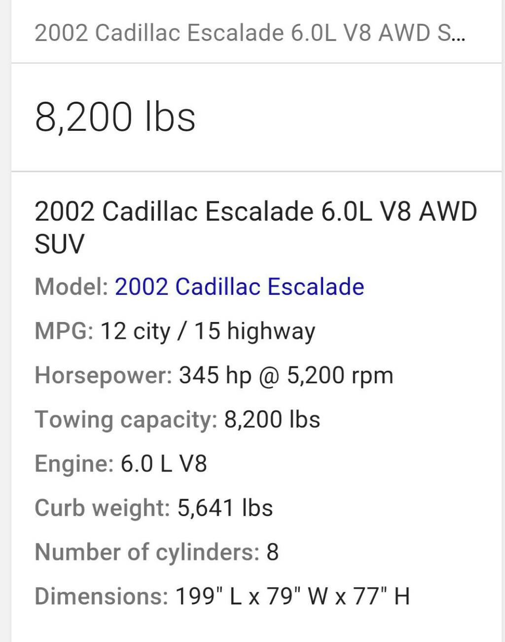

Ok. Just found the trailer was putchased with the bars but they were never installed. So the mounting points were never drilled into the trailer "neck" because they never needed em and they have used it alot.
This is a pic of the trailer on their 1500, loaded.
