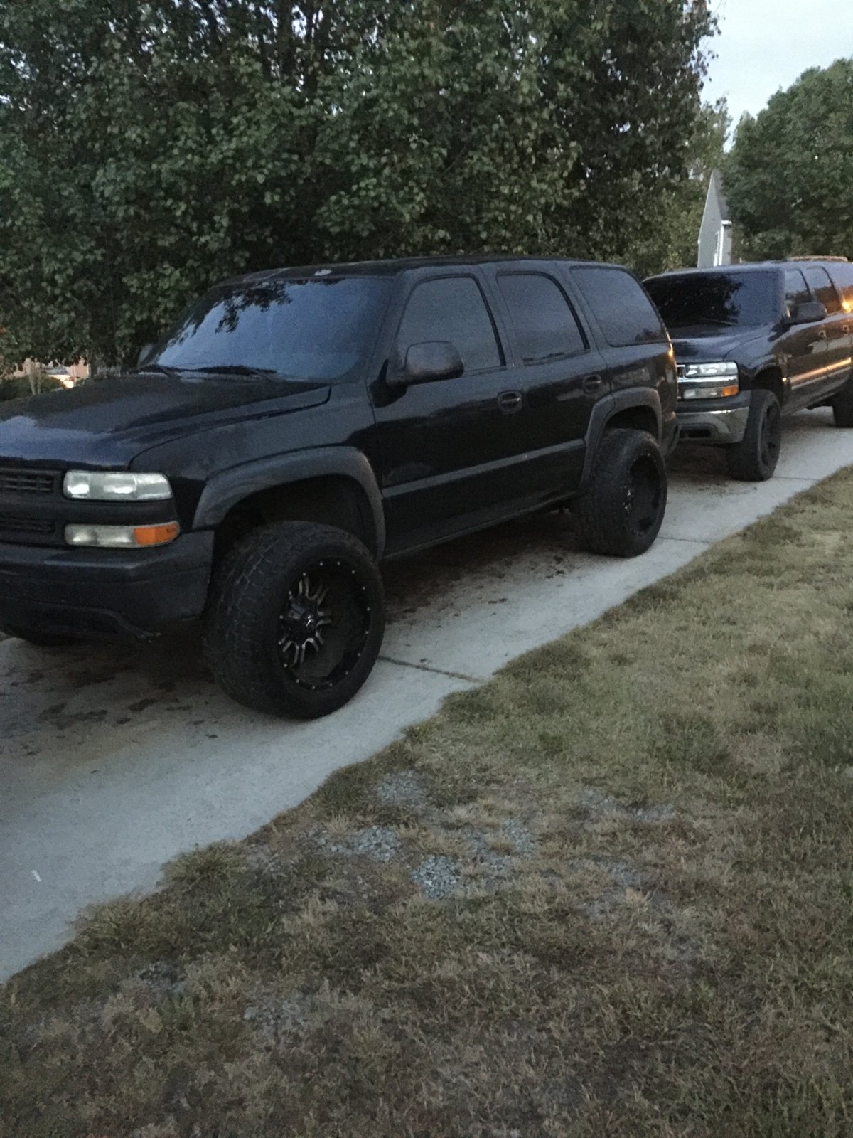

Any info on coil over parts? Finally took a pic a few mins ago after all this time. Online is reserved to my phone and work lately. Right now as she sits with no front shocks lol. Haven't drove it much lately. It's getting ready for new paint, coil overs, and turbo.
6.0Ho, 4l80e, 3200stall, 4.56 gears, 20x12 305 55 20s, 3" spindle and 1.5" rear spacer. No rubbing with extreme NorCal mods Plus some tricks in the right places. Got rid of all the lift kit weight and 35s!! Still lifted and more inline for future performance plans.
The Beast Hoe
Notice my baby Burb in the back still appears taller as its 4wd, leveled on 22s.
