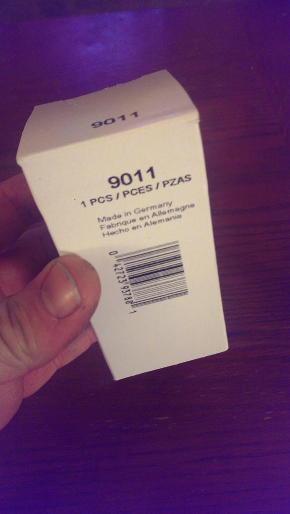

if you say so. I dont get why they would advertise them as wagner then.
I have them installed for months in my Denali.
"Wagner" HIR 9011's in the left and 9005's (1700LM, the Jeep lows are 9006 @ 1000LM) on the right, in my crappy 2003 halogen projectors
I certainly understand the skepticism, as I reacted the same way. :cheers2:
I'll bet that they purchase them in bulk packaging and sell them under the wagner name for less.

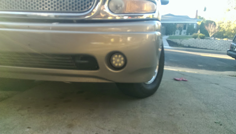

LED "fogs"

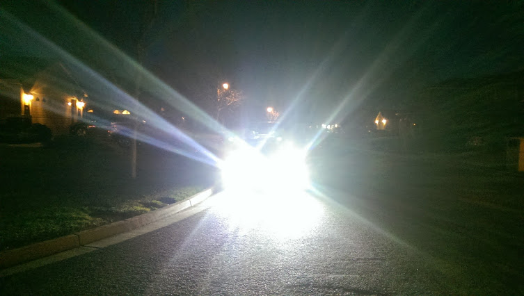

6 High (Fogs, Highs, and lows @ the same time)
6 High again:

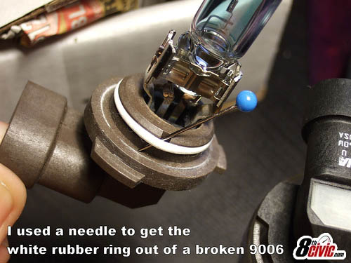

how were you guys putting the 9011's in the low beam spot... They fit loosy goossy as hell. Fit perfectly as the high beams Though.
This is what I did: (borrowed pics from another site)
http://www.8thcivic.com/forums/diy-...ulb-fit-9006-harness-increase-visibility.html
The base of the 9005 is smaller.
I used the rubber seal from the old 9006 bulb
Works great.

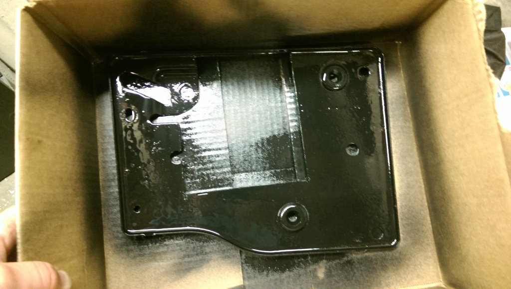

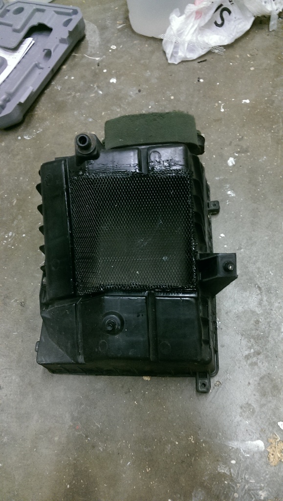

Cut out most of the bottom of the filter box, added a screen and bent it to fit in place, threw on some black silicone and a bit of black spray paint.

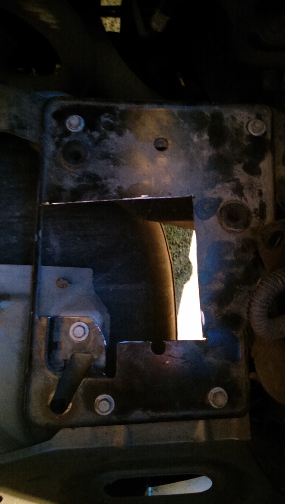

Took a look @ the bracket in place. The cuts in the bracket line up with the opening in the airbox, looks kind of haphazard here... I didn't want to cut out more than necessary.
Hit it with paint
Did it make any difference? Who knows. Maybe someday I'll hit WOT on the freeway and find out.
It cost nothing but a few minutes of my time and materials that I had laying around in the garage. Had fun with my grinder and dremel too.

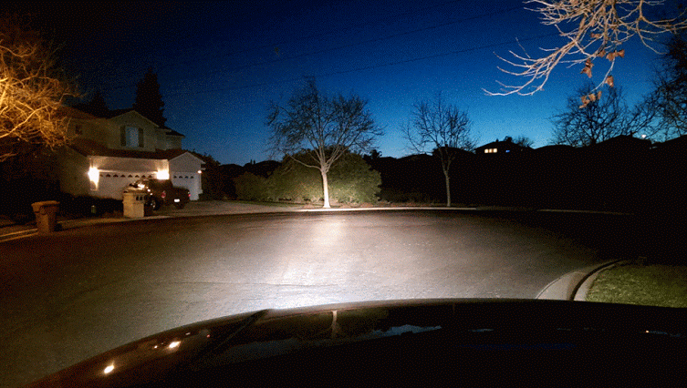

Quad FTW LOL jk

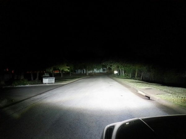

Cutoff
Low beams
Lows and highs
For reference the building is about 200ft away.
Definitely FTW. My setup isn't bad, but its very low budget. $20 HIR's and $40 in LED offroad lights + misc wire.
