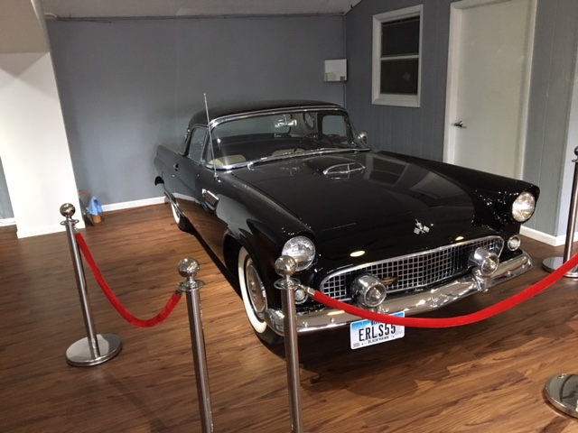

Yep, it was $150 cash. I should have tipped them, because it was a very nice shop with good people, and they will make tweaks for free. I guess I'll tip them if I want a change, but it is perfect for now. It is now my recommended shop for locals that ask where to go for good work. This T-bird was in the waiting area bigger than my house.
