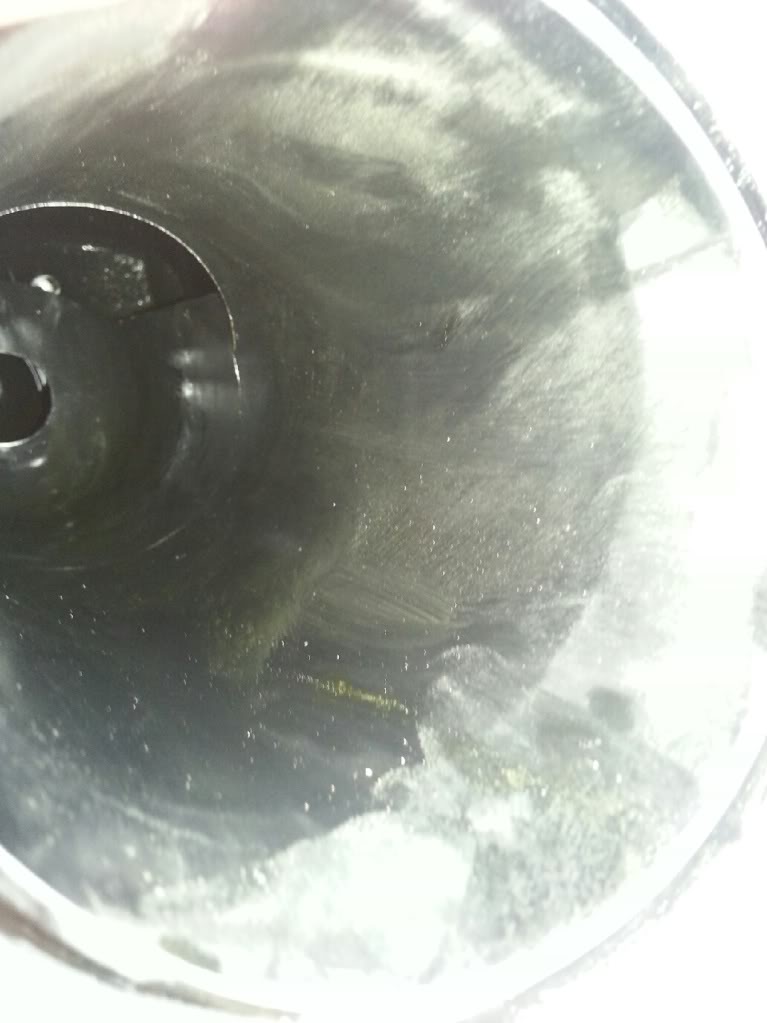

look how oily my intake was with less than 4k miles on a new truck from my ported manifold thread.
saem thing on my ctsv horrible just like on the trucks.

Oil caked on my intake manifold. I've done the lsxr manifold on a few customers trucks and all the same. Guys pop off your intake tube and open your TB plate you will see the intake looks all oiled up. I ran my finger down from inside out and it just dripped out with oil. Thats why so many people run catch cans

Your first pictures show oil with its biggest concentration near the front where the intake tube attaches. I thought then that the oil you were catching you we're preventing from getting into the intake tube and into the throttle body. How does the oil male it past the PVC on top?
