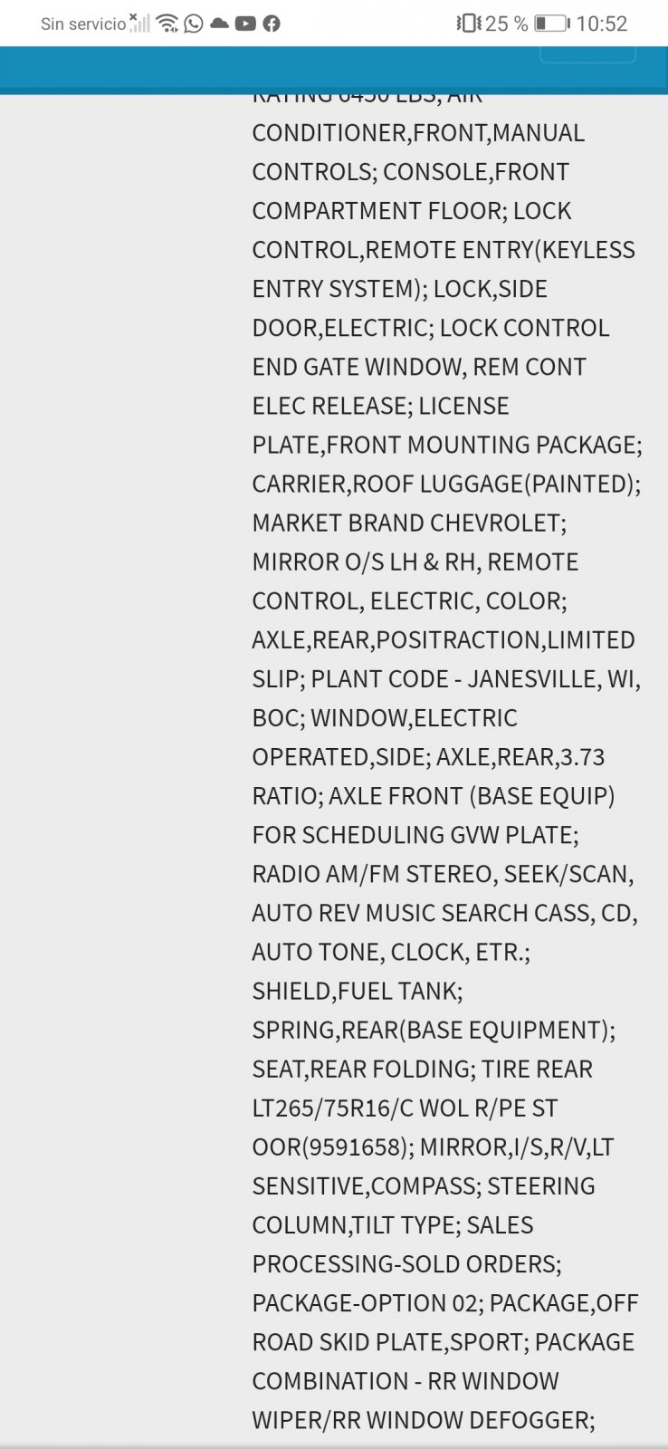

Hi, I have this, but no idea what gear I have
IMG_20200725_215842.jpg the truck is a tahoe k1500 diesel 1995

Your diesel is rpm limited, with gas you get 6K rpm. Stay with 373's or drop 20 percent rpm to 308's but it will be really slow accelerating. I think you have around 170 HP.
