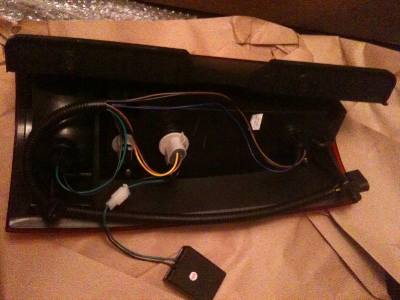

I just got my G4 tails yesterday but I am a little confused on how to install the 6ohm 2 bulb load resistor I got from v-leds.
http://www.v-leds.com/BlinkerWarning-Fix/Turn-Signal-Fix/6-OHM-50W-2-BULB-LED-p4783296-1-2.html
It looks like the G4 already has a load resistor. I think it is that little black box that hangs off by itself (see pic). So I am wondering, do I remove that and install the 6ohm resistor? Where does the 6ohm resistor go? I read that the resistor gets hot so do I need to mount it somewhere? Thanks for your help.

The G4's all ready have the resistor, which is the black box you are looking at. You will not need another resistor. G4's are plug and play

Thanks. I thought I read on another thread that the resistors that came with the G4s weren't enough and that 6-7ohm resistors needed to be installed.
KMeloney
May 2, 2009
3,458
708
You did read that, and it's true (or, can be true). I've found that when my battery gauge reads below 14 amps, I'll get the fast blink -- and that's with the factory, black block resistors.
I, too, would like to know whether the additional resistors need to be put in-line with the factory one, or whether they replace the factory ones, and just how it's done either way.

I did not add additional resistors on my G4's and I have never had any issues. But, it can't hurt wiring them in if you all ready purchased them

I had to add a 6 ohm resistor to each for the turn signals, it comes with like 12 ohm ones and it's not enough...
Do you just tap the additional resistor directly onto where the existing resistor is? I've ran across a couple of post on this forum where people were asking about how to add the additional resistor but I don't think anyone reply to those. I'm still new at this, so any pointer would be greatly appreciated.

1. Take the resistor box that came with the lights and throw it in the garbage. If possible back over it a few times or smash it with a hammer to relieve the frustration associated with the fast blink.
2. Take the end that plugged into the resistor box and cut the plug piece off, exposing 2 wires.
3. Splice the new resistor into the 2 wires with one going to each end of the resistor.
4. Mount the resistor with double-sided tape to the taillight housing where the old one went. I know they say that it can get hot, but I've never had my blinker on long enough for it to cause any issues with melting plastic.

It is just two wires you splice together... the black wire goes with the black wire and the green wire goes with the green wire. Basically you are replacing the 10 ohm resistors with 6 ohm resistors. I have the G4 LED's and also ordered vled's 6 ohm resistors and I ended up NOT needing them at all and they are just collecting dust in my garage now. Some people however do need the resistors because of the fast blinker issue. I bought them before I even got my lights in the mail just to make sure for an easy 1 time install!
