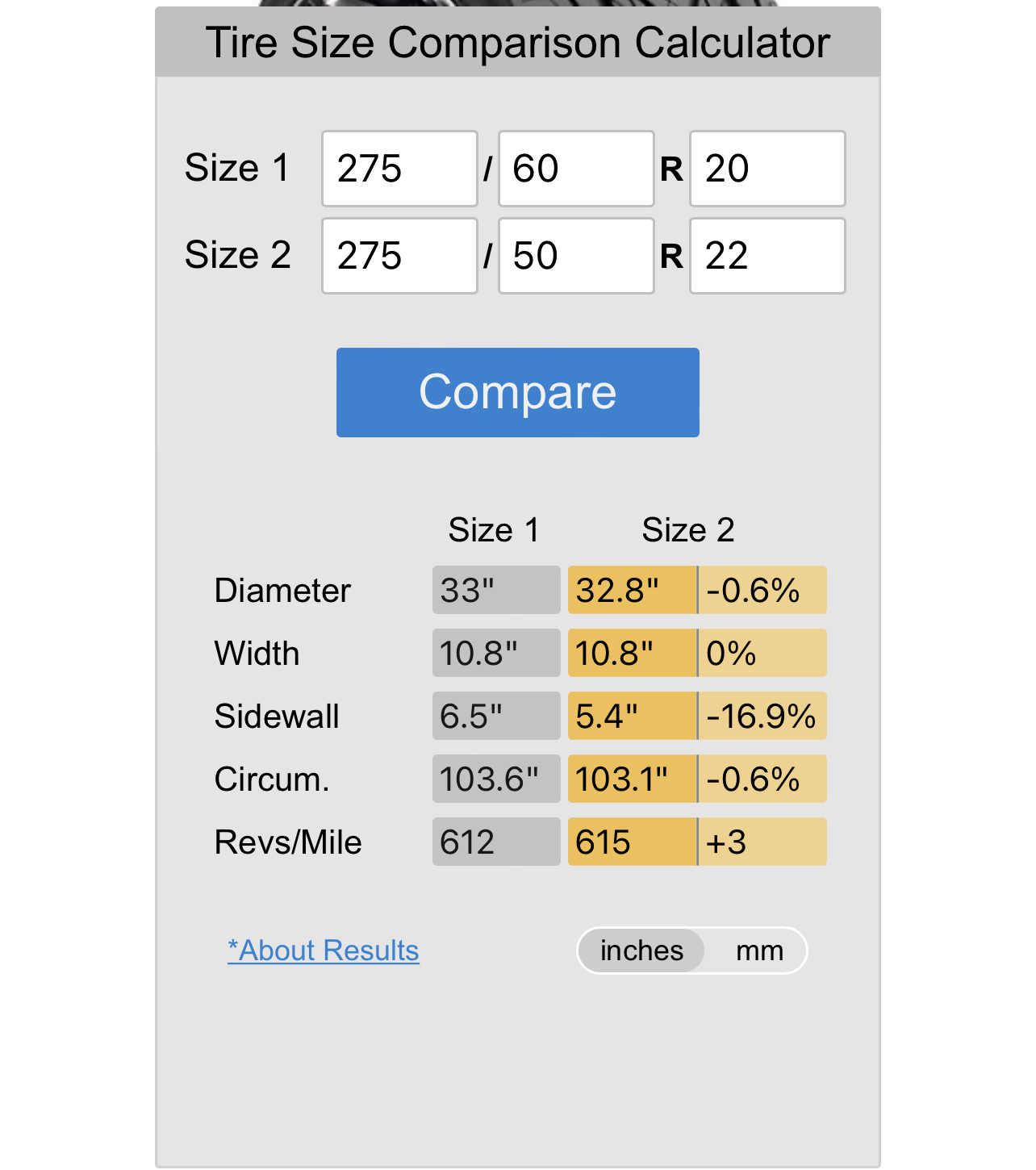

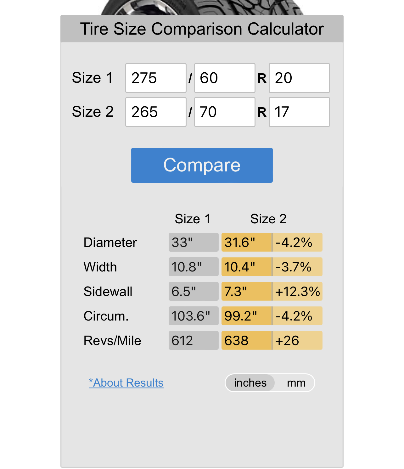

Diff between the stock 265/70R17 temporary use only spare and the stock 275/60R20 is about 1.4” diameter. I looked under my Yukon XL, seems like it would fit, as there appears to be about an inch of room all around the current spare.
I might be tempted to go with an OEM Aluminum wheel to save weight. And if you match it to your OEM rims, you could include it in the rotation and get a little more life out of your tires. The 275/50R22 is almost the same diameter as the 20” size.

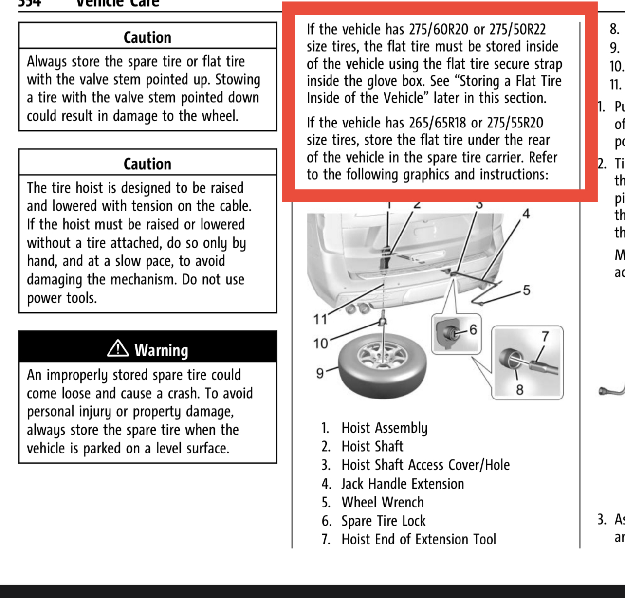

Although, pg 358 of the owners manual implies it won’t fit. See attachment:
275/55r20 is what the PPV runs which why the rumor i heard made it found like it fit. So its not the wheel that decides, its the total diameter. Boo.

Well, I've had no problems so far running full size spare tires on my 2015 Tahoe LTZ; utilizing the rear underside/winch storage area.
@WalleyeMikeIII posted pg. 358 of the owners manual, but that is states about storing a flat tire. I'm hoping this does NOT apply to an aired up spare...knock on wood. Gonna ask the dealer about the spare next time I'm in, that's for sure!

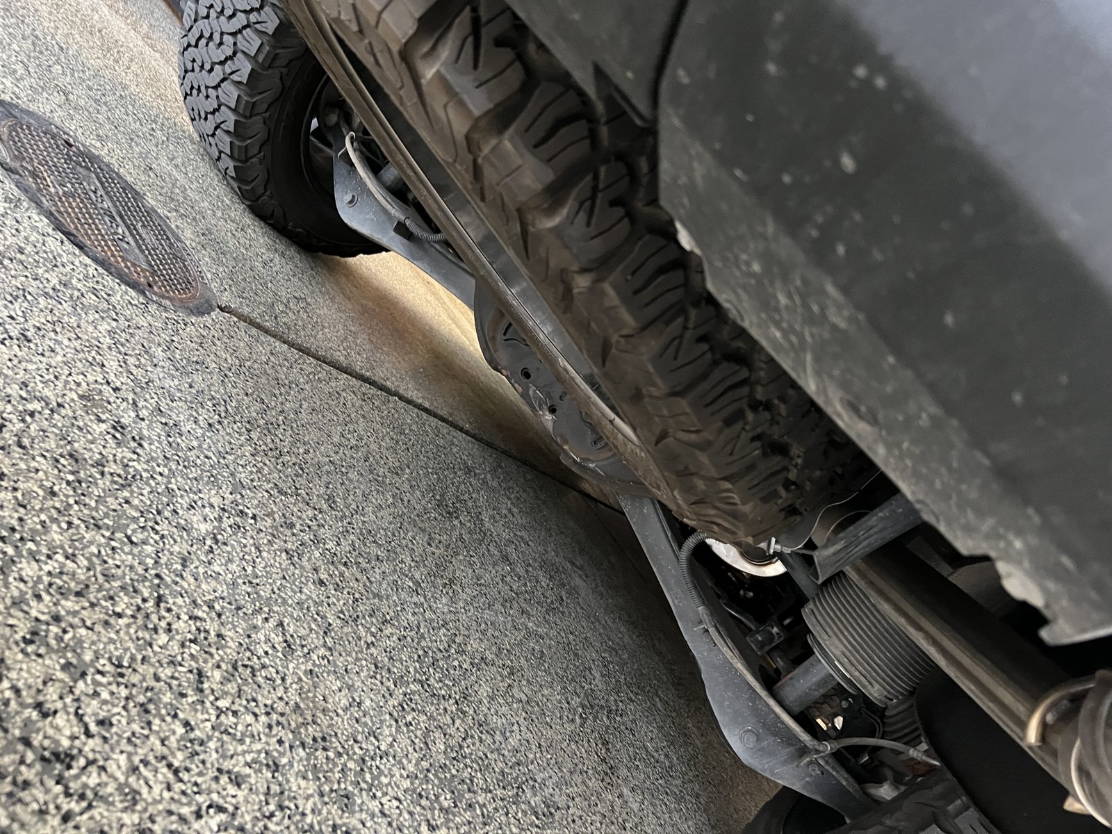

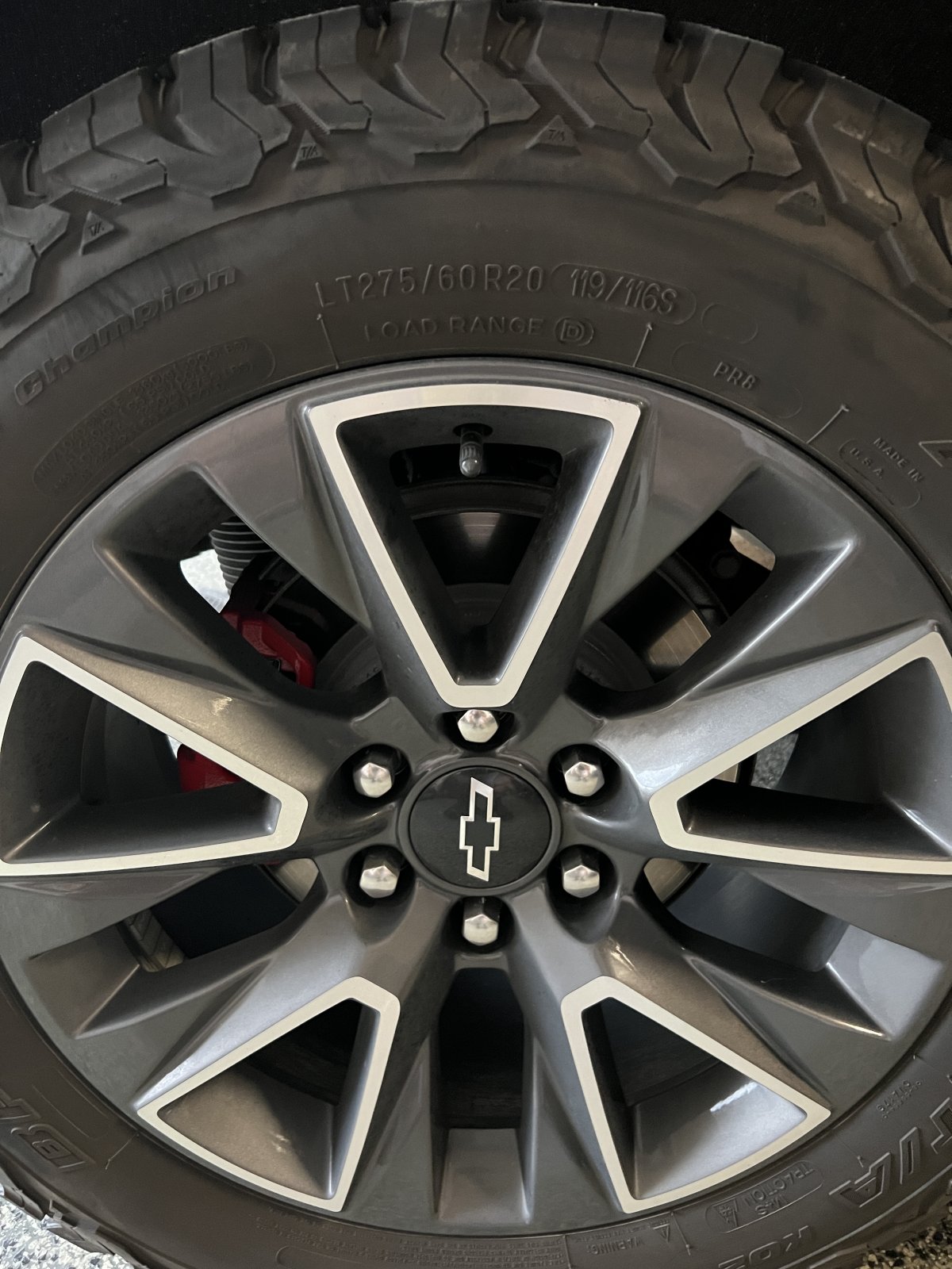

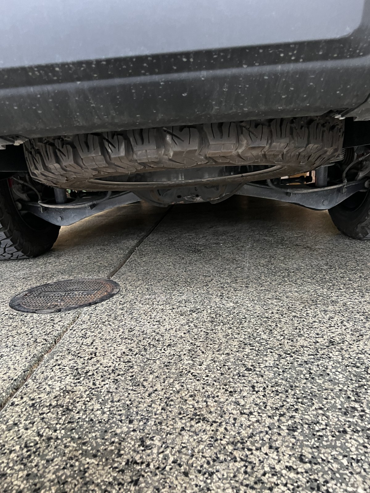

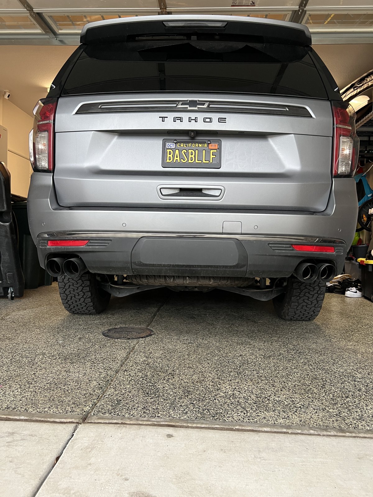

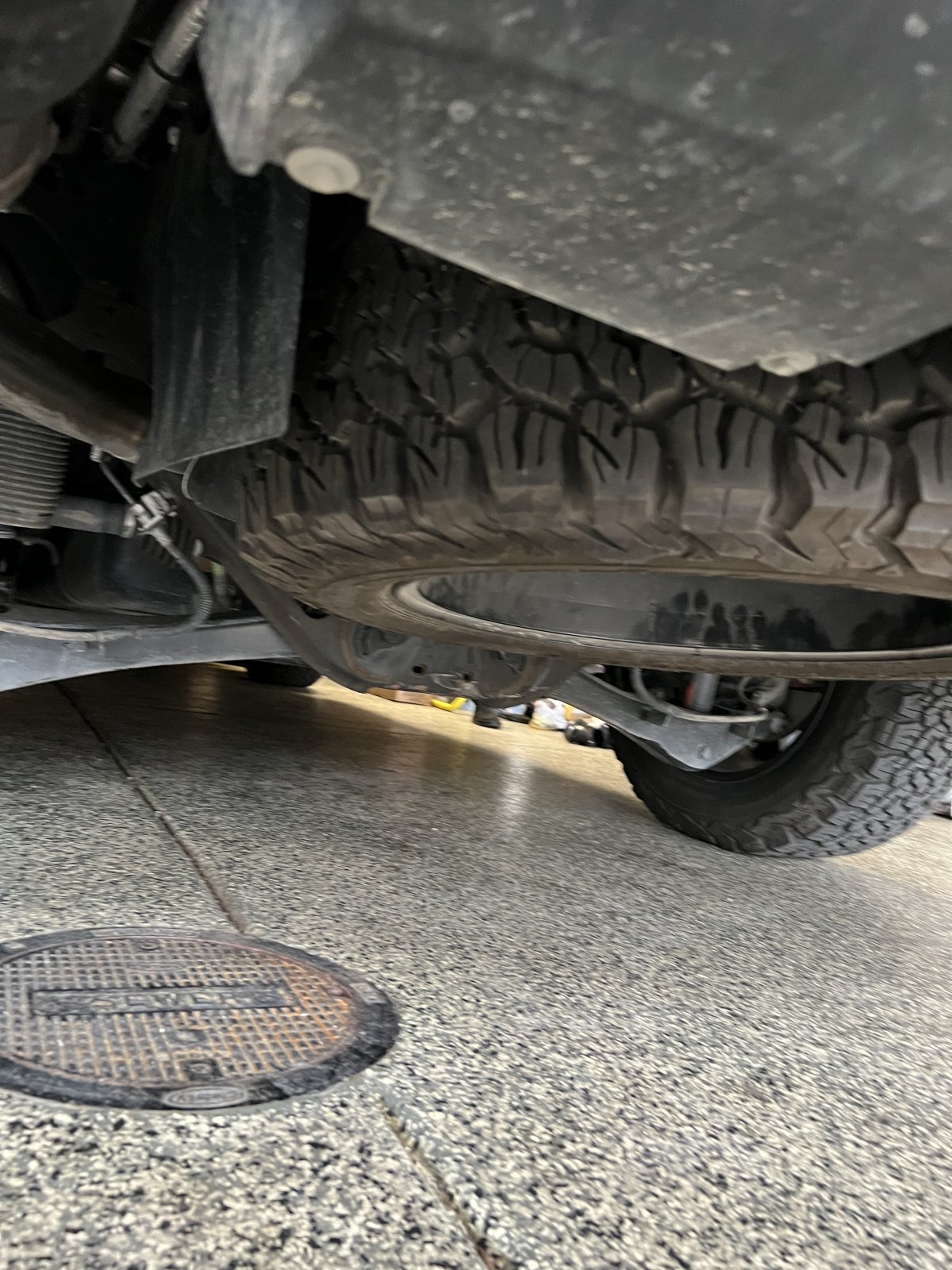

I just purchased an extra OEM Wheel with a BF Goodrich KO2 275/60/R20 and it does fit in the spare tire spot. This is on a 2022 Z71. Keep in mind, this is my family car, so the only off road it sees is a trail here and there. I’m not sure if it sits too low to do any serious off roading.

Polo08816
Aug 24, 2010
808
342
I fully expect an OEM size tire to fit in the spare tire spot.
I'm curious whether something wider and taller like a 285/60/20 would fit in that spare tire spot.
RadZ71
Aug 31, 2022
Sorry, I was answering the original poster’s question.

AliBaba
Feb 24, 2013
90
61
Seattle, WA
Thanks for sharing pictures. I honestly can’t remember the last time I needed to use a spare but I plan to get a matching for my 23’ AT4 now.
