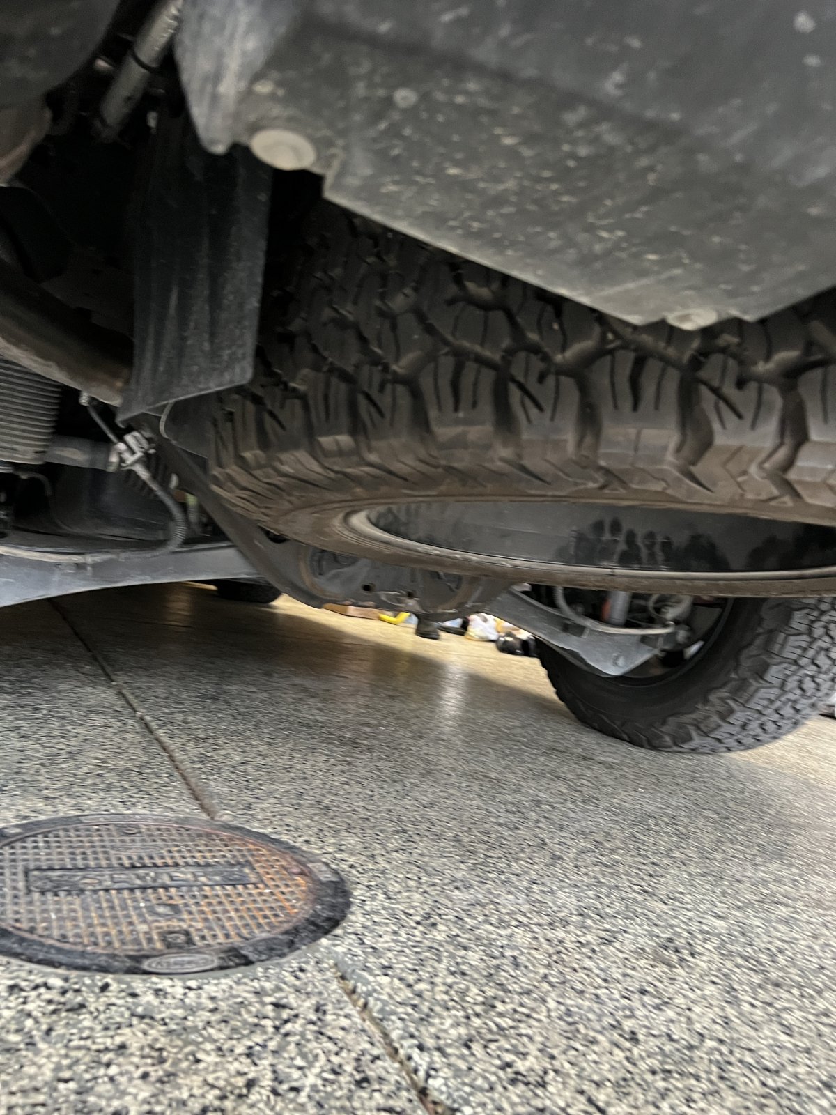

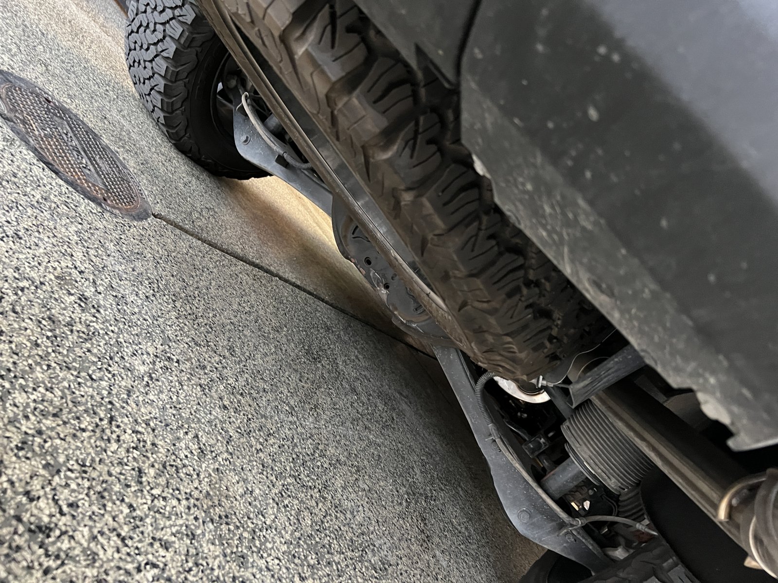

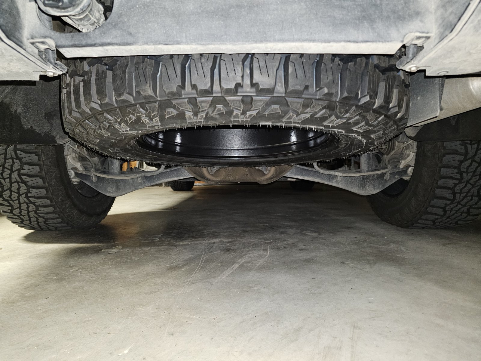

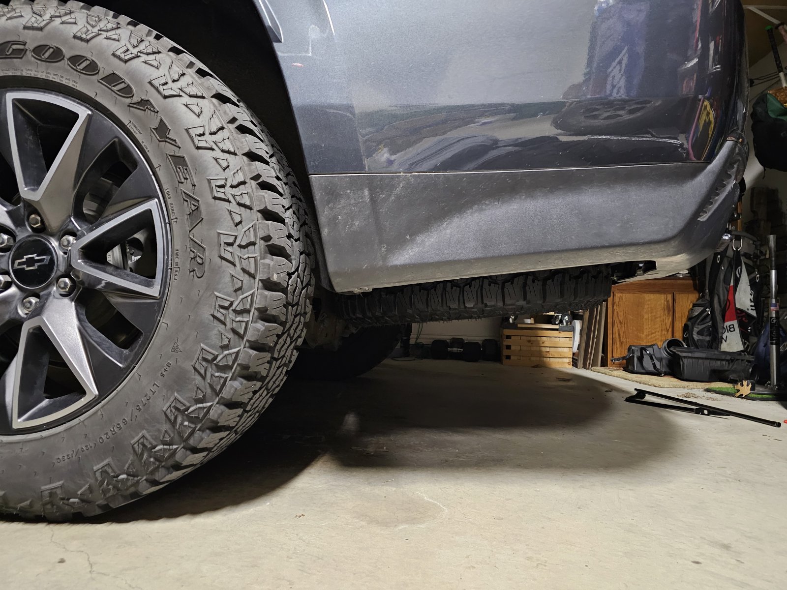

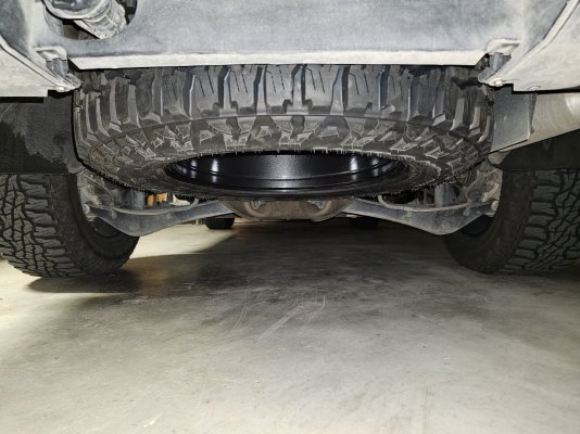

I just purchased an extra OEM Wheel with a BF Goodrich KO2 275/60/R20 and it does fit in the spare tire spot. This is on a 2022 Z71. Keep in mind, this is my family car, so the only off road it sees is a trail here and there. I’m not sure if it sits too low to do any serious off roading.
Thanks for sharing pictures. I honestly can’t remember the last time I needed to use a spare but I plan to get a matching for my 23’ AT4 now.
