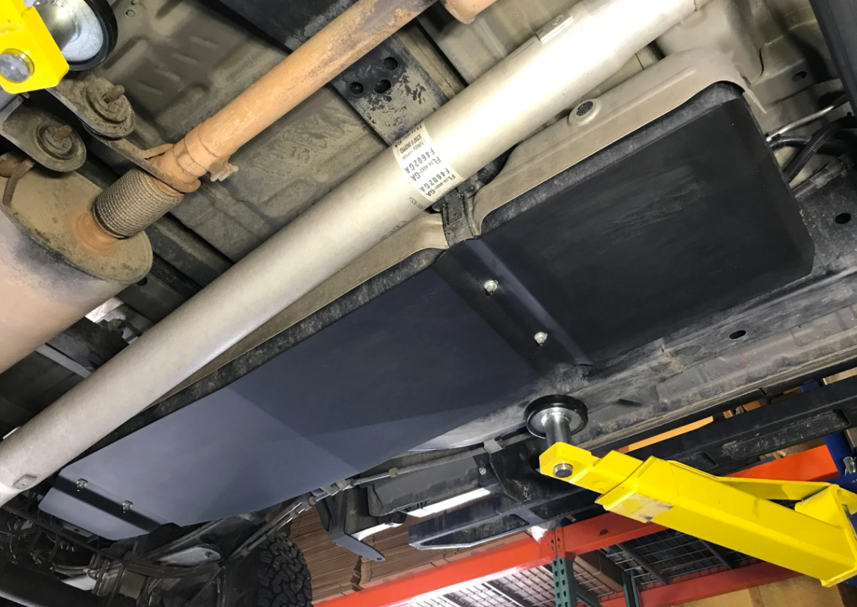

Tray style plates look like they would trap a ton of dirt.. Maybe something similar to this...

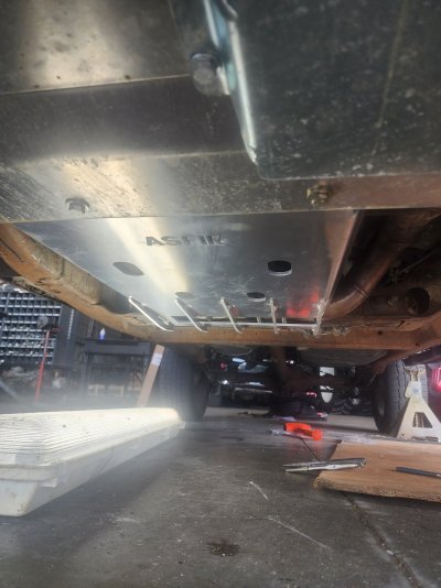

I've had no luck finding anything as well. It's surprising that Asmir doesn't offer anything considering their offerings for the rest of the underbody.

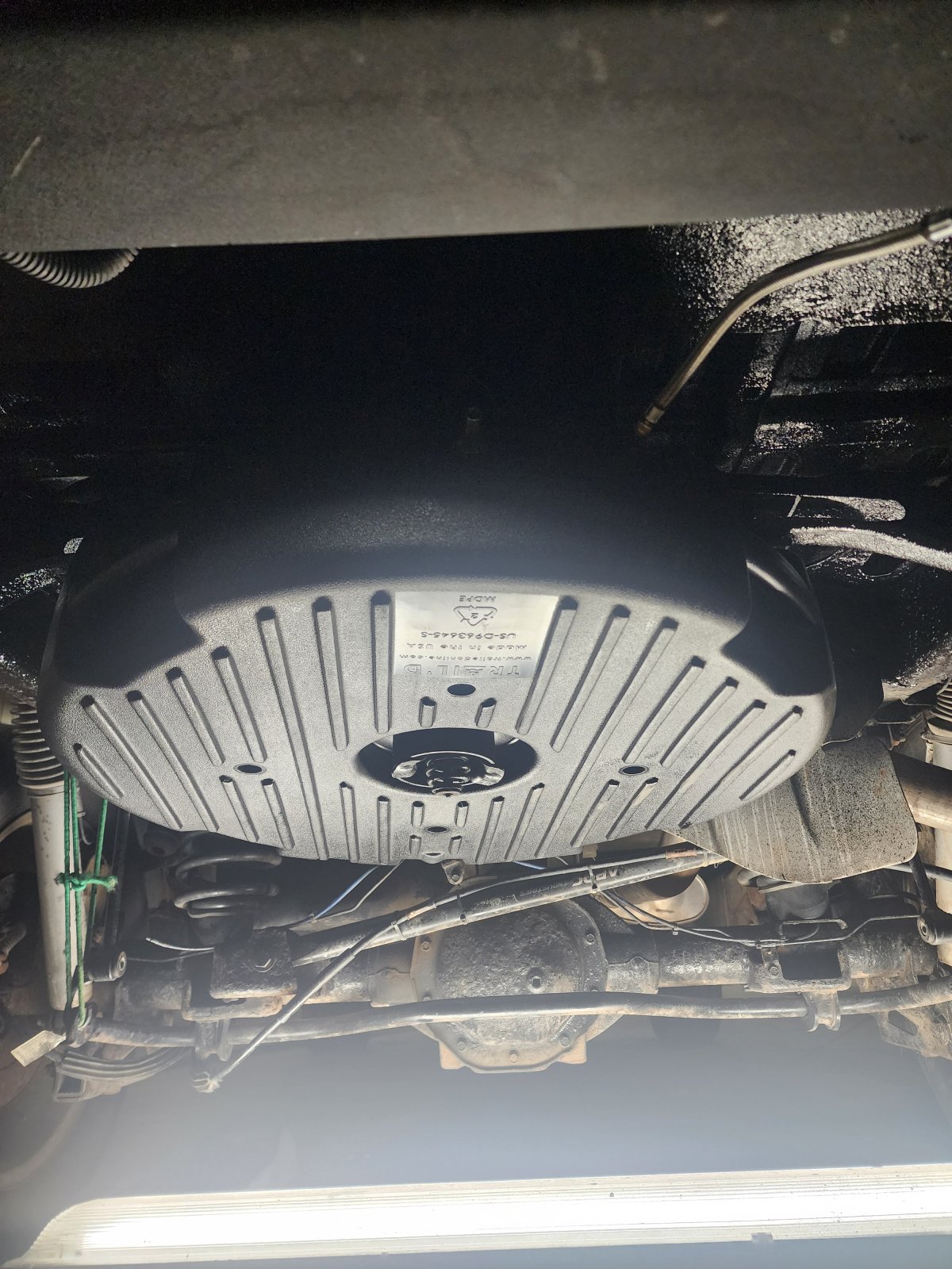

Just did a little looking, 500 give or take for a 4' by 4' sheet. Might be enough left over for the muffler area.Need to sheild my water tank as well.

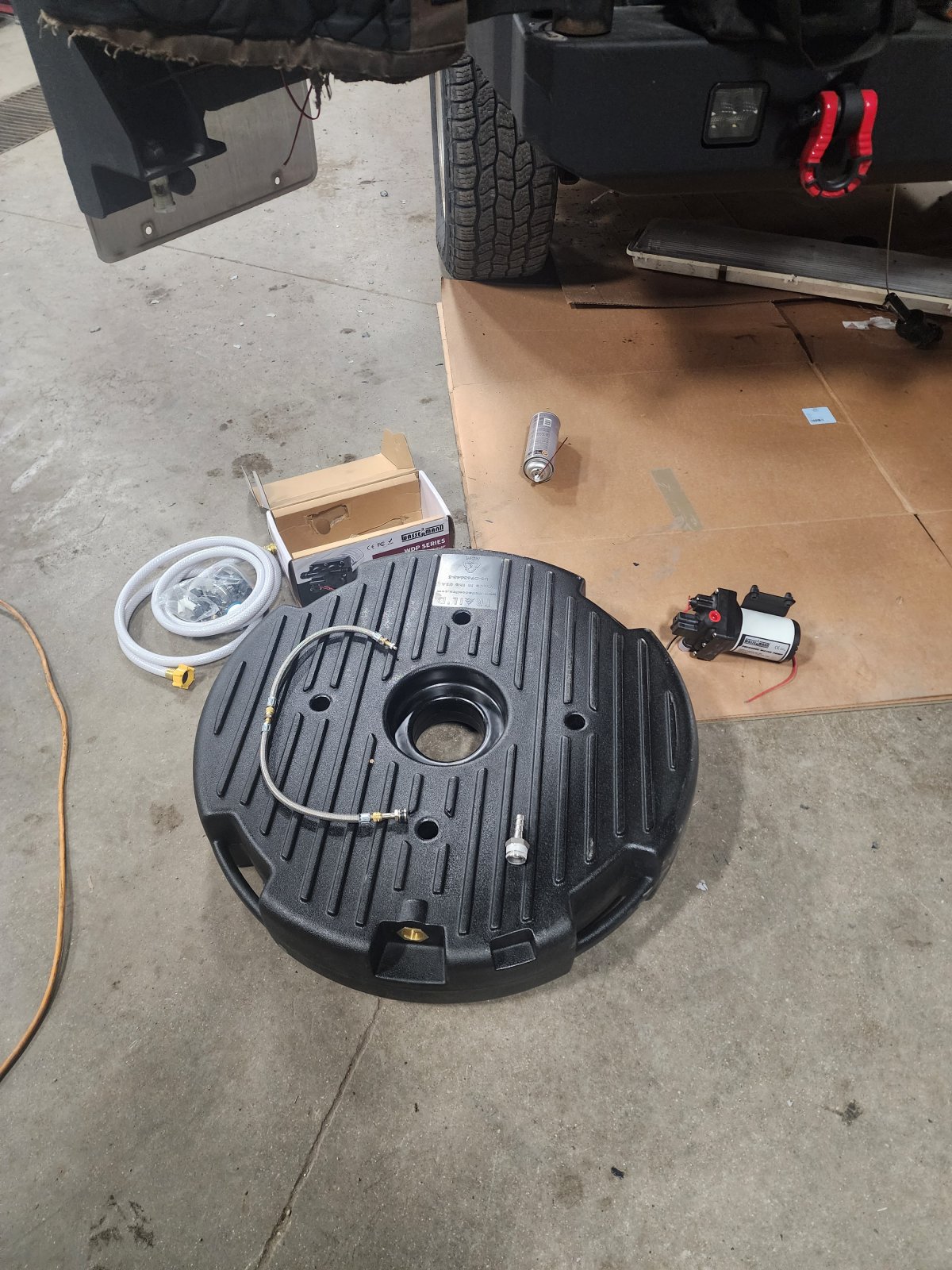

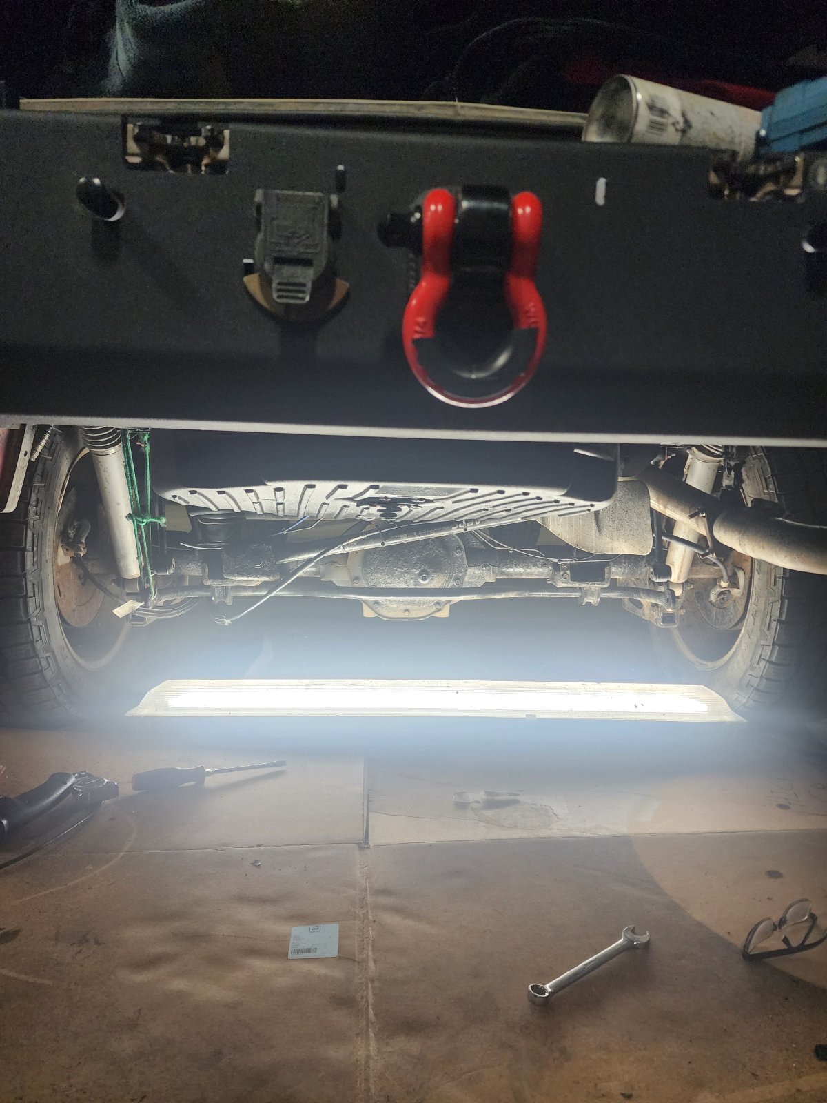

Dirty looks
Dec 5, 2025
140
228

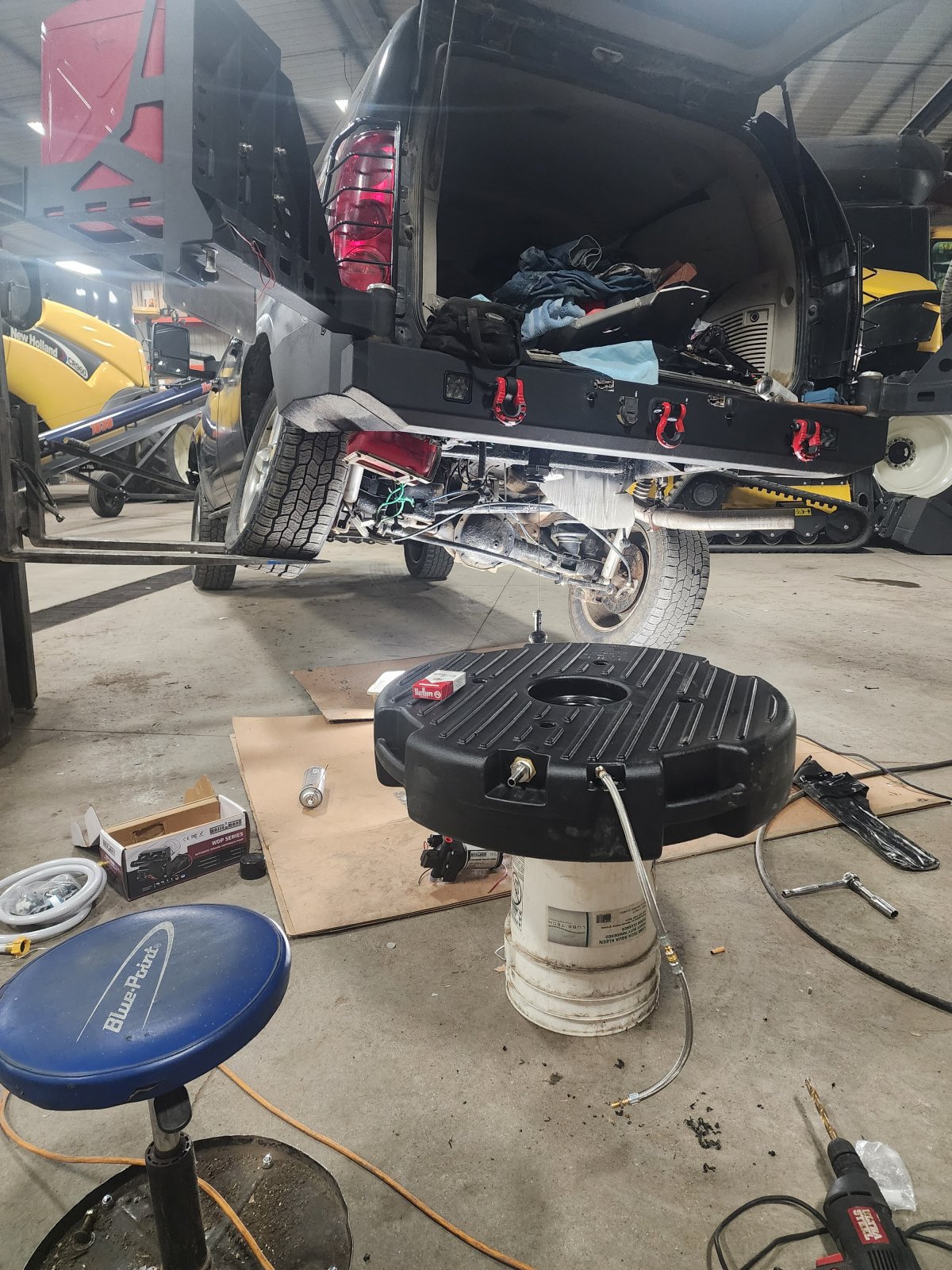

Trail'd. 14 gals. Safe to drink from.
A bit expensive, as everything related to offloading is.

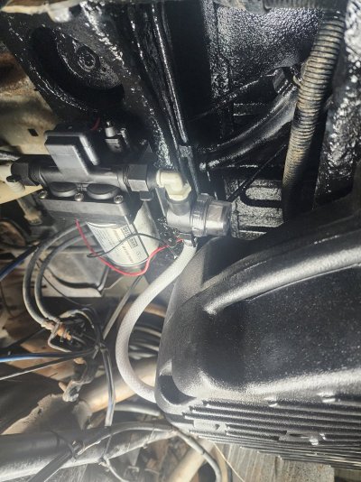

Mounted a pump under there as well.
Open road shower and water heater.
