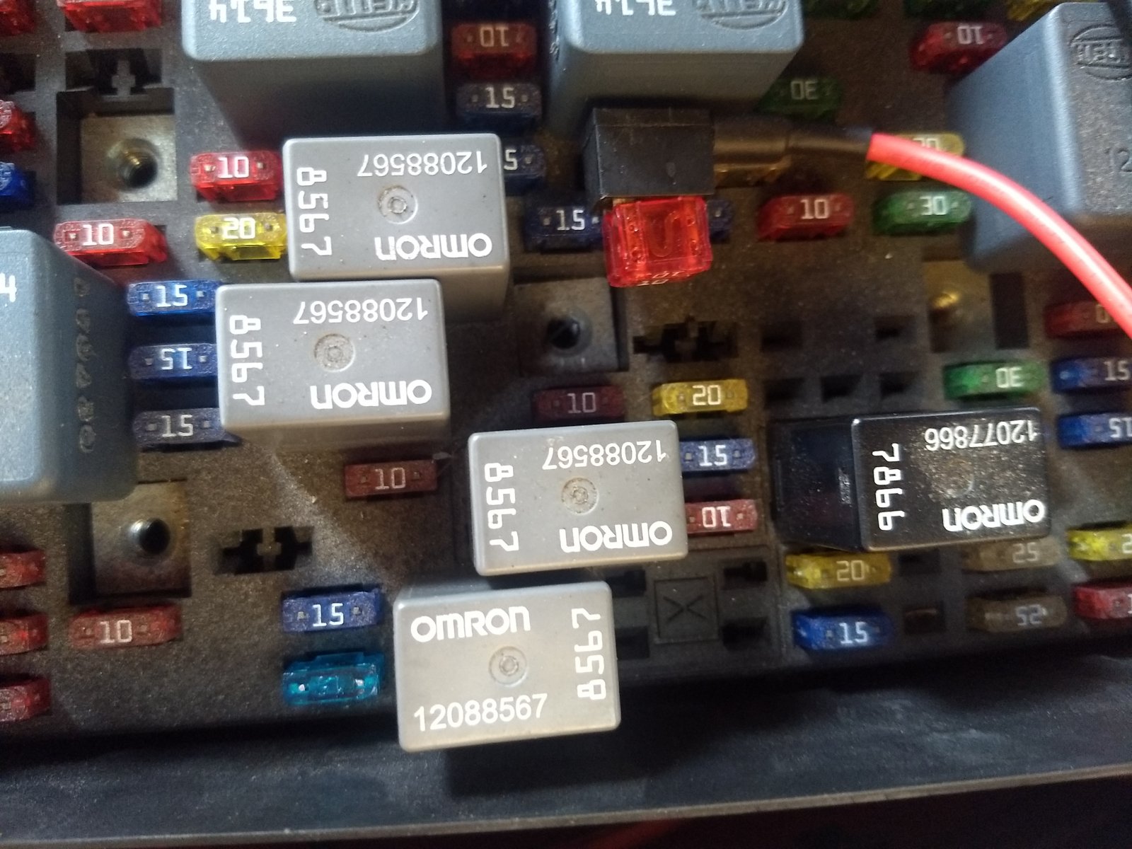

OKay so it turned out it was the fuel pump. So he replaced the the pump and fuel filter. I am going to switch out the fuel pump relay and while i was at it was going to swap out the horn and the ac as well. I noticed all those relays had the same number on them. Does that mean I just order this one for all of them?
posted a pic of the relays moron 8567-12088567
https://www.rockauto.com/en/moreinfo.php?pk=11524593&cc=1371620&jsn=1004
52,956
Who you callin a moron lol.
“posted a pic of the relays moron 8567-12088567”
Anyway yes they’re all the same but why are you replacing them if they’re not bad?

Hey sorry about the moron part lol that was a typo. Just figured better safe then sorry. I know the horn relay needs replacing as well so figured while I'm at it.

@Rocket Man, he is likely doing as I recommended on the fuel pump relay. I always recommend replacing the fuel pump relay with a new fuel pump. It is a habit that I picked up in my shops when I had a vehicle in with low power and was a fuel pump and then was towed in a week later with no power to fuel pump and the fuel pump relay fixed it. I just decided then to always recommend that relay going forward. I never said they had to, it was just a recommendation.
52,956
I have never had a problem with the relays so I was wondering. Replaced two fuel pumps in the last 2 years, the relays are fine. Never heard of them being an issue. They either work or don’t.

Exactly since they are only 6 bucks rather have spares available as well so when one does shit the bed and I'm in the middle of nowhere I can just swap it out.
52,956
I’ve never had one fail. But in the rare case one ever did, say the fuel pump relay quit, I can swap my horn relay in. Or my fog light relay. So you actually do have spares available. There’s several that are the same, and the only necessary one is the fuel pump relay. But they’re not like fuses- they don’t blow if there’s a short. A fuse supplying power to the relay will blow. I mean, if it makes you feel better then by all means replace them. But there’s really no need.
