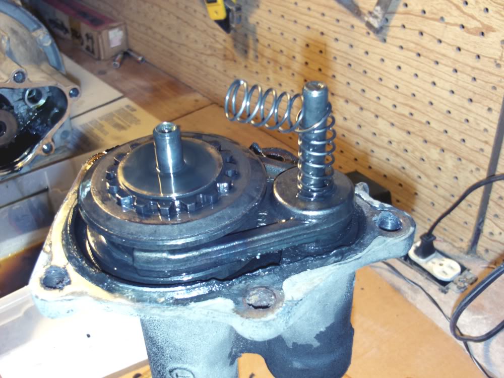

This fuel problem is the biggest one so far but when I got it the 4x4 didn't work. I thought it was the actuator, then I thought it was the t-case, then I thought it was the 4x4 computer. It eventually got to the point where I thought the front diff had no spider gears. So I opened it up and heres what I found:
It looked like it was never opened before so I can only figure it was done at the factory. There's no way the spring can come off unless the axel tube is off.
