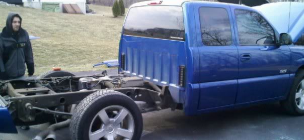

this is how i did my fuel pump on my silverado lol
but with all seriousness i know you cant do that on a tahoe just make sure you have very little gas in it and it shouldnt be hard at all
