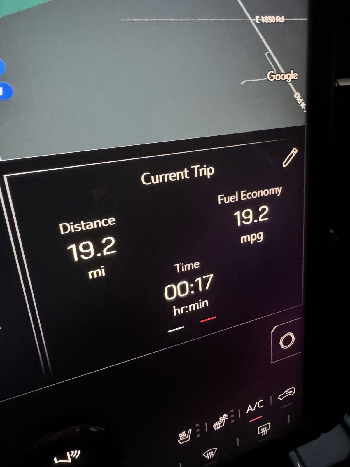

Over the last two highway trips (60 miles round trip), I’ve noticed my fuel economy has tanked dramatically. It was around 26-28, but as you can see in the pictures, it’s dropped down to 19ish.
Any ideas what causes this? Maybe because it’s still new and burning in?
Yes I know my level and bigger tires impact on coming, but not this much. I’m actually getting BETTER economy in city driving 35-50mph speeds).
For this trip example, there was no wind, beautiful morning weather and fairly flat highway stretches.

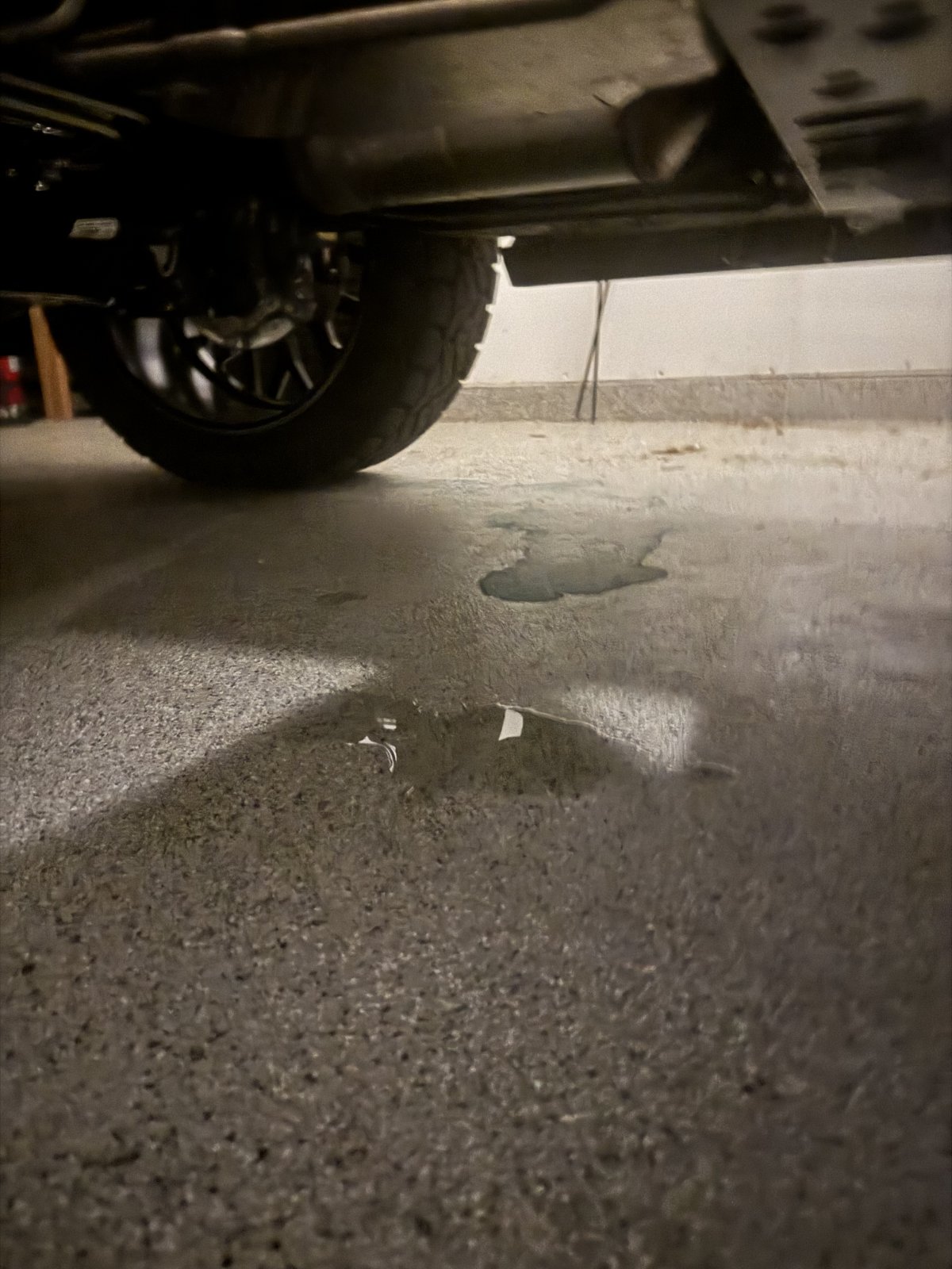

I also did notice one evening my vehicle was dripping something that was falling onto a hot surface - hear the hiss in the third attachment. Edit I can’t get the video to upload, but every 30-45 seconds I would hear a drop then a hiss onto a hot surface.

I wouldn't worry about it. You need to be looking at a bigger average spread like 450 miles. And compare 450 to 450.
Those short trips can be strange. Especially if it regens during the trip will kill short term milage but regains it thru the average.
The water is AC condensate. Normal

Who took the first picture while driving 75 mph?

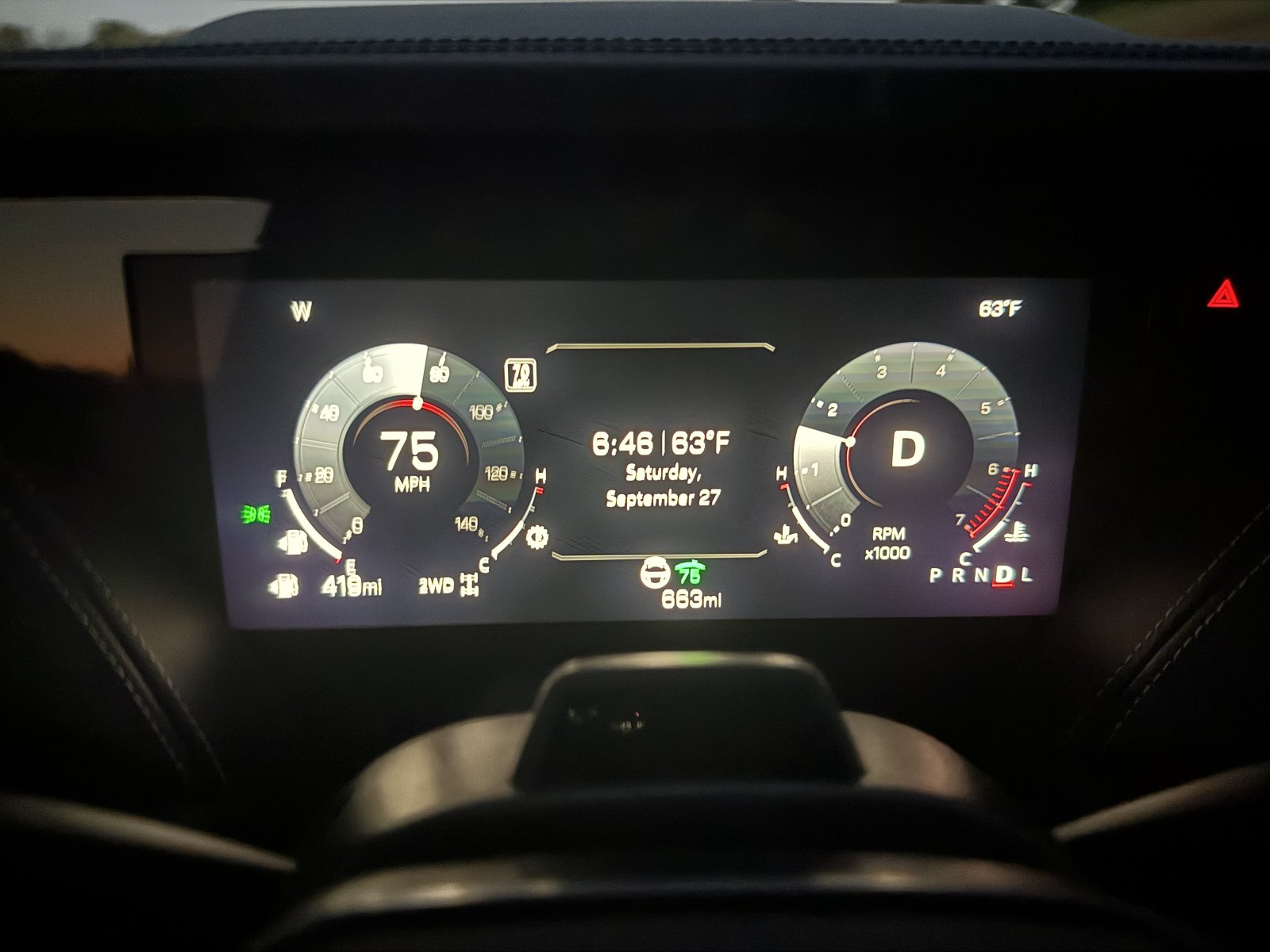

I thought the babymax redlined at 5k not 6.

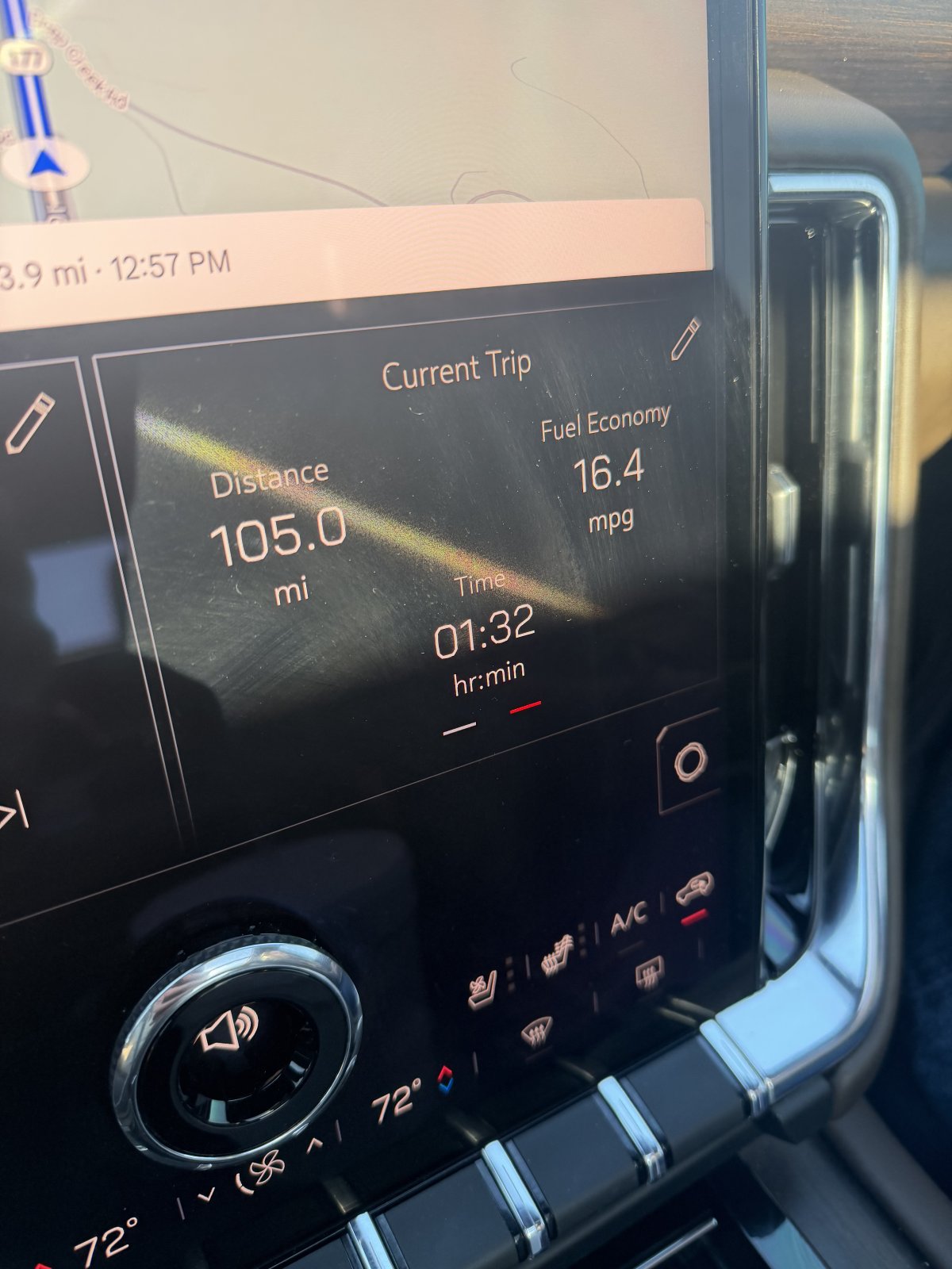

Economy still leaves a lot to be desired at 3,500 miles.
Drove about 600 miles the past several days and haven’t gotten better than 17ish on the highway. Yikes.
Today for example:
- see picture, 100 miles at 70-80 mph
- rpms around 1400-1600
- cruise control on
- no wind, 55 degrees out
BELOW 17 MPG
I do have big 35” nitto grapplers, but no way those should reduce mileage by ~10.
Like I said, yikes.
Safe bet 70-80 is a huge factor. Did you also lift the body?
Which model Grapplers do you have? I assume new wheels also? If so what's the weight of the new wheel and tire compared to the old?
Cold dense air plays a factor.
Larger tires, especially if they have an aggressive tread plays a big part.
All combined it's very likely to hurt your MPG's.
Do you have the original tires and wheels? If so put them back on and do a hundred mile cruise at about 60 miles an hour and see what you get.
My MPGs at 60 MPH is much different than at 80 MPH with my 2012 6.2, 19-20 MPG compared to about 15-16 MPG.

Thanks! I think you nailed it.
The new grapplers. Terra I think?
Had it leveled too.
My mileage around the city suburb streets is like 20

Sounds about right my Yukon took a 10 mpg hit with mickey thompson 35s
